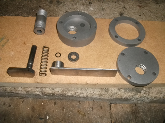

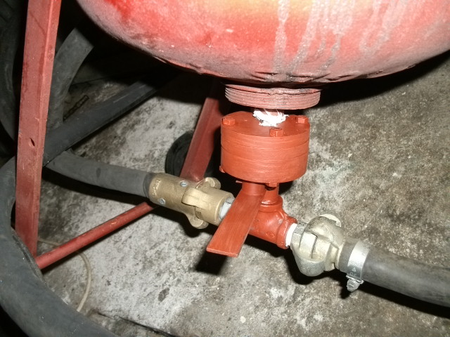

i can blast with media that looks like flour with no problems.
the biggest issue with the stanadrd pot is route the air has to take to get to the nossel and just how crap the std mixer T is.
when i stuck my mixer together i did so that it uses a venturi effect to help pull the grit, and also so there are no magor restrictions to airflow other than the nossel, so all the pressure drop is across the blast nossel so i get maximum avalible power and efficency

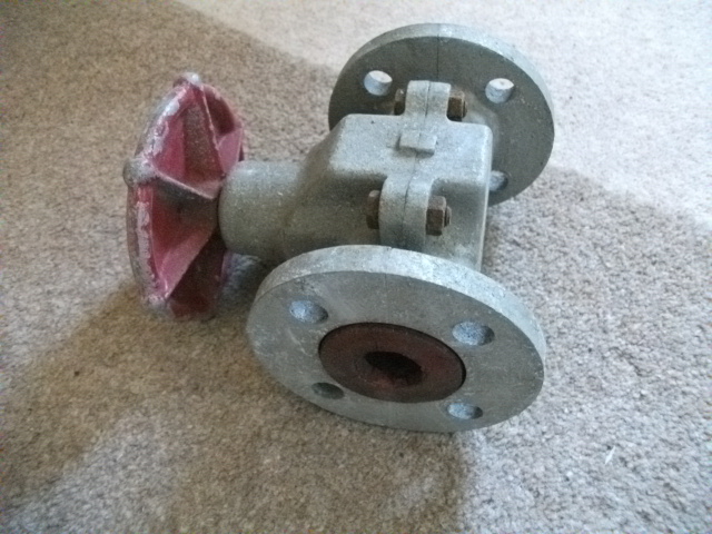

the bore in the rubber sleeve is about an inch in diameter . great if u have a large enough pot .
