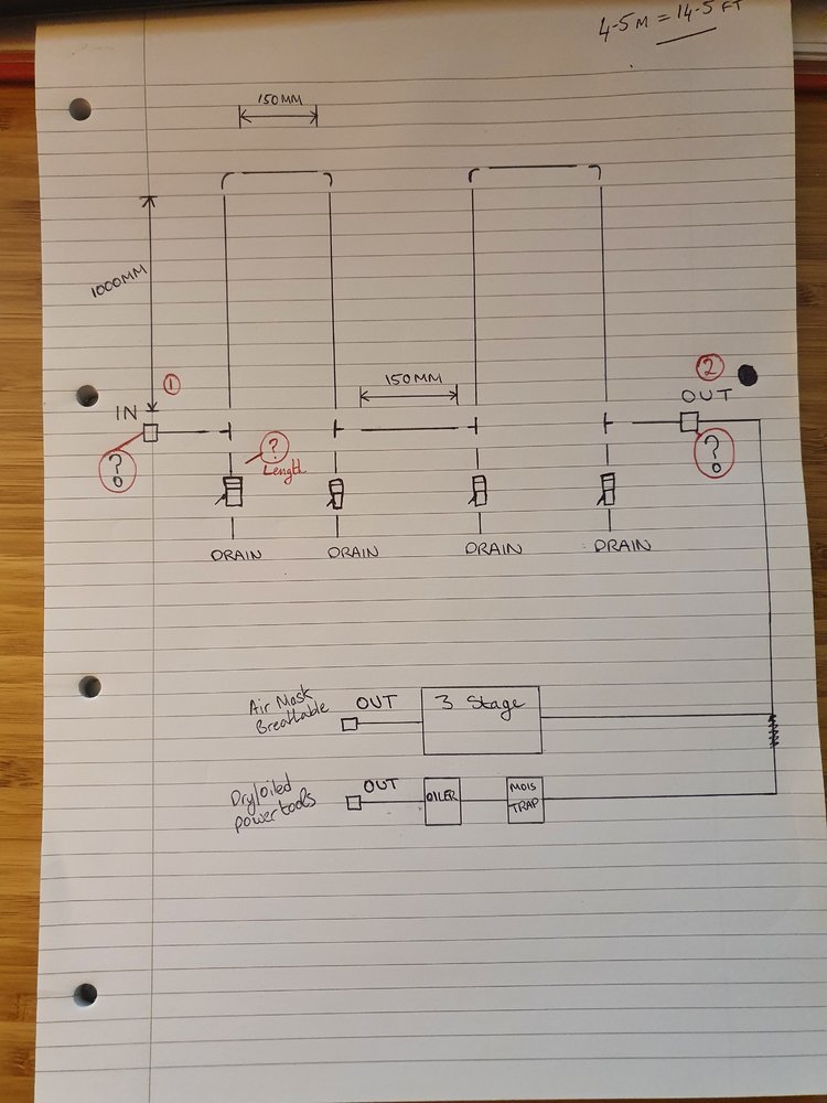

1 micron doesn't make something breathable air. You need to put your air line through a large activated carbon Filter and a particulate filter for that.
I think you might have misread that. I specified 0.01 Micron, which I believe is breathable air.
The three stage air filter I have been referring to cleans the air to this level
It will collect at the lowest point, that’s why several on here have made diy versions with copper pipe with drains at the low pointsWhere does it collect and how do I drain it out? Would it not collect in the coil and be hard to drain?
Hi out of Interest where in your system did you put your pcl dropout please ? I have looked at them on gt air but are £200.15mm copper pipe, modern stuff, is pretty much the same diameter as 1/2" old stuff - the older stuff has thicker walls, but the burst pressure of the modern half hard stuff is way in excess of what your compressor can produce - somewhere above 800 psi.
Out of interest - how much does your pipe, fittings and valves add up to?
Small PCL dropout is £130 on that well known industrial supplies site . . . Amazon.
They claim: The unique design allows it to efficiently remove >99.9999% of liquid water and remove other contaminants down to 1 micron.
I have no complaints about that claim - I have seen no water since fitting it.
Get an auto drain from eBay for your tank. Bit expensive, run on a timer and plug into 240v
I have had no problems with moisture in the airlines since I piped up the whole airline circuit in 25mm , I assumed its down to reduced air speed in the system allowing moisture traps to work rather than air howling through them on smaller pipe.
Also need to be cautious of co and co2 which filters will not remove.
These are created by the compressor getting hot a burning of the oil.
