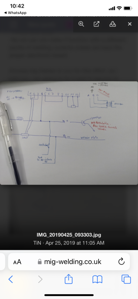

In the partial diagram that you posted on Friday, there is a component marked "X". It has a symbol like a resistor, it is in a high-current path ( thick lines on the diagram ), and it has "thin" wires at each end. I assume it is a current-measuring shunt. It is probable that the control PCB expects to see a voltage ( a few millivolts ) across this shunt, and the PCB then adjusts the phase control firing angle for the thyristors to get the desired current regulation.
When troubleshooting the PCB on your "workbench simulator", have you taken into account the need for feedback from this shunt?
Ok, Great reactivity, Yes sure i am aware about the shunt feedback, i inject 50mA into the pin 2 and 3 of the board and the UA741 starts to give a good response.
About the figure that i posted on last Friday it is a resistor not a shunt, the shunt has 4 connections. when it is covered by a electrical current it gives through the 2 pins the image by mV.

What is the actual problem with your engine-driven welder? Does it always run at full power? Have you checked the power semiconductors ( diodes and thyristors ) in the controlled bridge rectifier for shorts? Do you see gate pulses on the thyristor gates or at the pulse transformer primaries?
The diagram in Post #30 was hand-drawn, presumably from viewing the wiring on the actual machine. If you are comparing it to an official wiring diagram, then it is likely that the published diagram is correct. How does the wiring look on your machine?
Referring to the "3 pins of the TCA785", I assume you mean there is no signal at each of the three TCA785 chips? [Three chips are used to provide 3-phase control.] Do you mean the control input or the pulse output pins?

The situation is this:
