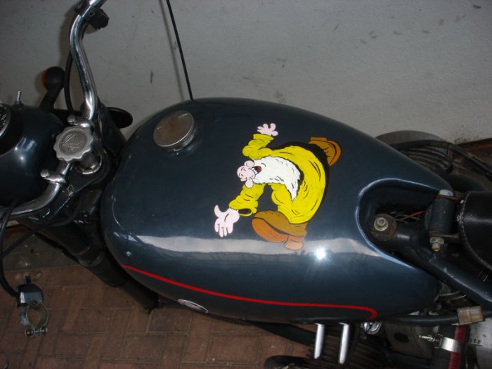

The gear lever on my Ural none Project bike was a piece of junk, so I needed a new one.
Could not find one to fit (for free) so we had to make one.
two M8 nuts locked onto each other on the threaded part of the gearbox shaft, one 13mm spanner and a piece of another lever for the toe piece. Works perfectly.
![ural gear lever.jpg ural gear lever.jpg](https://www.mig-welding.co.uk/forum/data/attachments/19/19506-bb262bf8996720fed465e56759791951.jpg)
genious or what? shame about looking like a cheapskate with a silverloins tool, Snapon would have had so much class on a shed ike this one.
