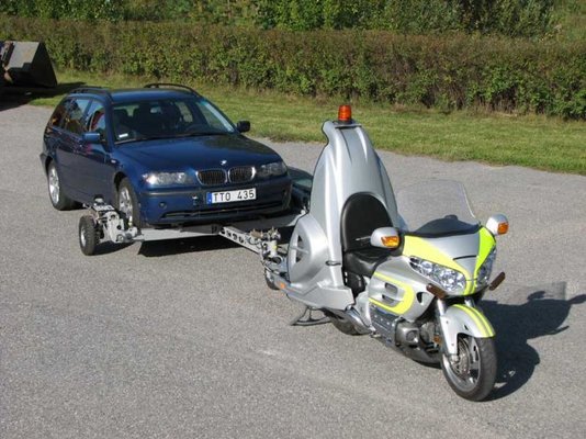

you might want to have a look at the VRS dolly things as used by the AA and RAC for inspiration. obviously for a boke it wouldn't need to be quite so solidly built
Or think outside the square...
Z900 / 1000 / Gpz1100 have pumped lubrication to all the gearbox shaft bearings.
Not to detract from your thread mich and it looks useful, and I get your kit is splash lubed. But Im just glad this discussion came up! Ive seen the dolly's about and on ebay and I too have been toying with making one. But, almost everything I thought of towing like this falls into the above category! Gs's, a gpz11 and others...
Discussions in public are good for everyone's benefit.
4.7 inch from the ground hope you dont come across any speed bumps
Yep, it's here! And its a brilliant design I think. Very minimalistic, light and low, yet high off the ground. Better than mine I have to say... mine weighs a ton!!
