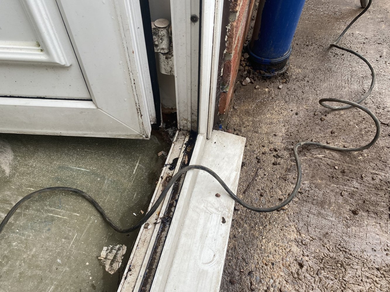

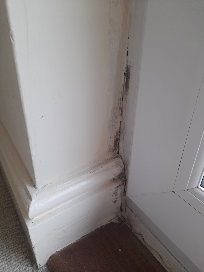

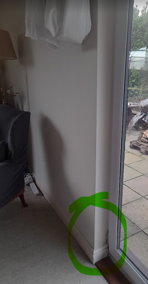

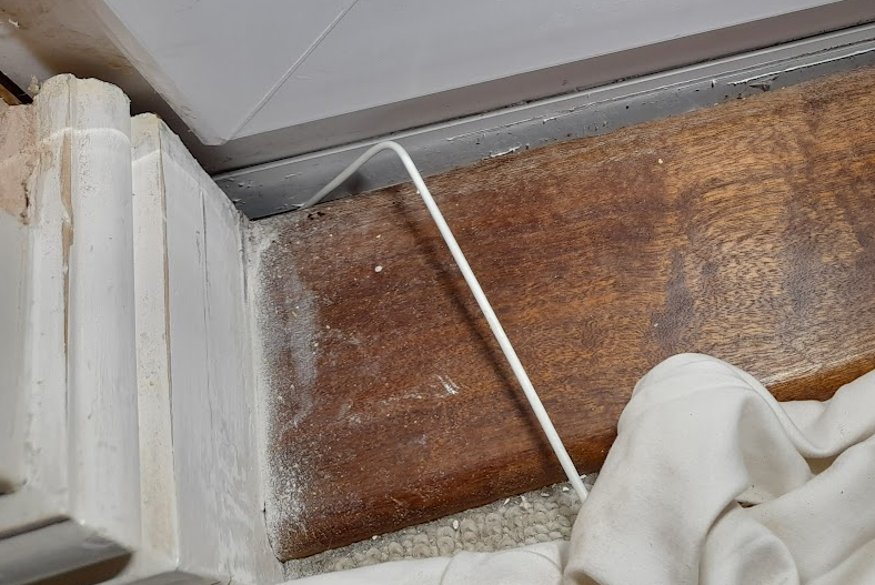

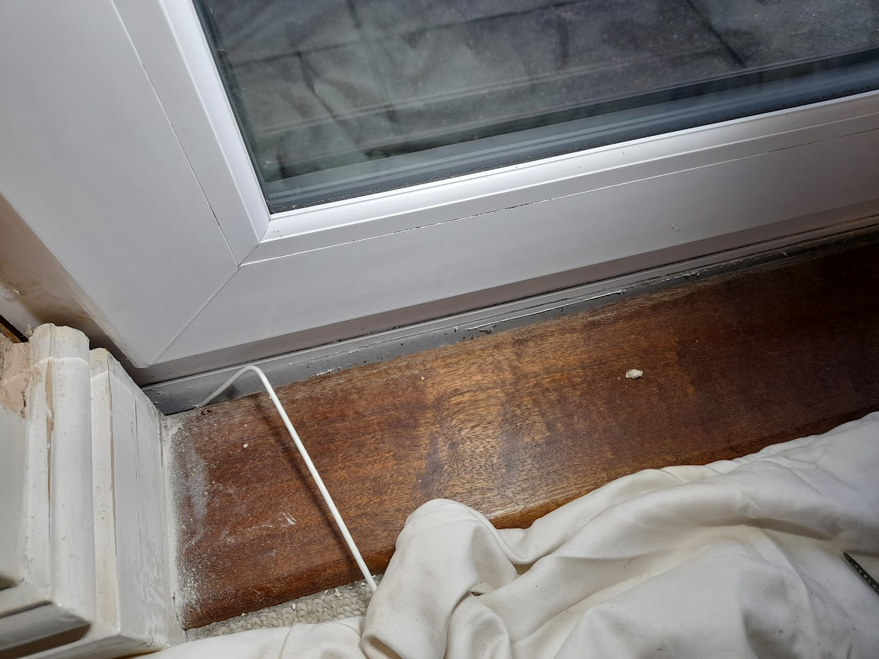

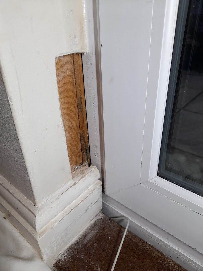

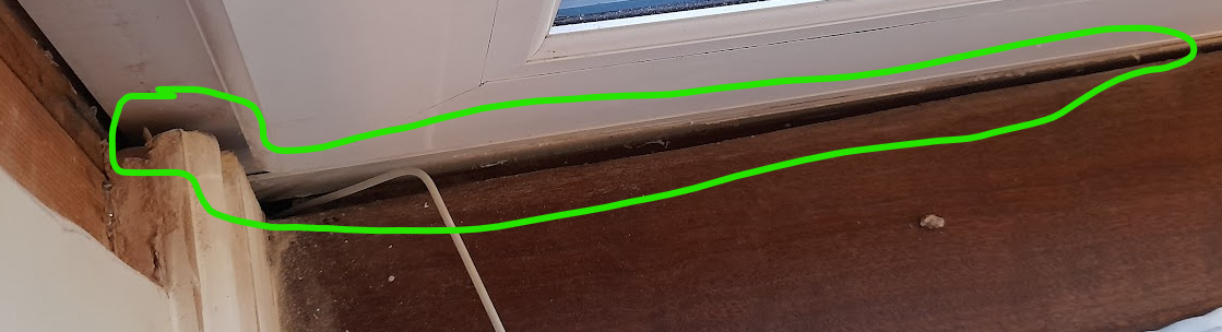

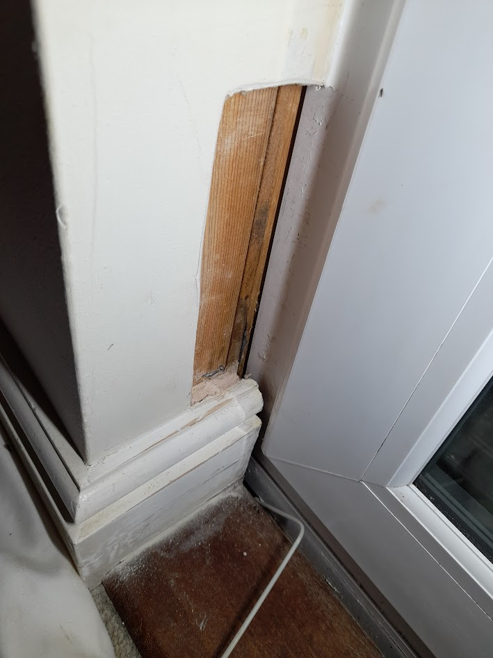

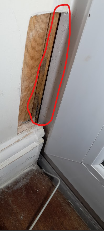

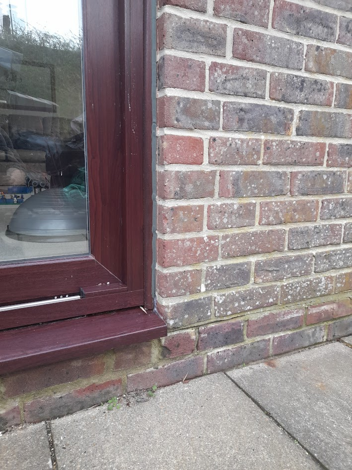

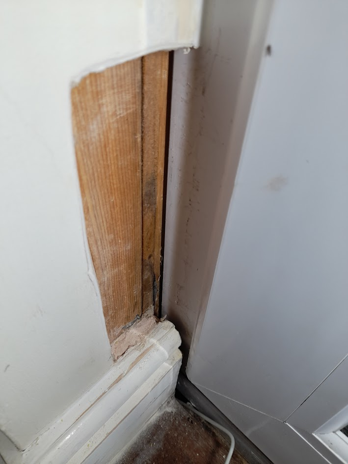

I'm looking for collective opinion on what to do with this problem. If you look at the photos you'll see there is a gap between the UPVC window frame and plasterboard. On windy days there is a significant draught through this gap and as you can see it is prone to developing mould. The wall construction is insulated timber frame with brick cladding.

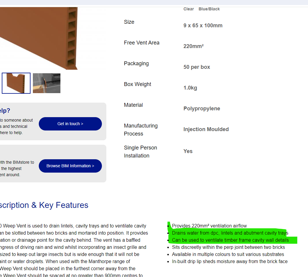

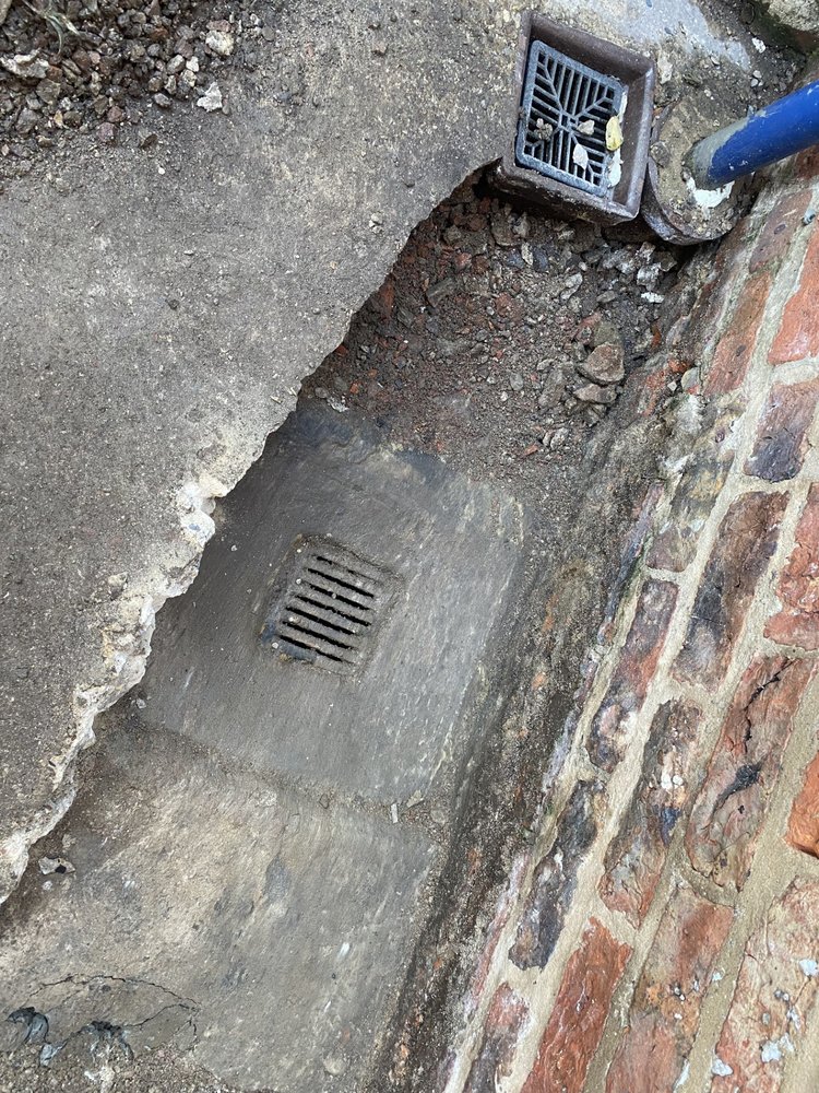

One of the previous owners built the patio level up way too high but I've reduced that to almost 2 bricks below DPC. I would have liked to have gone further but other levels prevented that. Further away from the window it is at least 3 bricks below DPC. I also re-pointed some brickwork around / under the window as it had either crumbled away or was never done properly in the first place. I also added some sealant externally in the hope it would reduce wind / damp air entering the cavity. It does seem drier.
I checked moisture in the plasterboard today (and it has been VERY wet and windy all week) and it seemed good - just 15%
Before filling any gaps with sealant / expanding foam / other suggestions, do you think I should remove some plasterboard to check for more significant problems? e.g. rot in the timber frame. Or should I remove a small square of plasterboard, fill any void behind (with what?) and make good? My past experience of using sealant at this junction has not been good - it has gone mouldy and failed. However, that was prior to reducing the patio height and filling external gaps, so that may have solved a problem. I would not want to completely fill the void between external brick cladding and internal plasterboard as that could act as a bridge for moisture to travel across. So what would be considered best practice?
