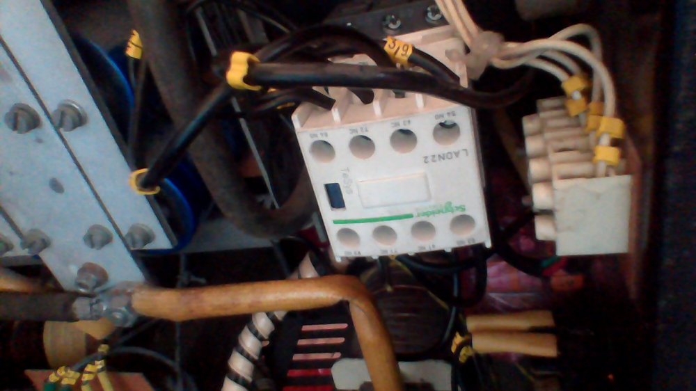

Your list of numbers did not include a 39! (should that have read 29?)yeah cheers mike and cheers to you too @eSCHEn![]()
p.s I've learned that wire numbered 39 is livelol. Checked all the wires with my voltage testing screwdriver thingy Merbob and only 39 lights up (my
maybe) then you should find that two of the wires in your bunch go to each side of this (it's the oblong box to the right on the diagram, other side to the ones labeled 90's. These two wires of the resistor can go into 62 and 72 (does not matter which way round. This resistor shorts out the welding voltage when you release the trigger so that the wire does not stick to job by discharging the capacitor bank.The NC contacts are being used to shunt/short the welding voltage/capacitor charge via a resistor when trigger is released (labeled as 90's on the diagram)On the front of that contactor
NC = Normally closed - IE will let current flow when contactor coil doesn't have power supplied to it (say when the trigger isn't being pulled) - power stops flowing when power supplied to the contactor coil
NO = Normally Open - IE will not let current flow when the contactor coil doesn't have power supplied to it, power only flows when contactor coil is energised
Not 100% sure tbh, Will read the box and see, All I know is that the old geezer at the electrical supply shop said that these replaced them so just took his word for it.Is your new contactor fitted with 24 v coil? if its just standard contactor with 240 v coil it's not gonna work.
