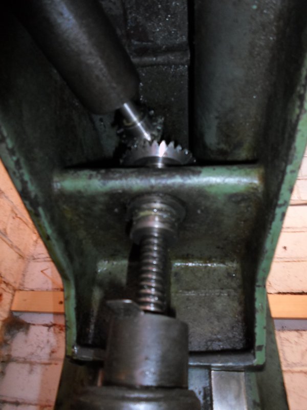

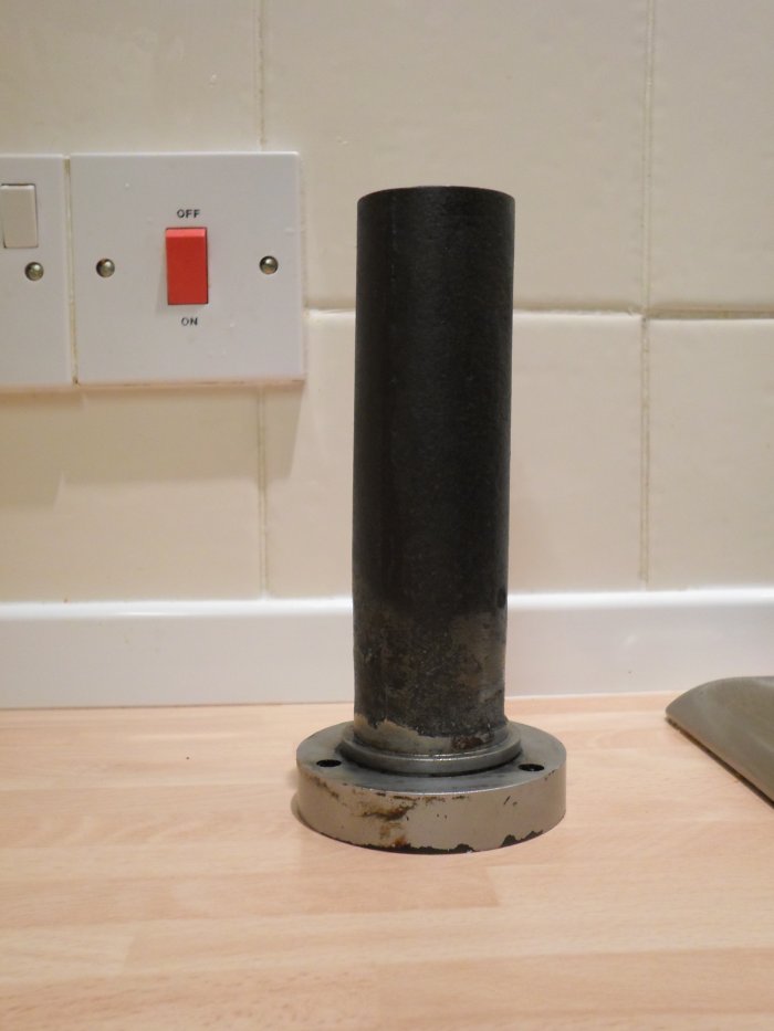

Looking at the first pic, the shaft that holds the pinion looks to be in a collar that does not exit centrally from whatever housing is supporting it. Perhaps that collar is an eccentric adjuster for the gear's backlash?
You have great eyesight
I hadn't really noticed before, so I have just been in the shed to investigate. Indeed it does look like that kind of system. It seems that it may be the outer shaft housing that rotates. I dont know for sure until I look deeper, but it will explain the reason for the damage, and make my life easier when fitting new gears.
I had visons of pinning the gears to the shafts pretty close to where they should be, then shimming them up to the required tolorance.
I shall learn a lot from this build I reckon.

It was indeed a good spot on the eccentric shaft!

I would take that housing and bore it through straight, then add a couple of sleeves to hold the bearings. You could add in a little eccentricity so you have a 3-position backlast adjustment.

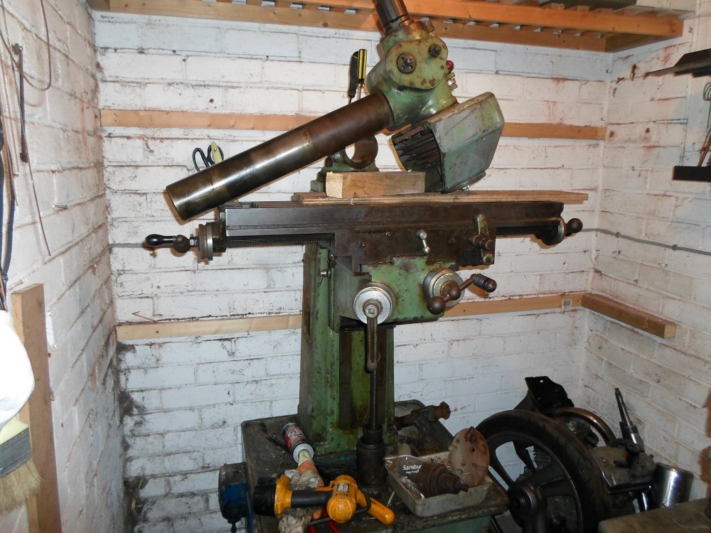

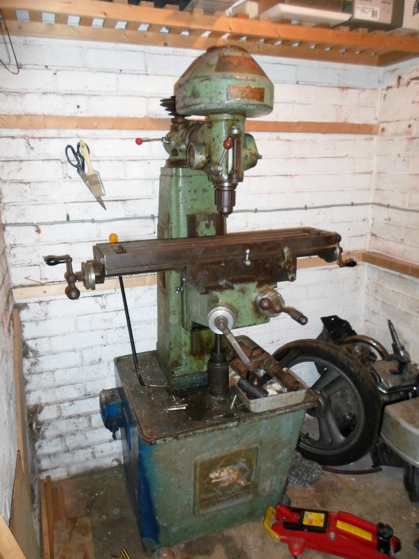

). I think at this point in time, I may put it on a future project list and concentrate getting the mill to a working state

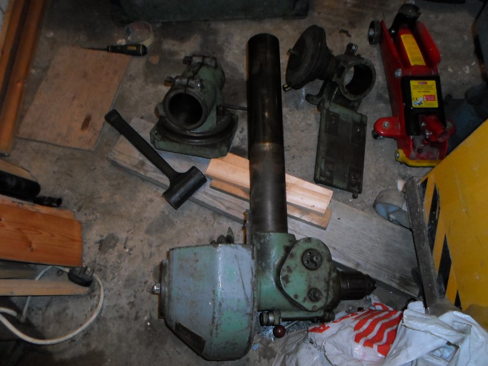

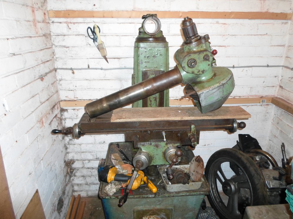

. Today I dsmantled it into bits and it's still a 2 person job to lift!
Nice mill Kev, similar size to the 6x26 I have at home...
It does look to be in that class. Sort of an inbetweeny between an industrial and a hobby machine. Perfect size for a large shed/small workshop.
