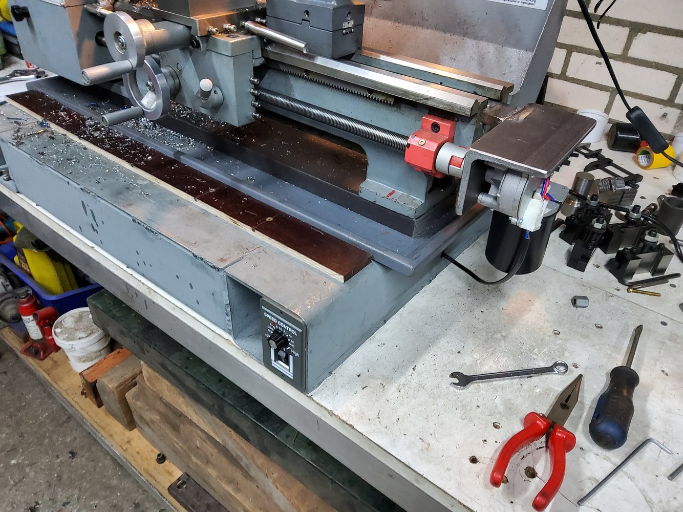

Yes. So slow it appears not to move!I like the direct coupling, the ones on Youtube use a belt drive. Are you able to get a slow enough speed with the direct drive?
I made and fitted a handwheel to mine, but rarely used it, I felt it was too far away! So I haven't missed it really.Missed that post.
I like the simplicity of your setup with minimum material purchase. Plus if it's not slow enough there's no material waste as you can reuse the motor & controller to make a belt drive unit.
I do want to fit a handwheel to the leadscrew to give me depth setting when using the milling slide. I'll have incorporate that in somewhere!

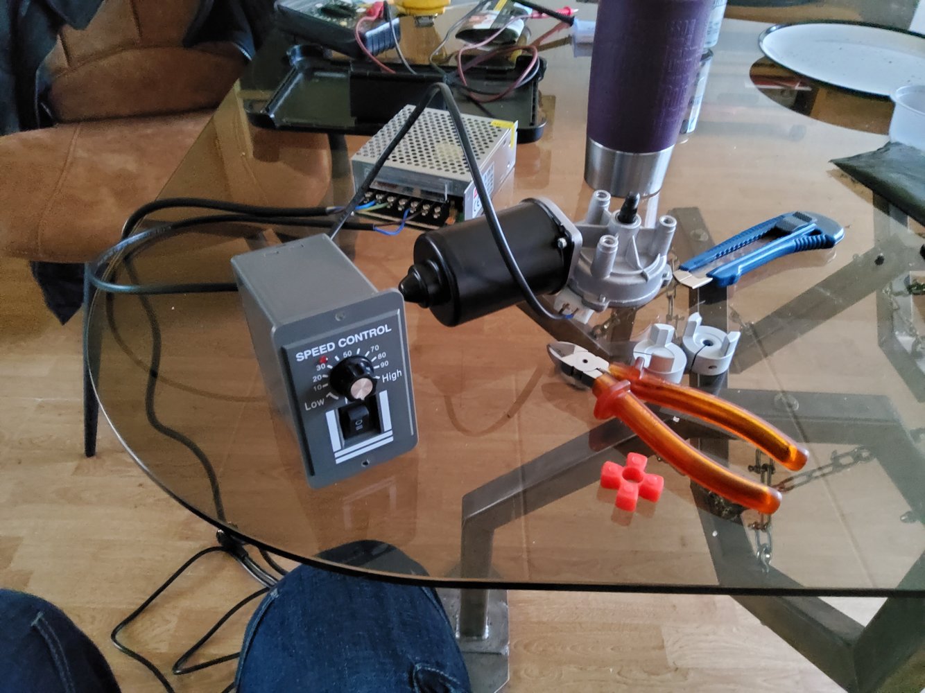

The slowest feed rate on mine is 0.089mm/rev and that is the one I use. But sometimes you want slower and sometimes faster.I absolutely agree with you about changing feed rates on these lathes.

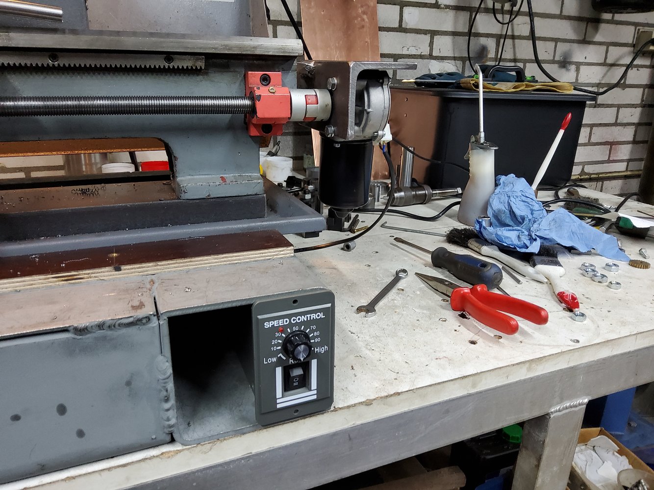

That's why I now have my banjo disconnected and feed the lead screw from the opposite end with a car wiper motor. I can now change the speeds on the fly by turning a knob.
I only use the change gears for screw cutting now.
Its a great mod. Cheap to do and not difficult.
As a bonus the lathe runs much quieter too.
Pls let us know how it goes. I pondered for a while about an e.l.s. but I couldn't get my head around the programming. I cut threads on the lathe mainly with taps and dies for ease. But managed to surprise myself making a one off trapezoidal threaded leadcrew for my mill using single point threading and a hss tool ground by myself!The slowest feed rate on mine is 0.089mm/rev and that is the one I use. But sometimes you want slower and sometimes faster.
When I first had this lathe I tried it for a while with a cordless drill, but it's to hard to keep a steady feed. I did like the reduction in noise though.

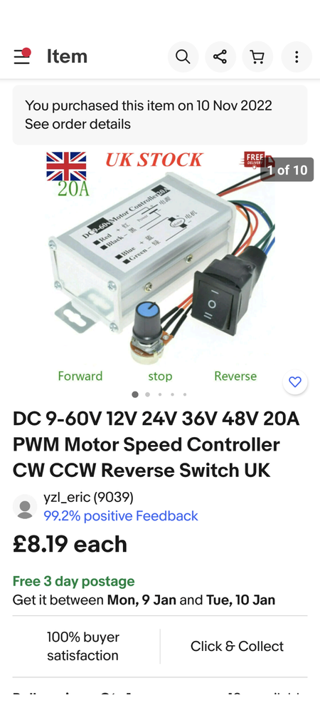

I ordered some parts from amazon today and gonna do what You did. I find it no problem to change gears once in a while for screw cutting so don't need a electronic leadscrew, but changing the feed with a knob would be a nice option to have.
Thanks for the tips.![]()
The parts from Amazon arrived this week and got it mounted.Pls let us know how it goes. I pondered for a while about an e.l.s. but I couldn't get my head around the programming. I cut threads on the lathe mainly with taps and dies for ease. But managed to surprise myself making a one off trapezoidal threaded leadcrew for my mill using single point threading and a hss tool ground by myself!
Very pleased it's worked out for you!The parts from Amazon arrived this week and got it mounted.

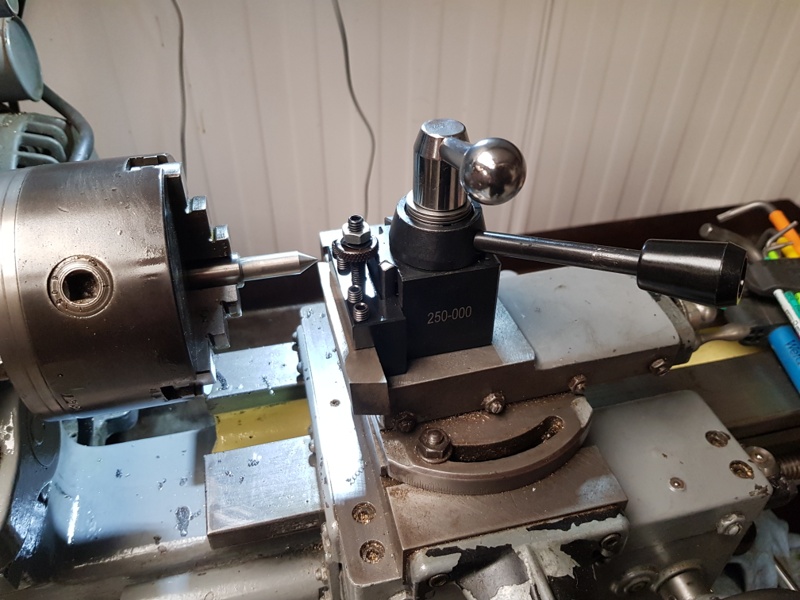

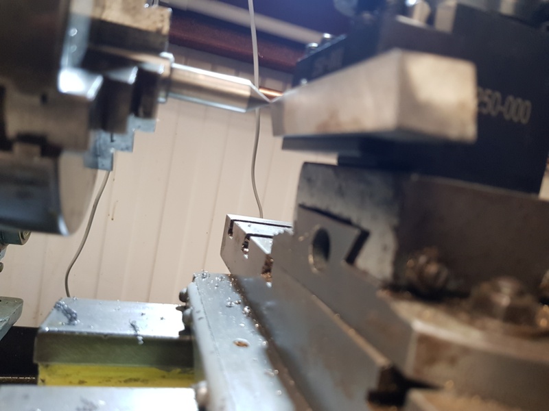

I like it. First test cuts were very promising. Feed can be changed from very slooooooow to too fast.
Thanks for the inspiration @striker.
View attachment 381086 View attachment 381087 View attachment 381088
Yep, the bracket with the change gears is on the shelf with the rest of the change gears.Very pleased it's worked out for you!
It's really simple and cheap, have you disengaged the banjo and change gears? The silence is bliss!

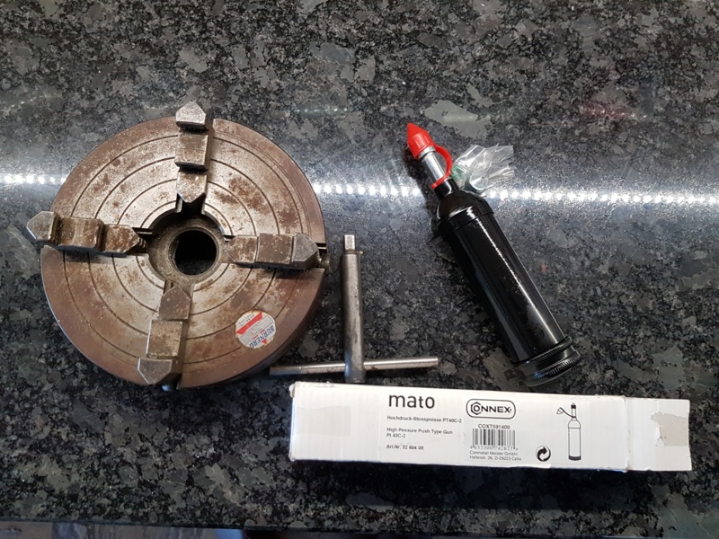

Forget about the oil gun, they are a waste of time! Swap all the oil connectors for 2BA grease nipples, modify a lever grease gun for oil & use that to oil the lathe!
https://www.spridgetguru.com/TA0124.html#
Minimal leaks & will do all nipples except the one for the back gear.
