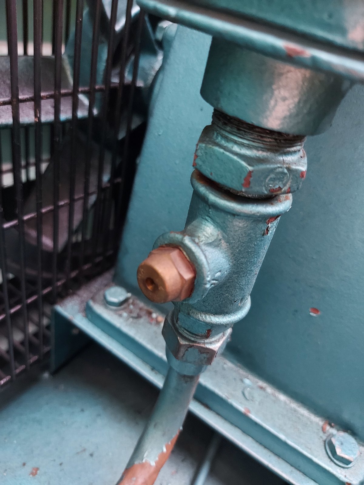

Just checking if my new compressor is working correctly.
So, I did a timed fill from empty to 10 Bar. (coldish today, in an unheated garage).
It took 2 mins and 9 secs = 2.166 mins
Are my calculations correct.
50L x 10 Bar = 500L = 17.66 cubic feet.
17.66 cu feet / 2.166 mins = 8.15 CFM. (would that be FAD?)

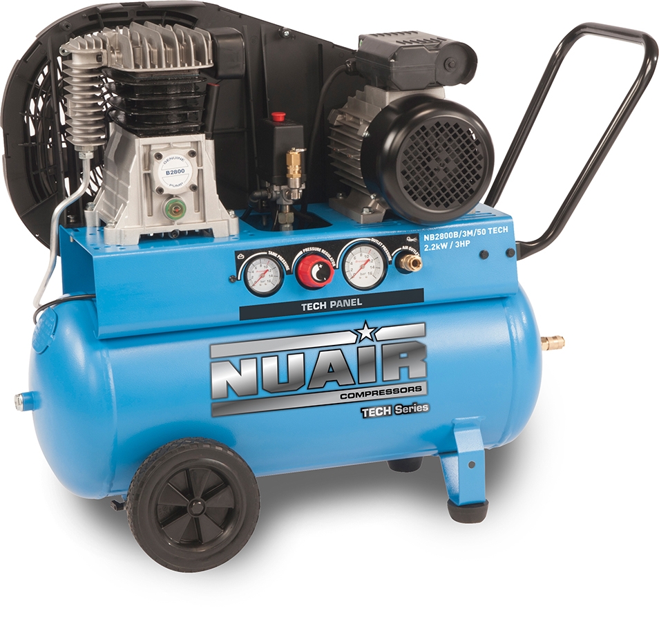

Nuair Spec. Is :
Belt Drive, Dual Piston Pump B2800B @ 1250 rpm.
3 HP Induction Motor 2.2 KW @ 2,850 rpm
76 db.
12 CFM (marketing blurb ) says 12.5 CFM 355 LPM on Tech specs.
People tell me FAD CFM generally equates to 2/3 of Tech Spec, so 12.5 CFM? = 8.33 CFM FAD.
Per Marketing 12 CFM 2/3 = 8 CFM FAD.
Note for the first 14 seconds it is partially venting around the pressure switch thingy, until it reaches 1 or 2 Bar. Then the partial venting stops and allows the pressure to build up more quickly.
I guess it partially vents at the start, to let it have an easy start up, and allow it to run on a 13A plug??
If you knocked 7 seconds off the initial start up time to allow 50% for the partial venting in the first 14 seconds, and therefore assumed it would fill to 10 Bar in 2 mins and 2 seconds; then the estimated FAD would be 8.614 CFM. So better than the spec.
Yes the head does get warm to touch, but definitely not hot.
As a total newbie, I think this all sounds in the right ball park, and the unit is performing as it should?
I am generally pleased with it, especially as it is a lot quieter, than say the direct drive ones. Except When it hits 10 Bar, there is a VERY Loud Hiss as it vents the tube from Pump to Pressure Switch. (Apparently to facilitate an easy startup).
Am I right, that its all working fine?
Only asking as some say their 50L compressors fill in 1.5 mins, but they may have direct drive V configurations running the pump at 2,850 rpm etc.
