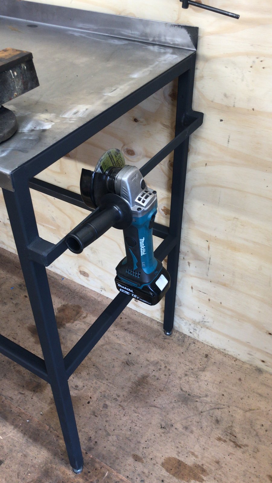

I love my little grinder, I bought this one first which is brushed one, it was £70 I think. I planned on testing it and seeing how good it is, I was going to buy a brushed one but I think they all have the soft start and I really don’t care for soft start function.
I generally only use it for a cutting disk and flap disk. I’m going to buy at least one more, maybe two so I don’t have to switch wheels. I can then get rid of all of my corded ones..

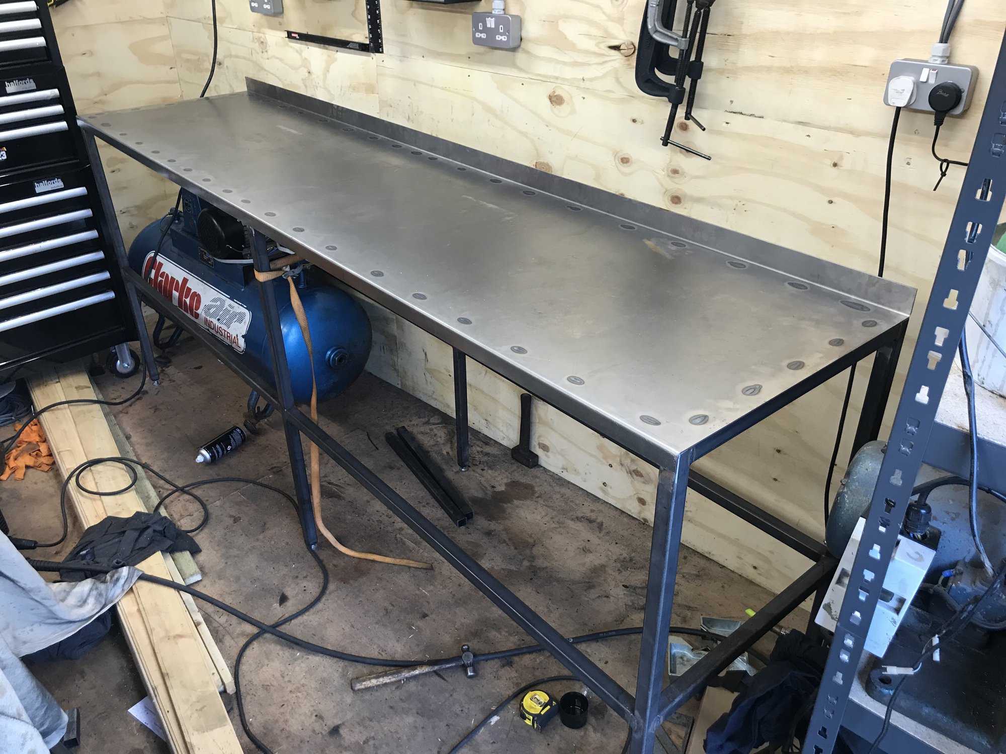

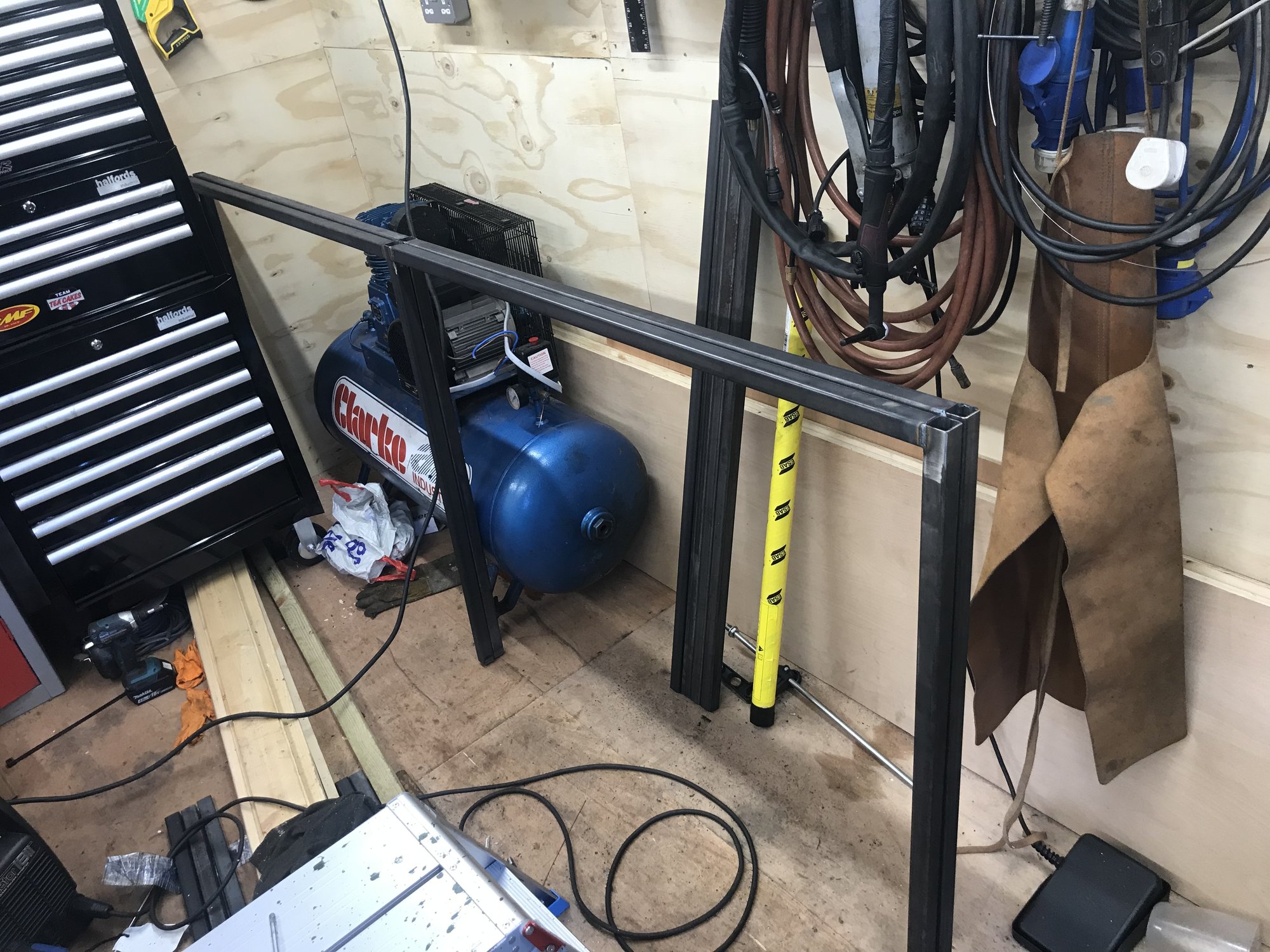

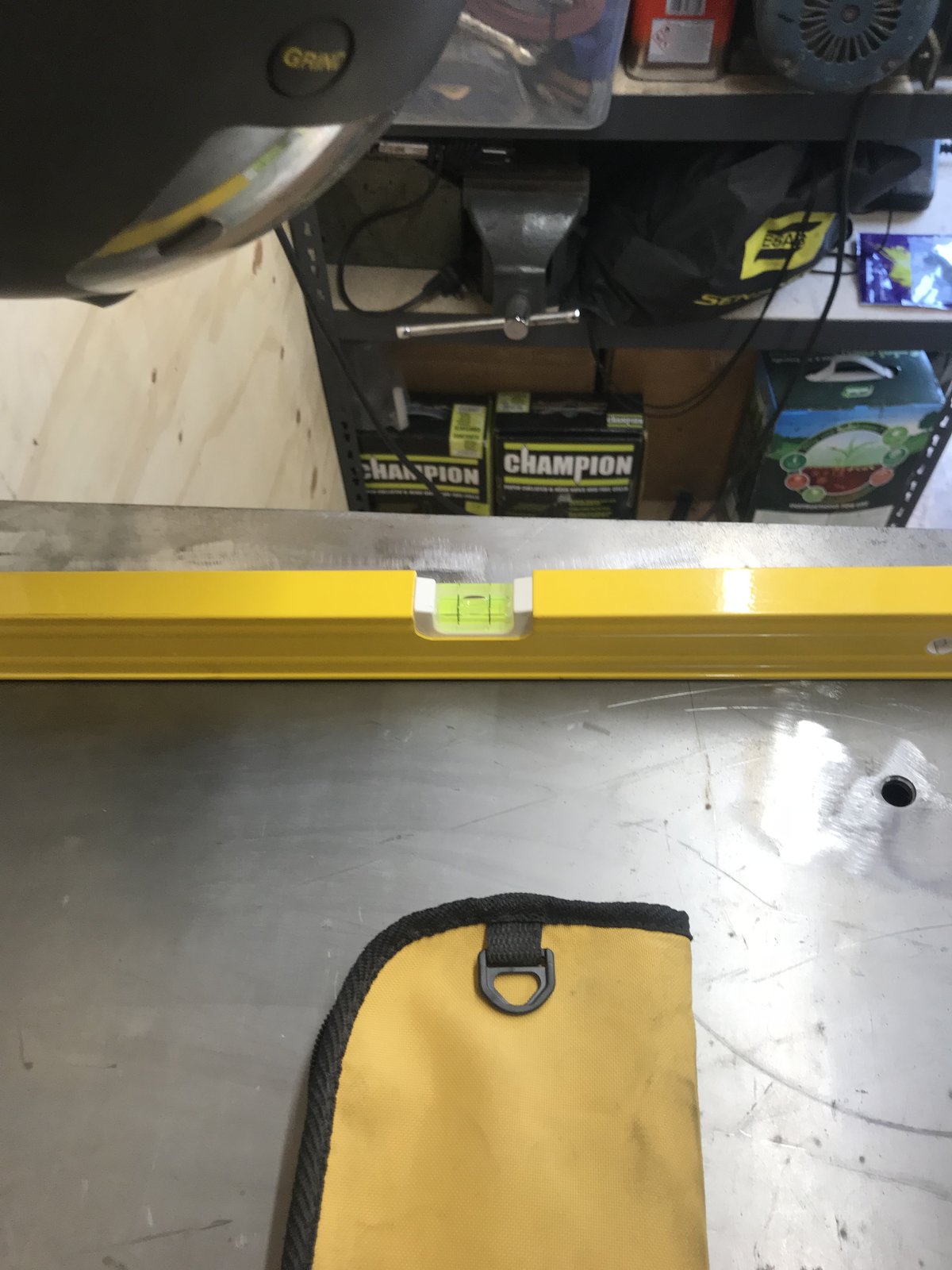

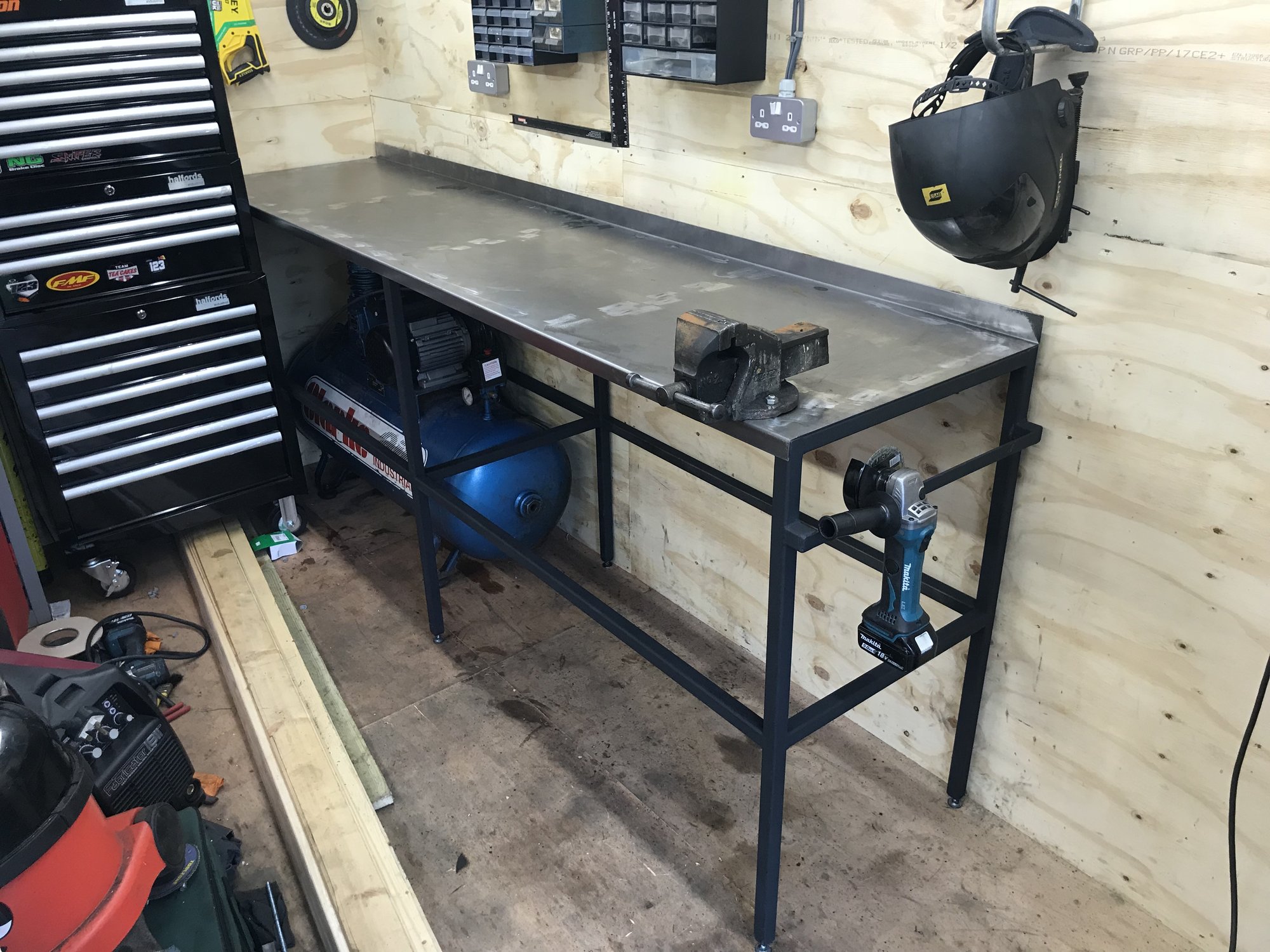

So I have been planning this bench for a little while. I ordered 2.5mm sheet and three lengths of 30mm box.
I didn’t want anything to extreme for the time being, when I do my garage I’ll built something more substantial. For specifically welding.

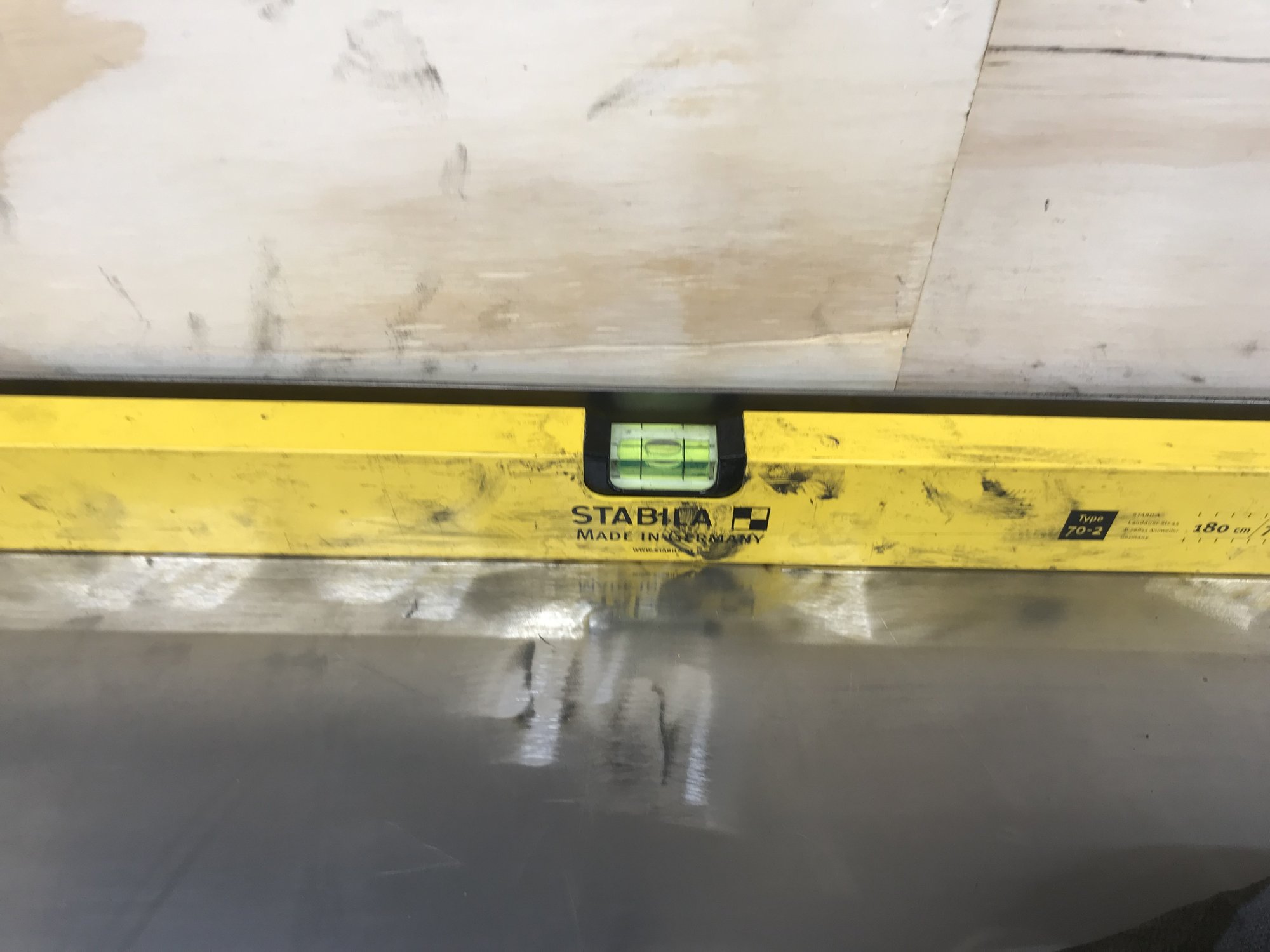

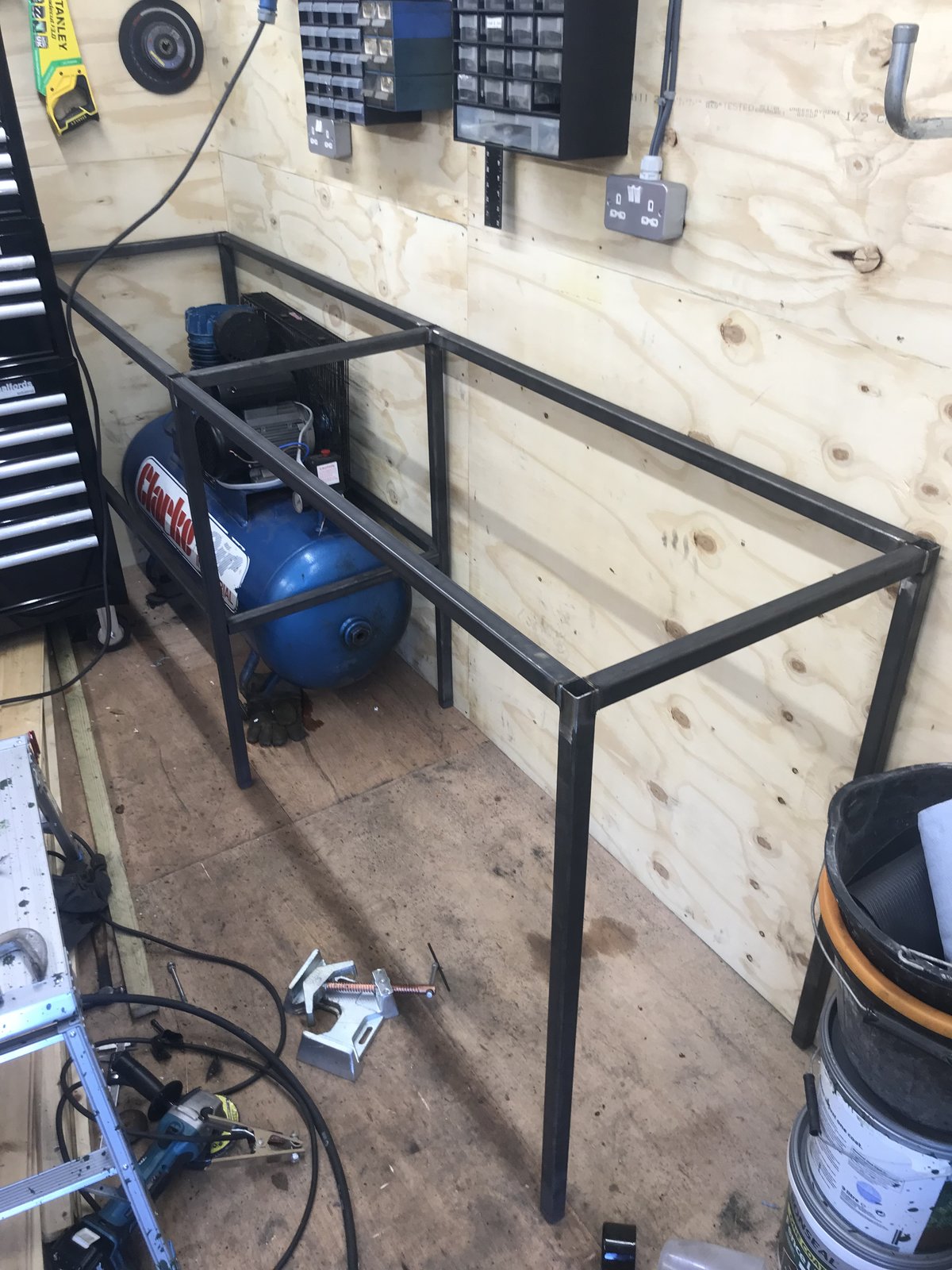

Anyway, so this was such an awkward job. I should’ve done this before moving everything in. I had no room and trying to make something so big square in such a small space was super hard.
As you can all see, I made it so I could level it and take it anywhere I’d like. I made a shelf underneath on the right and will be enclosing the compressor when I get some more wood.
I had the top sheered and folded for £30 at my local fabricators which was a nice touch for the final result. I also gave it a quick once over with some stone chip paint on the whole underside.
I’m going to buy a scotch pad disk and clean the top. Any idea what I can use to stop the top rusting?

my brushless version has no soft start and is lovely to use I don’t like soft start meself

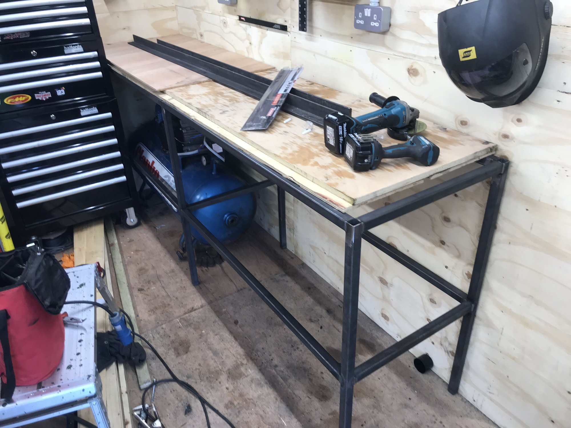

No the ply was just to move it off the floor. It is just the frame with 2.5mm folded sheet welded all the way round.Nice work, looks similar to one I inherited from the in-laws, galv sheet over a 2" angle frame. Is the plywood in the second pic still in place under the steel sheet? Mine has nothing underneath the top apart from a brace half way and won't take much abuse as a result.
I have a similar project coming up, you can never have too much bench space. Only mine will need adjustable feet as the floor is all wonky.
The bench slides to the right exposing the whole thing which is nice and easyNice work, Kim. I think having the compressor tucked away in there makes it too inaccessible should you ever need to replace parts, or even the whole unit - but hopefully experience in use will prove me wrong.
I’ll take another look at the brushless ones then. See if I can get one maybe.

I really wouldn’t get hung up on whether the bench is going to develop surface rust.
Just use it. Your gonna be brightening it up frequently every time you linish off the spatter.
I assume this is gonna be a welding bench Kim? You don’t wanna be covering it in oils and coatings you want to be getting a nice circuit through it with the work return.
People oiling up their benches clearly ain’t using them enough.
