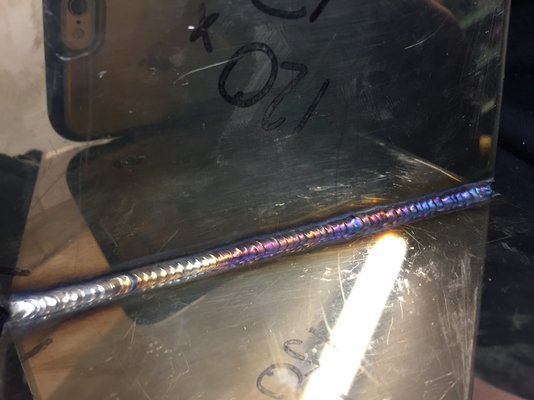

Oh dear. Did you bend em Brad.Small job making some brackets from some left over material. Not that happy with how they came out overall. The welds came out ok. It's some sort of polished gold heat coloured stainless on one side and as a result I think the oxide layer must be thicker from the heat colouring as it didn't pool as expected meaning I had to put a bit more heat in to get the puddle to flow along the joint nicely.
Should have wire brushed it.
Also should have jigged it up better and had the airline at hand to air quench it.
Not ****** bent but not square either.Oh dear. Did you bend em Brad.
Ha ha ha.Not ****** bent but not square either.
