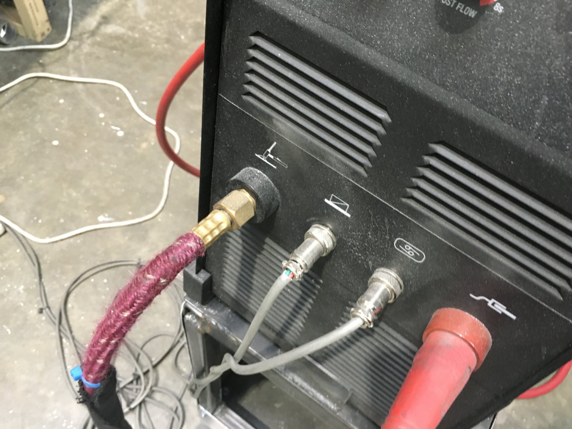

My WP17 has just died on my Eastwood Tig 200.
Im looking to upgrade the torch and possibly do Watercoolered (DIY)
I have a £100 to spend. Absolute Maximum!
If the recommendation is not a WP17, i need to factor in a Stubby Gas Lens in there as well.
If watercooling is out the question. a Decent Torch will have to suffice for a few months until i can afford to upgrade once again.

The only thing I find strange about your cooler optima is you have piped it up so that it draws the water from the tank through the exchanger.thats my cheap cooler, but Im only a hobbyist, as I've only used it for 2 to 3 hours since I built it. If you're welding up to 6 hours a day, I'd be looking at something of a more professional standard, like the ones Richard has built.
http://www.mig-welding.co.uk/forum/threads/diy-welding-cooler-mk3.58247/
Can't see why that is an issue but I've always routed my return hose to feed the exchanger the warm water before it goes in the tank.
