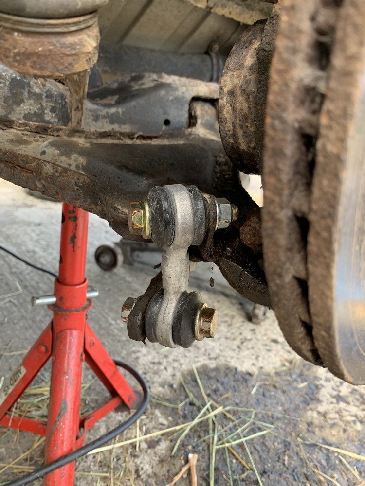

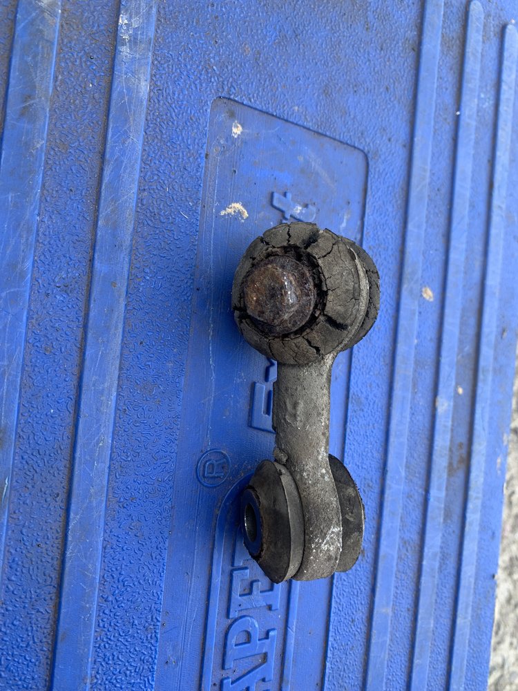

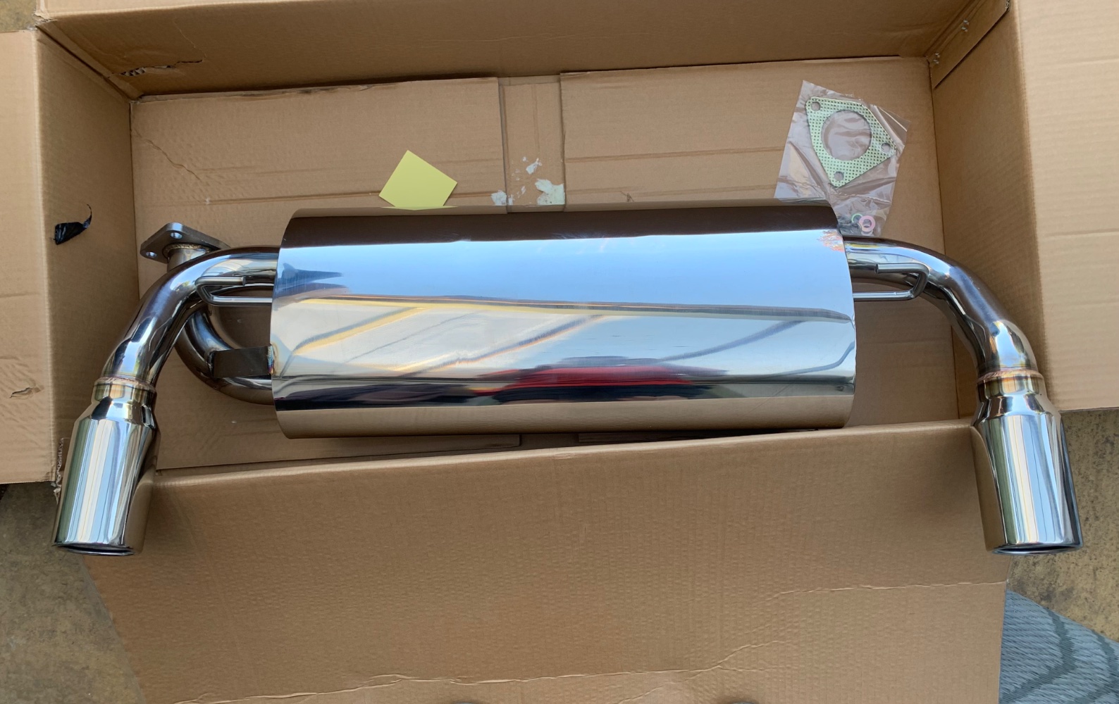

Changed lots of rusty, shrunken-headed old bolts and screws for shiny new ones, replaced the NSR brake pipe, did a full brake fluid flush, changed the perished anti-roll bar drop links and undid the perished front subframe rearmost mounts ready to be changed tomorrow.
View attachment 406197View attachment 406198
There’s a bank between my drive and the field behind our house, one of my neighbours went down our access lane with his tractor and cut it. Sodding wind is blowing it all onto my drivewayWheres the straw come from?

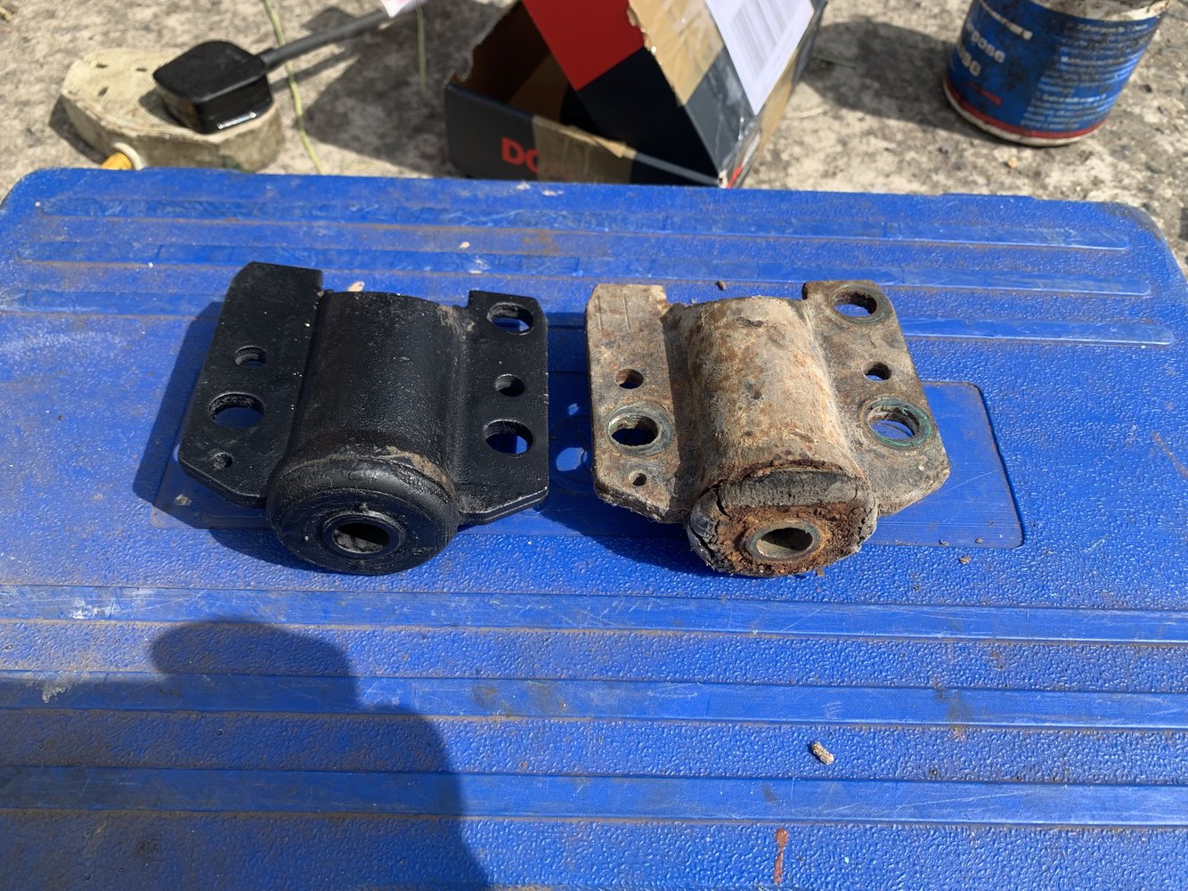

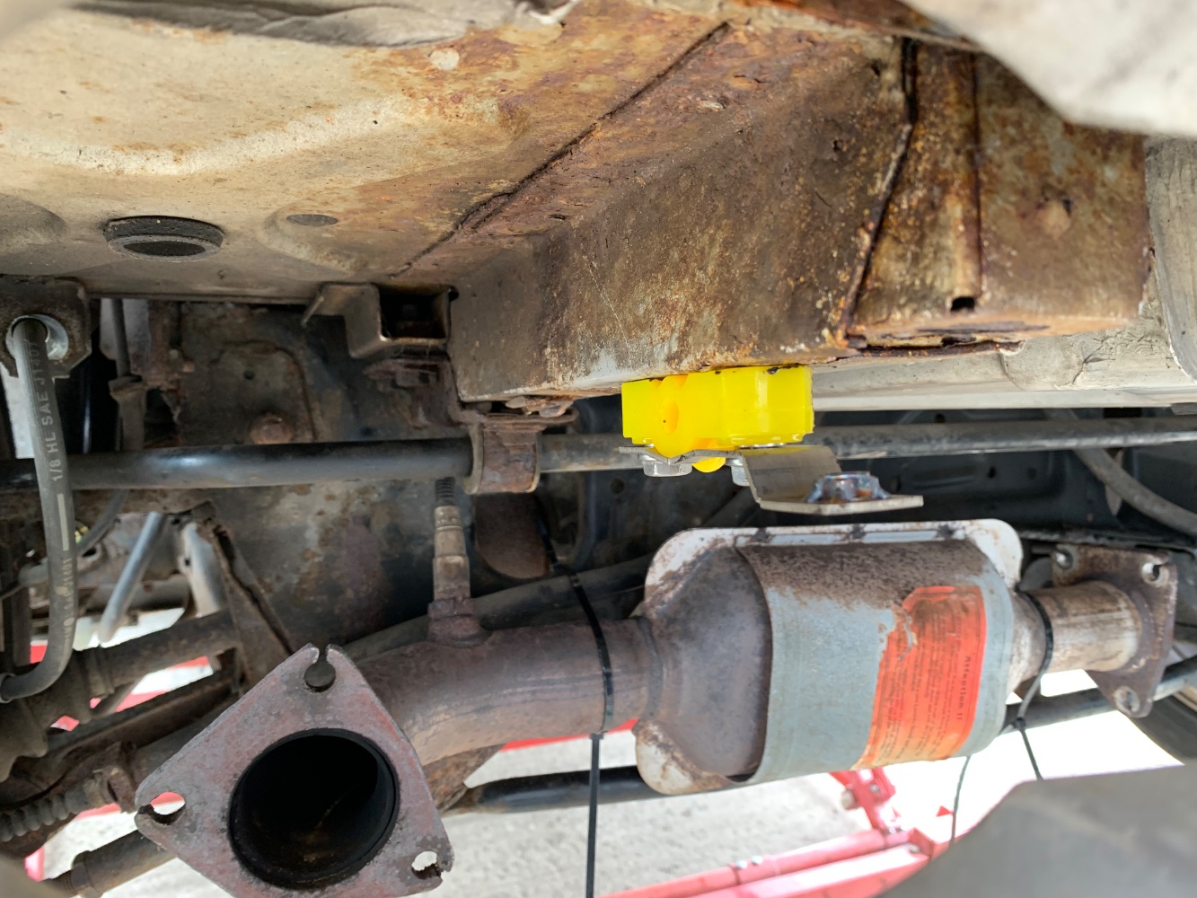

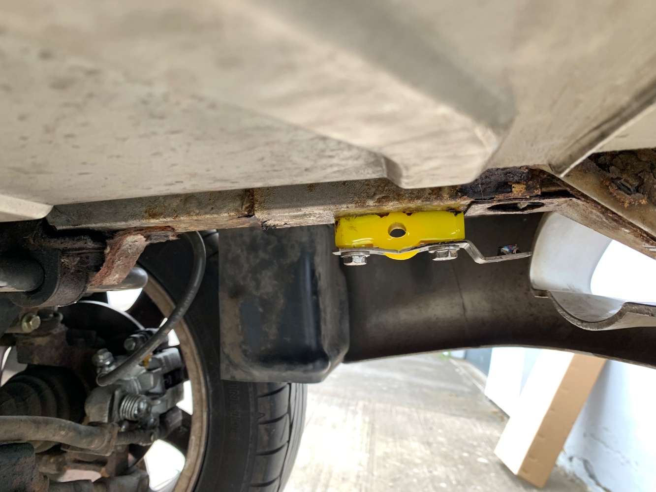

The TF went to solid mounts..New subframe mounts fitted plus drilled out and replaced a broken screw holding the front mount on which appears to have been missed on the mot.
Other than being perished, the mounts were still intact so they may have been ok but I decided for what they cost I may as well replace them.
