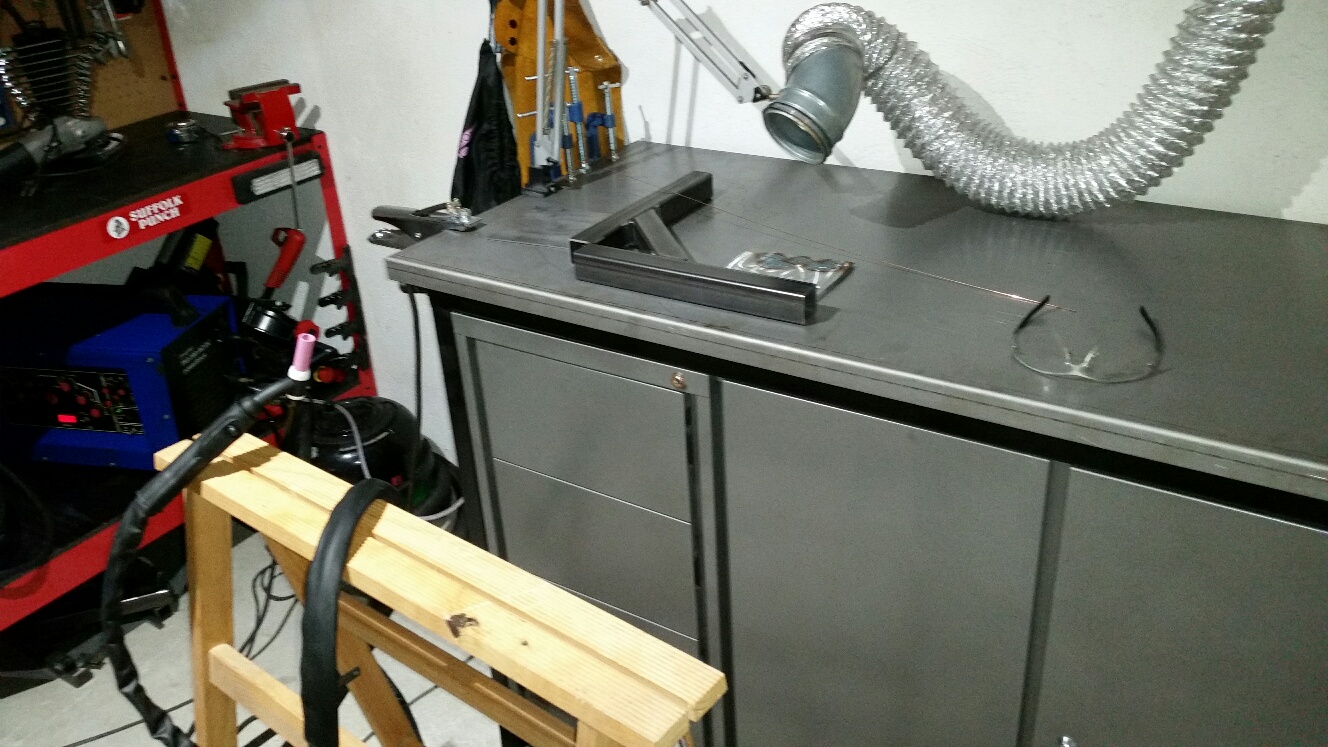

Well do you have any metal?
Have you connected everything up?

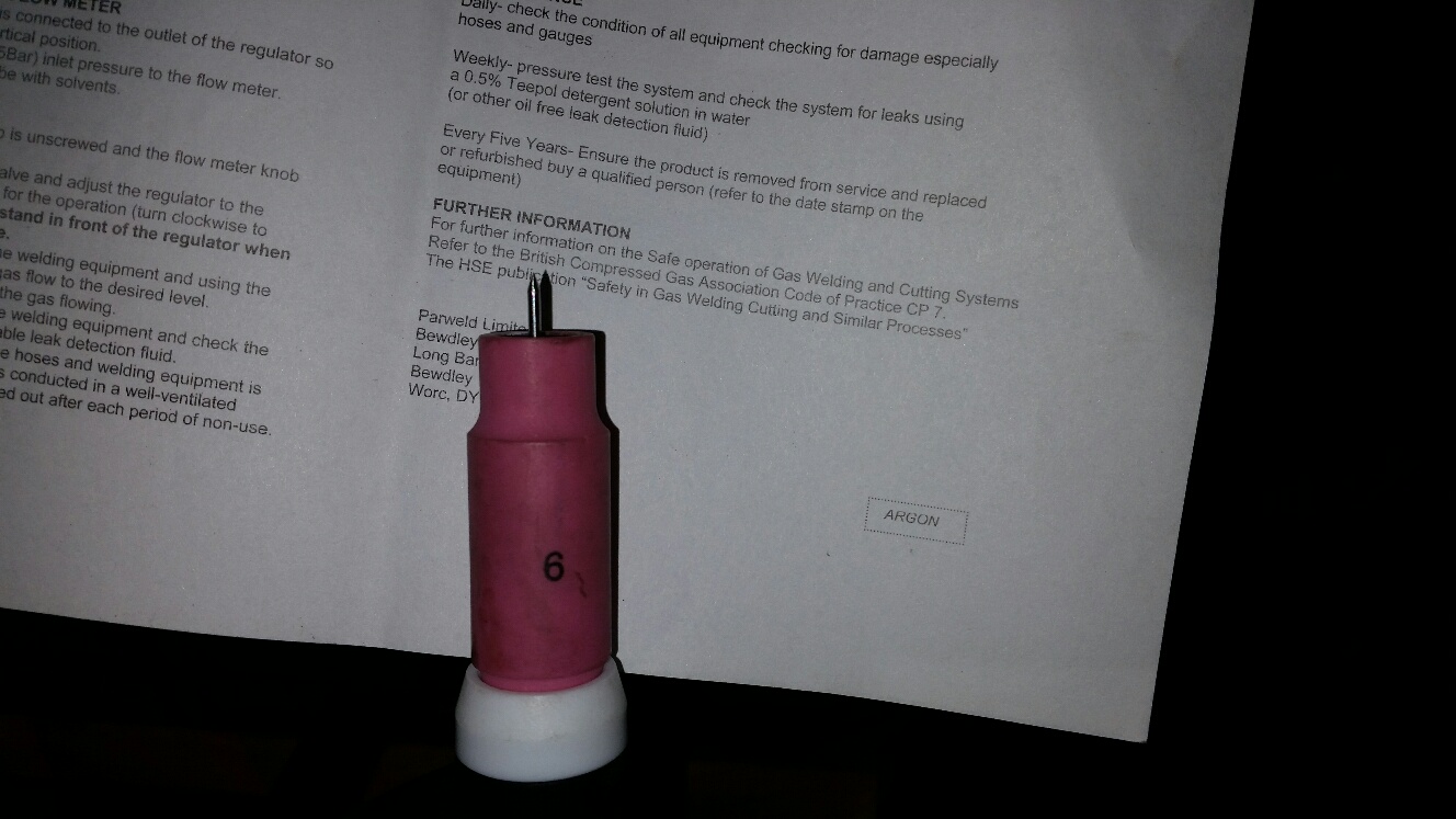

1st off press the torch switch and make sure you have gas and Hf (on Hf start mode) if you hear clicks and buzzes this is a good sign.

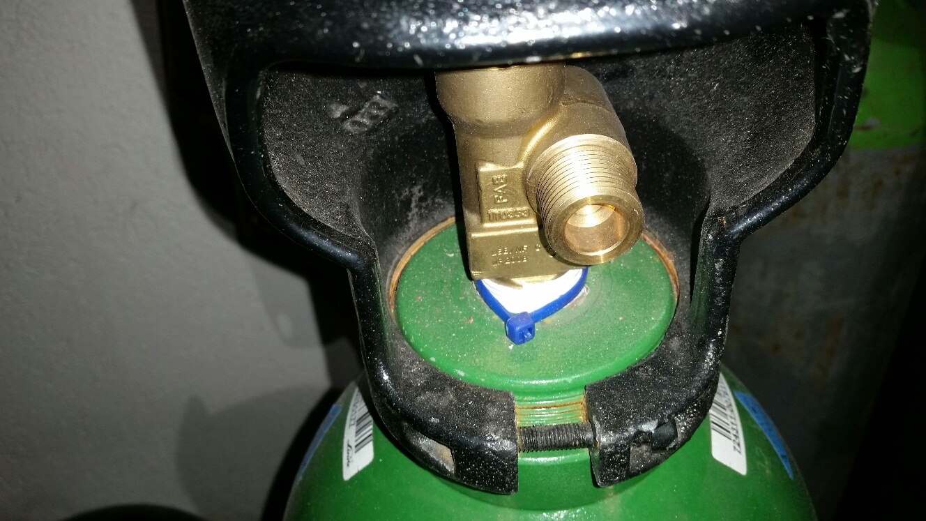

That was the plan but this reg has a male fitting and i need a female.Just twist flowmeter 90deg
Dial will be fine horizontal, I have my mig and tig just like that
Your argon cylinder has a male thread? Not seen one of those before
Possibly the NEVOC cylinder fitting, I use them, the bottle I have is 300 bar and something like 9 cubic meters from a half size bottle.Your argon cylinder has a male thread? Not seen one of those before

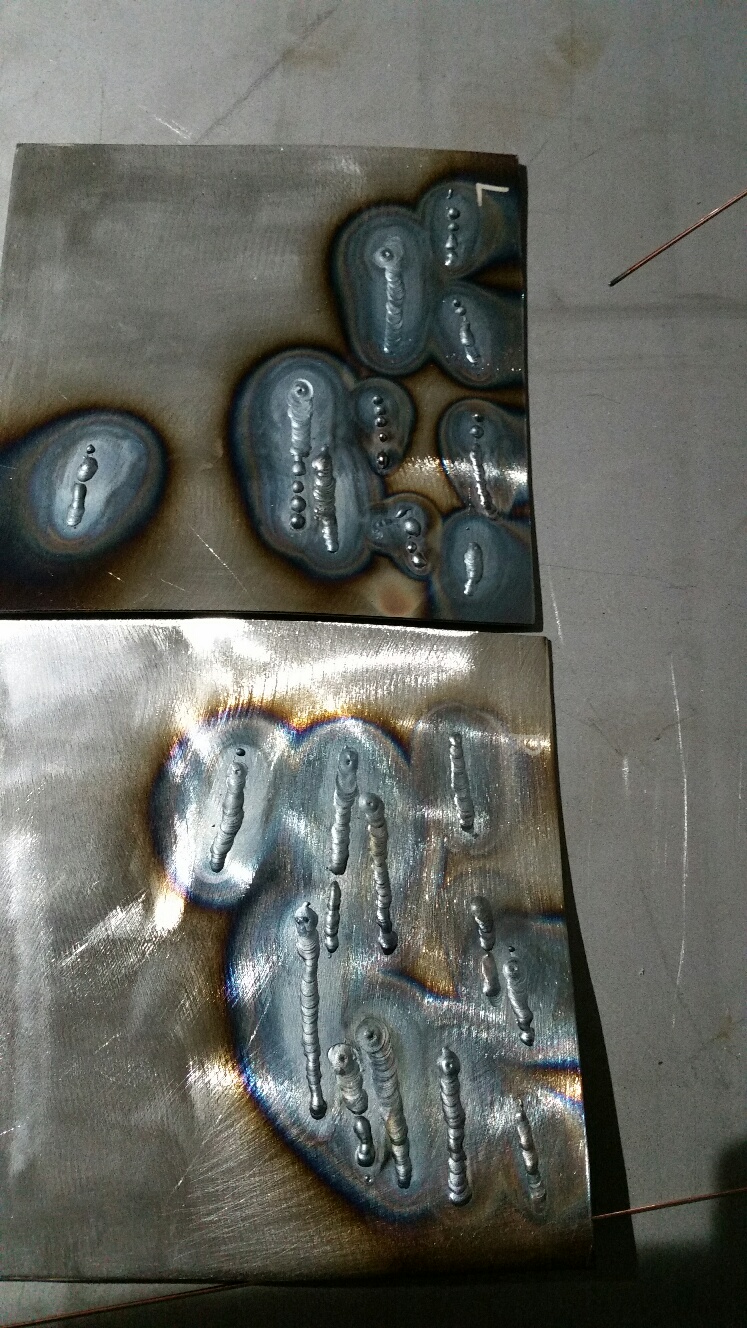

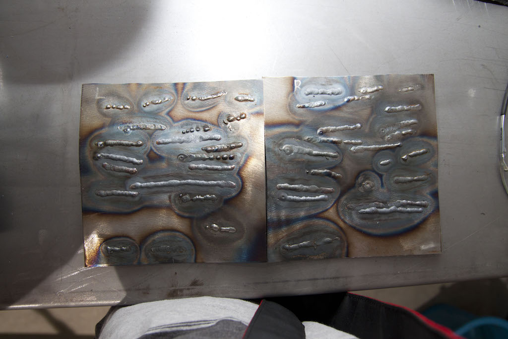

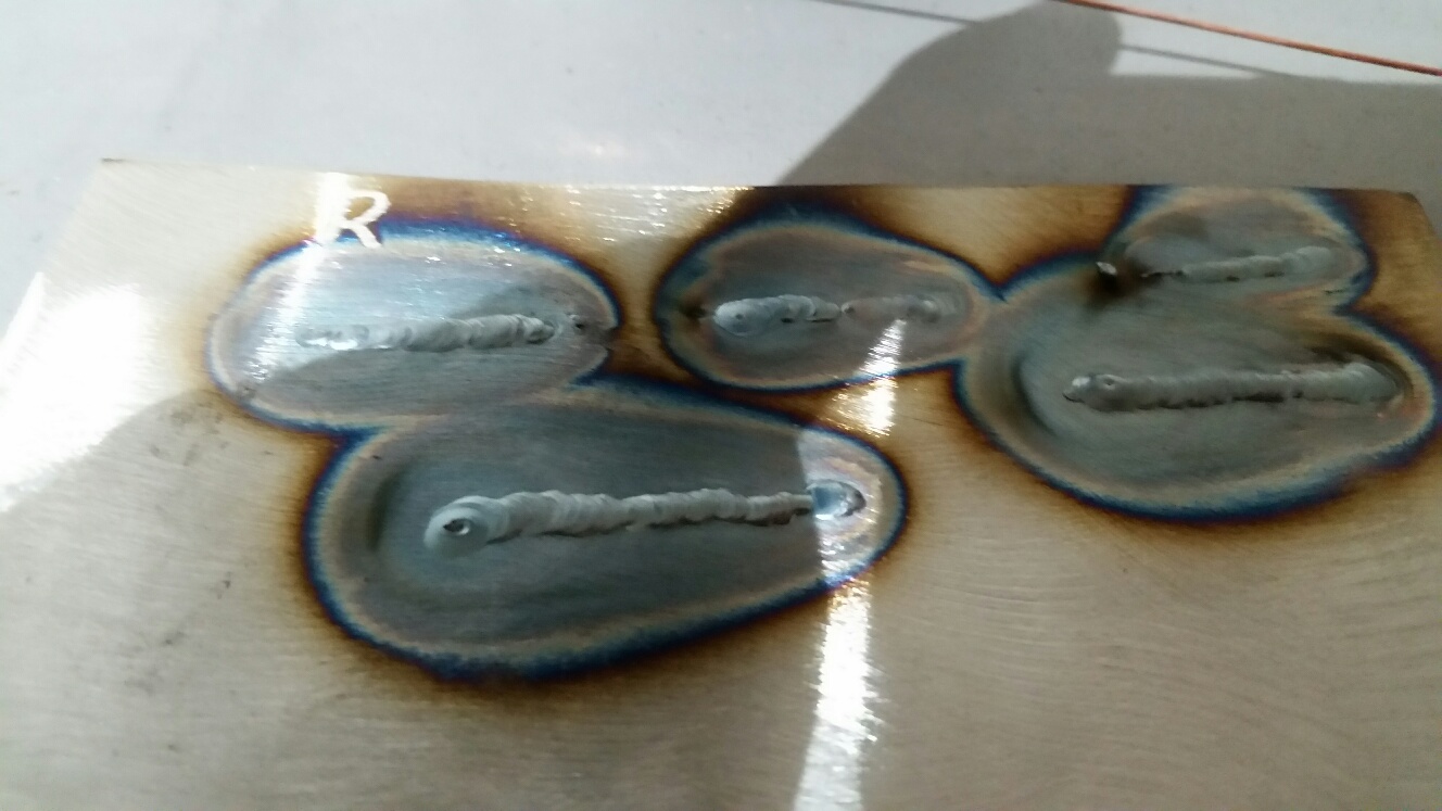

If that's your first go you should be pleased with that. Your machine appears to be doing as it should.
Decrease your arc length that should clear the soot.
Yes.Is it normal for HF to be hard to start if tungsten not sharp
