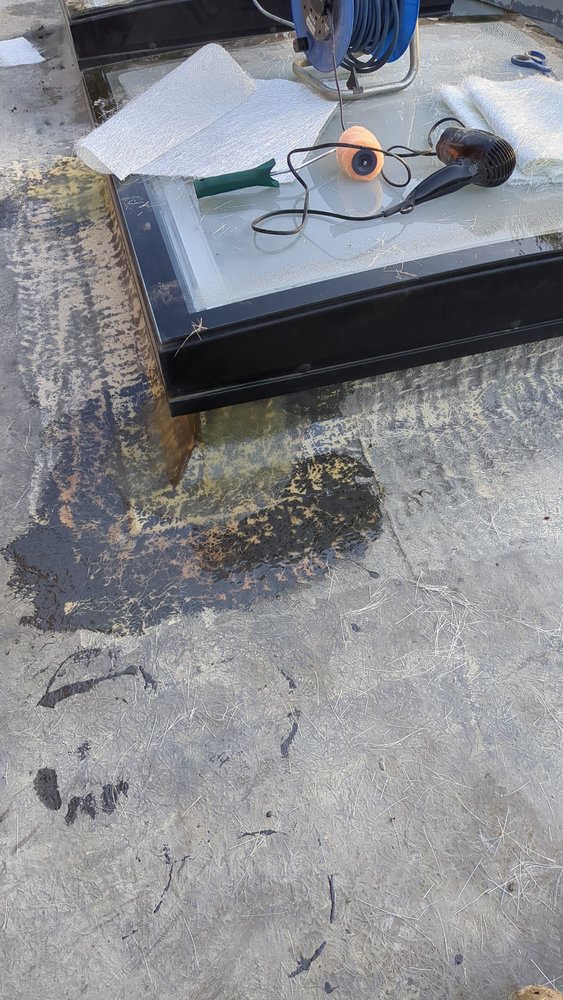

Why do they build them flat? I have never encountered a flat roof that doesn't leak![]()
If done well they don't leak.
And a quality dust mask.Don't forget the goggles. gloves and overhauls as fibre glass grinding is a total B*****D!! Course sanding disc's and grind back twice as far as you think. Hoover up all the dust and dry with a hot air gun. Degrease everything and I would G4 seal it first. then a few layers of chopped strand matting flattened down with the paddle roller, followed with the gel-cote. I get all my stuff from these people( Koi pond supplies ) and they have a few good videos on the site. https://www.fibreglassdirect.co.uk/fibreglass-pond-kit.html
I and there lies the problem…If done well they don't leak.
Not enough gel coat on that job...can be patched by sanding back, clean with acetone, use resin and few layers of mat but must be bone dry and spotless clean. Not a big fan of f/g for roofing as it has no thermal movement.
But you live in Wales!Why do they build them flat? I have never encountered a flat roof that doesn't leak![]()
Yes Mate, read instructions and pay attention to hardener percentage for temperatures on the working day. Ignore using top coat this time of year being novice and just get it watertight with the resin and mat till next spring and then consider your options for making a permanent solution to your problem.Is this the right stuff?
