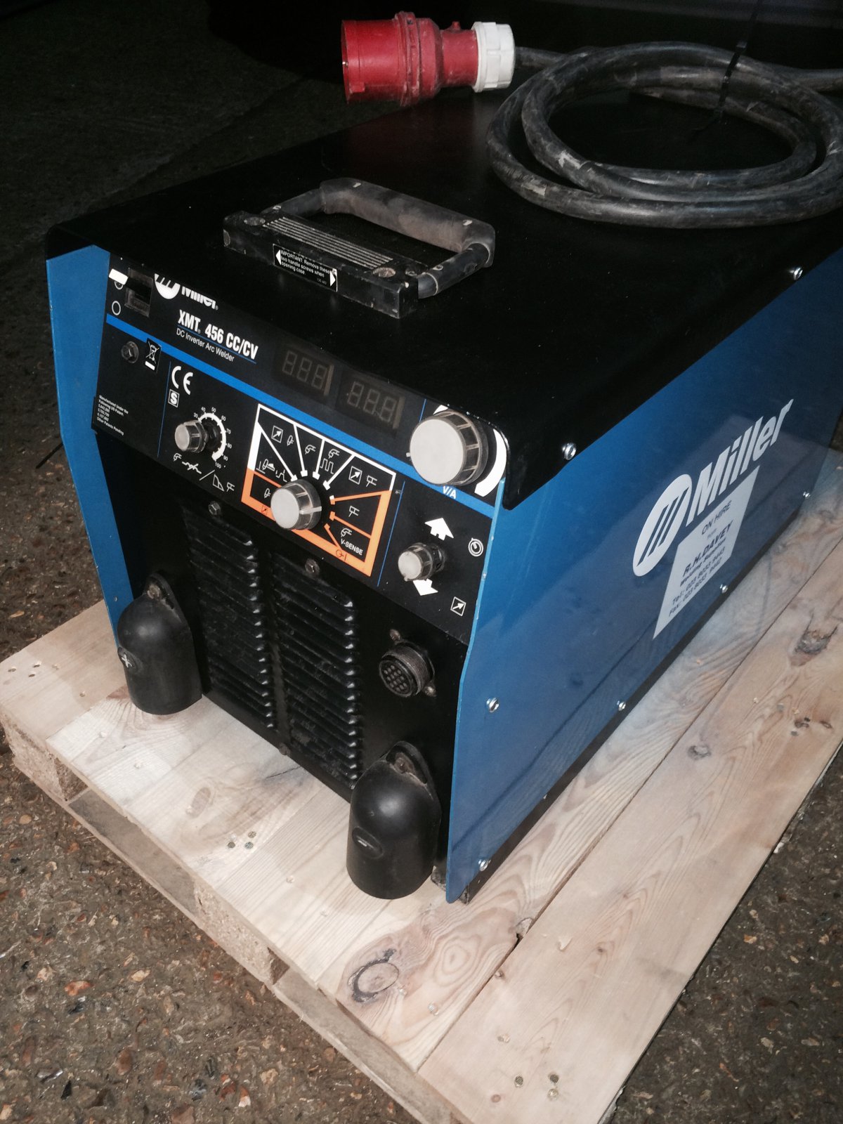

what is one of them cc/cv 350 sets worth secondhand jim?Cheers Al, I'm just demonstrating before handing it over, its rental kit after all.
this one i have here id be what you'd class as mint i suppose, as welders go.Depends on age, I pick them up in tatty nick for between £3-500. Often a little less if there are a lot of them. Once done up, with new fans (a weak point) new caps, powder coat, decals, new mains lead and dinze terminals and a 12 month warranty they can fetch up to £1,200 on the right day.
