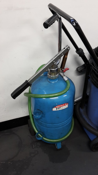

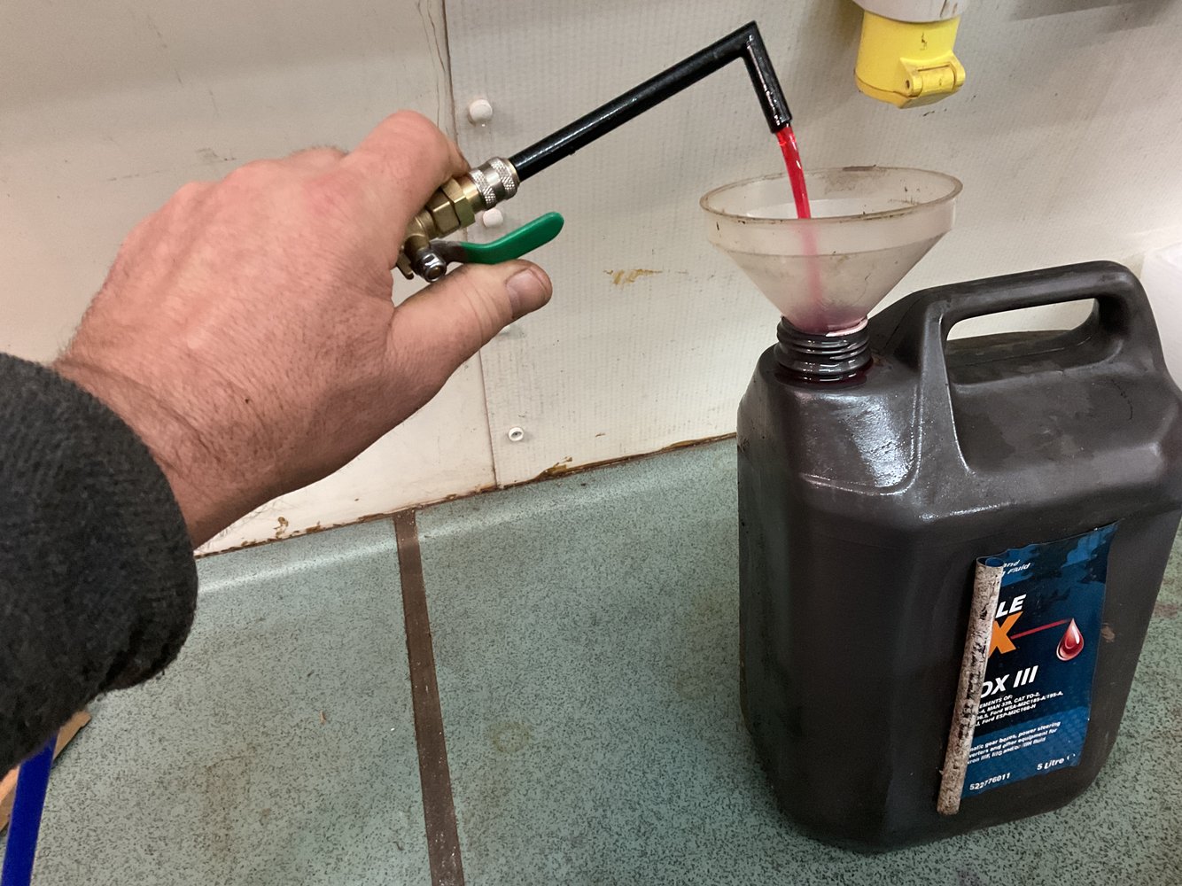

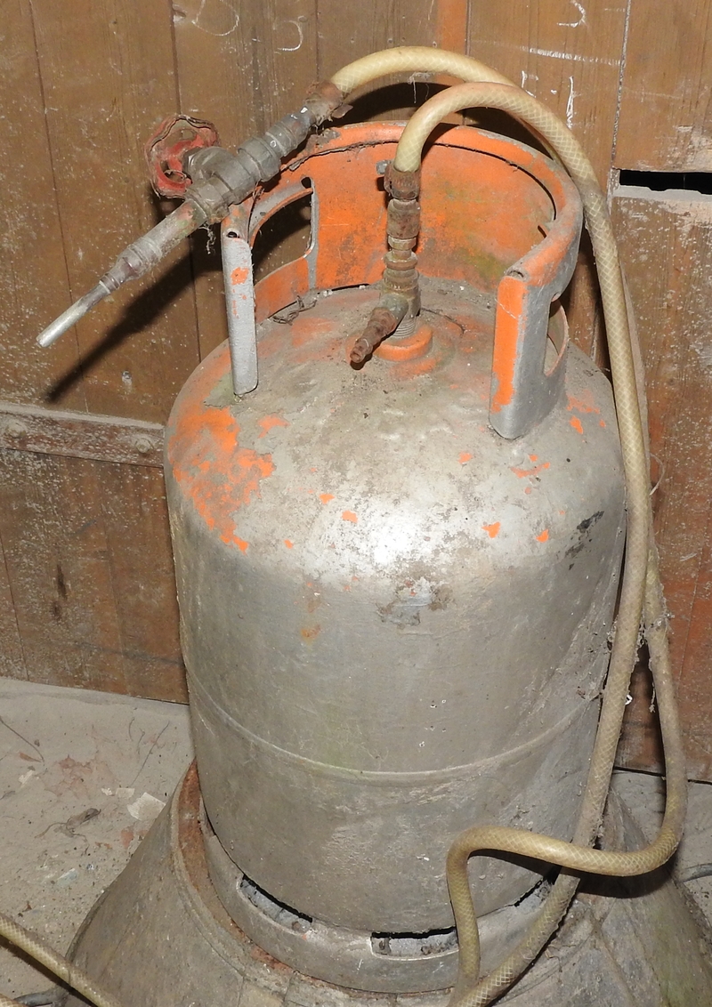

exactly like mine for ep 90 mine was taller and had wheels for truck gearboxes but heyho worked the same I used a 2" bsp barrel nipple and end cap at the top to fill oil through on mine, would hold 25 ltrs then fill with air and a stand pipe up the inside.This is one I made a few years ago when I ran a Landrover. With 2 axles, 2 swivels and 3 gearboxes it paid for itself the first time I used it. It works on compressed air (about 5 psi) and with the gate valve at the nozzle I can control it from under the vehicle.
