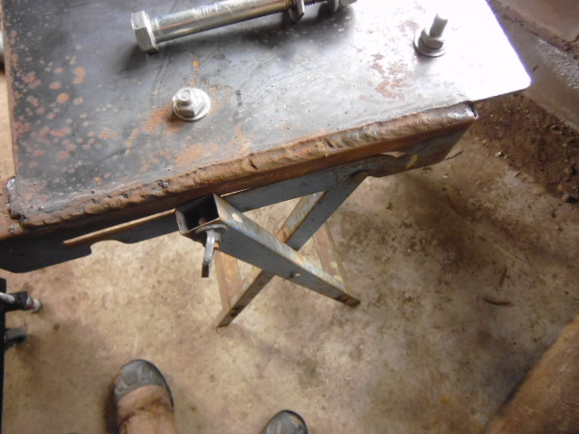

Have you got any thin on thin Kent? Thick to thin is easier as the arc can be concentrated heavily on the 5mm wetting the edges of the 1mm. I know it can be done as I've seen good stick welders zap up sheet metal around the 1mm mark. I on the other hand would not be that great at doing it as I've not had the practice.
Thing is it's all very nice talking about 1mm but on a car in areas it often drops below 1mm thick steel.
its verry easy welding thin metal to a thick piece just keep the rod on the thicker metal and it acts as a heat sink . lets see welding being done on car pannels without a heat sink behindWas in the shop with my camera this morning. Here is a thin work example the top plate is 5mm but that old workmate is 1-1.2mm and rusty. Rod used 2.5 6013 DCEN. Done in a rush!View attachment 65476
It can be done. I've seen what some people can do with electrodes. It's like anything worth doing it takes skill, time and practiceits verry easy welding thin metal to a thick piece just keep the rod on the thicker metal and it acts as a heat sink . lets see welding being done on car pannels without a heat sink behind![]()

just face it there no good on car bodyworkTheres a thin gauge method called break arc welding,i think thats what its called.you basically lay a stack of dimes one dime at a time.one dime,break away the arc,back in another dime,etc like spot weld migging i suppose.but too much voltage in a welder is a hindrance as when you try to break away the arc between each dime the bigger voltage keeps the arc lit.it would dance everywhere outside the weld area leaving marks. There is a murex welder dc201i or close to that anyway,has a break arc mode for exactly this purpose.it must extinguish the arc real easy when you break away i think,but i only stick welded heavy wall with it,never got to try the feature out
all i want to see is a few decent patches done on carbodywork with the arc welder and no heat sink behind not some thin bit of metal joined together on a bench that anyone can achievejust face it there no good on car bodywork
panels with stick u will never convince me . show me some that has been done to a half decent standard thats all i ask![]()
