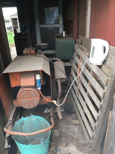

Pretty damn good shooting there, hit the bull...Sorry Fred you’ll have to excuse my ignorance.
Puncture the windings? You mean the insulation breaking down?
SOL? Significantly out of luck?
I warmed up the windings on my lathe's motor (after it had been in the damp for a year or so) by connecting a 12v battery charger to 'em through a headlamp bulb (to limit to 5A), left it for a few days until it was quite warm to the touch, had no problems with earth lakage after that.
