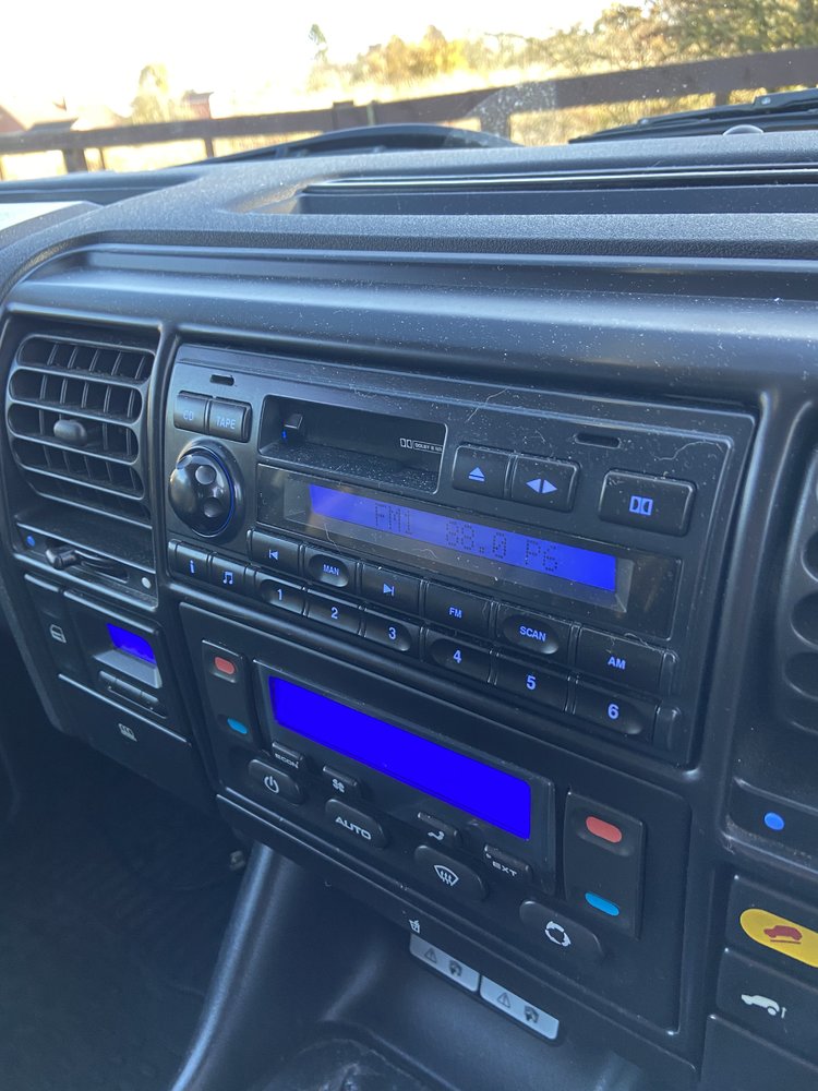

Looking for one that will do dab radio, iphone, bluetooth, reverse camera, preferably with a line output that will interface with the harmon kardon amp and speakers already installed. Any ideas ?

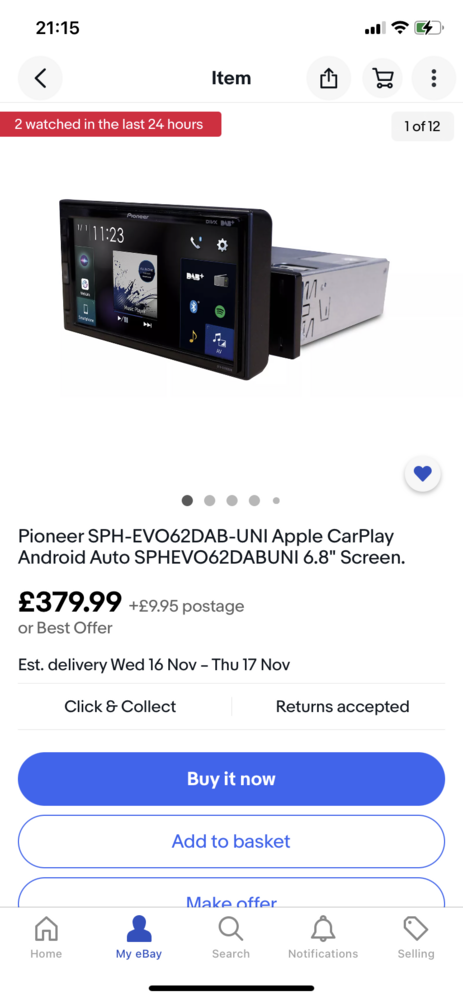

They're not exactly as rare as hens' teeth - most car stereos have aux out for amplifiers (and have done so for 30+ years), and many stereos have both an LCD display and a feed for a camera.
Even Halfords have one for £200 - https://www.halfords.com/technology...with-apple-car-play-and-bluetooth-723548.html
I know people give Halfords some stick but they do offer a free fitting assessment so I'd pop round and see what they recommend

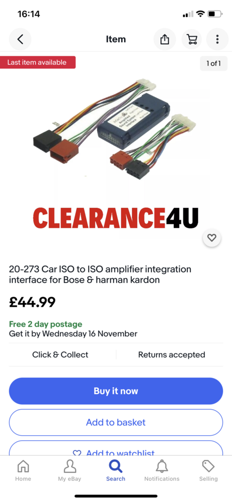

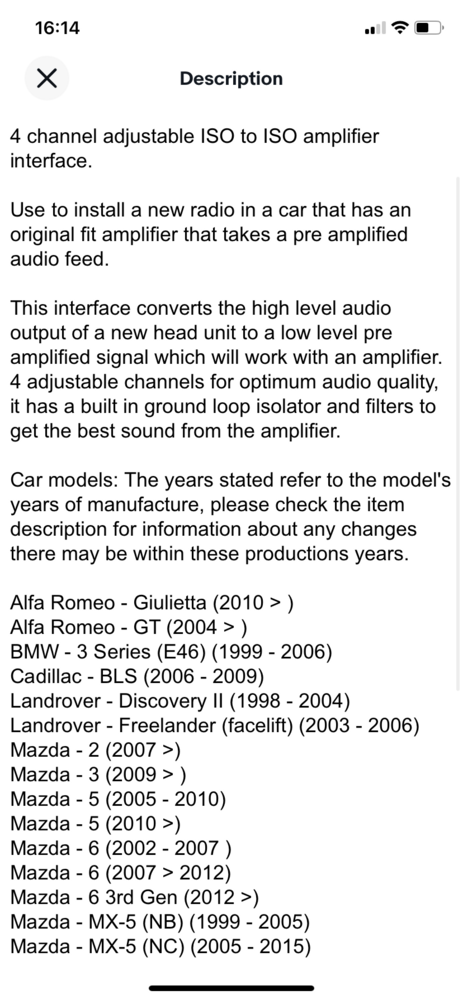

So something like this to make it work ?If he wants to keep the factory fitted Harmon amp/speakers then you need a line level input not a aux/pre out.
If the cars have the sub fitted like the disco 3/4 then it's a bit more complicated than that.

I did a replacement stereo in my D2 and yes - you'll need one of these to match the levels. This will give a left/right front/back feed to the HK amp (same as factory) & it will sort it out from there. As said above, it fits a single DIN unit only. To get a double DIN you need to bin the crappy cup holders, move the heater controls down and then you can just about fit a double DIN. some really neat examples out there but its not a trivial job to make it look decent.
Nice one thanks, ordered one. Just need to decide now whether to fit a new heated screen before sticking the dab antenna onI did a replacement stereo in my D2 and yes - you'll need one of these to match the levels. This will give a left/right front/back feed to the HK amp (same as factory) & it will sort it out from there. As said above, it fits a single DIN unit only. To get a double DIN you need to bin the crappy cup holders, move the heater controls down and then you can just about fit a double DIN. some really neat examples out there but its not a trivial job to make it look decent.
That Pioneer unit looks good - just need to make sure the bottom edge of the screen doesnt foul the AC controls, etc.
