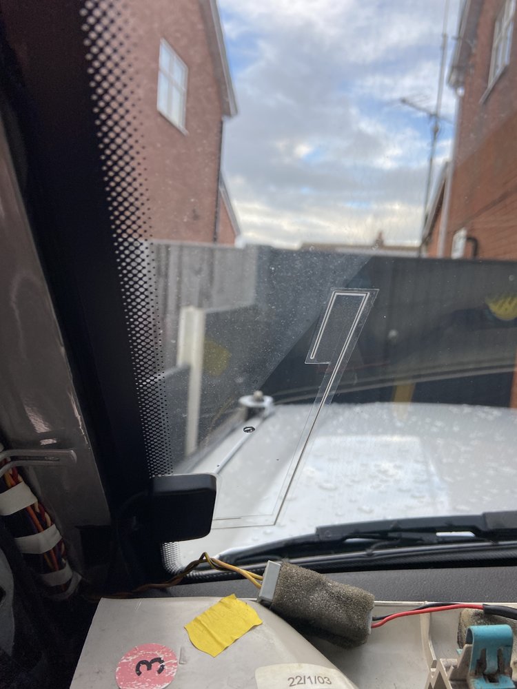

Thanks Andy, but the disco uses an amplified film antenna on the rear side windows, and was long before DAB, so I dont think the amplifier will have the bandwidthDon't do that! Use a DAB/FM splitter, far nicer.

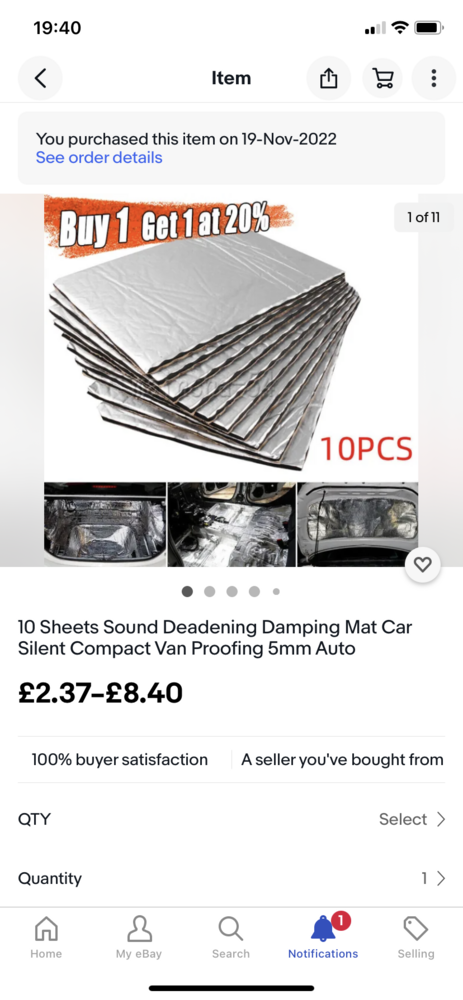

Be careful as some of it seriously stinksSelf adhesive flashing from a builders merchant is the same as dynamite, but much cheaper
Thanks, I have used that in the past but its like trying to use gaffer tape on steroids when trying to cut it and get it in through the holes in a door card.Self adhesive flashing from a builders merchant is the same as dynamite, but much cheaper
Soften it up with a hair dryer, works a treat and smaller strips / sectionsThanks, I have used that in the past but its like trying to use gaffer tape on steroids when trying to cut it and get it in through the holes in a door card.![]()
