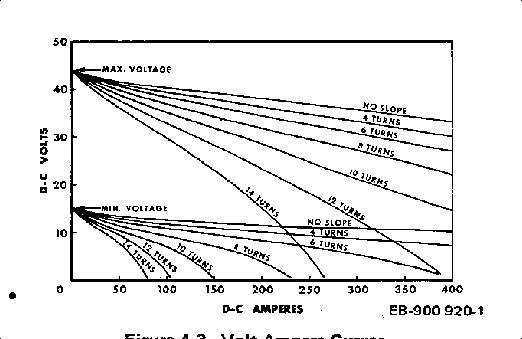

I'd say your readout would be pretty useful, it will be telling you the readings under load which is what you want to know.
When you say it made no difference, to what, your readout or multimeter readings?
Really useful ermmm no, there of little use unless your into doing WPS work, even then a clamp type meter is needed for accuracy..... they just flicker around in the background severing little use the rest of the time
BTW wps "gestemate" is around a 1 Volt drop from machine parameters to actual welding volts........
an accepted method of setting an ARC voltage, is to know what the drop between OVC and arc volts are, deducting the latter from the first will of course give you an accurate arc voltage....hence the reason why OVC is used as to quote parimiters......
hmmmm I don't think load voltage (amps) has had a mention yet......

Unfortunately not Jugs, the miller calculators give guidelines for certain types of joint on certain materials but it's up to the operator to know his/her machine and to set the parameters to suit. If you are a consistent welder who operates the same machine all day every day then it would become second nature to know what to set the controls at.
I'd just like to know accurately what voltage each step produces. Unfortunately like Snowy says, the only way to accurately measure it is under welding conditions so it's not easy. I did actually measure mine while welding but watching the multimeter while trying to maintain a consistent arc length and protect myself from the UV isn't easy at all.
TBH jugs its not possible for them to provide that data, ...... on 1 given set, I could be using 0.8mm, 1mm, 1.2mm solid wires or if its vertical or structural be welding with duel cored flux wires...... now as the IPM on the feed would vairy so essentially would the amps (think of wire speed as this)....... thats without taking into account my "skill" so thats my forward speed torch angle and stick out, again (amps/penetrtion)....... if I was to use a different length torch, couple miles of cable between the SWFU and the supply, and swap from heavy shield to Co2, the volts (heat) could change.....
so thats another Bristol via bath, way of saying, you can only really work your own variables out
