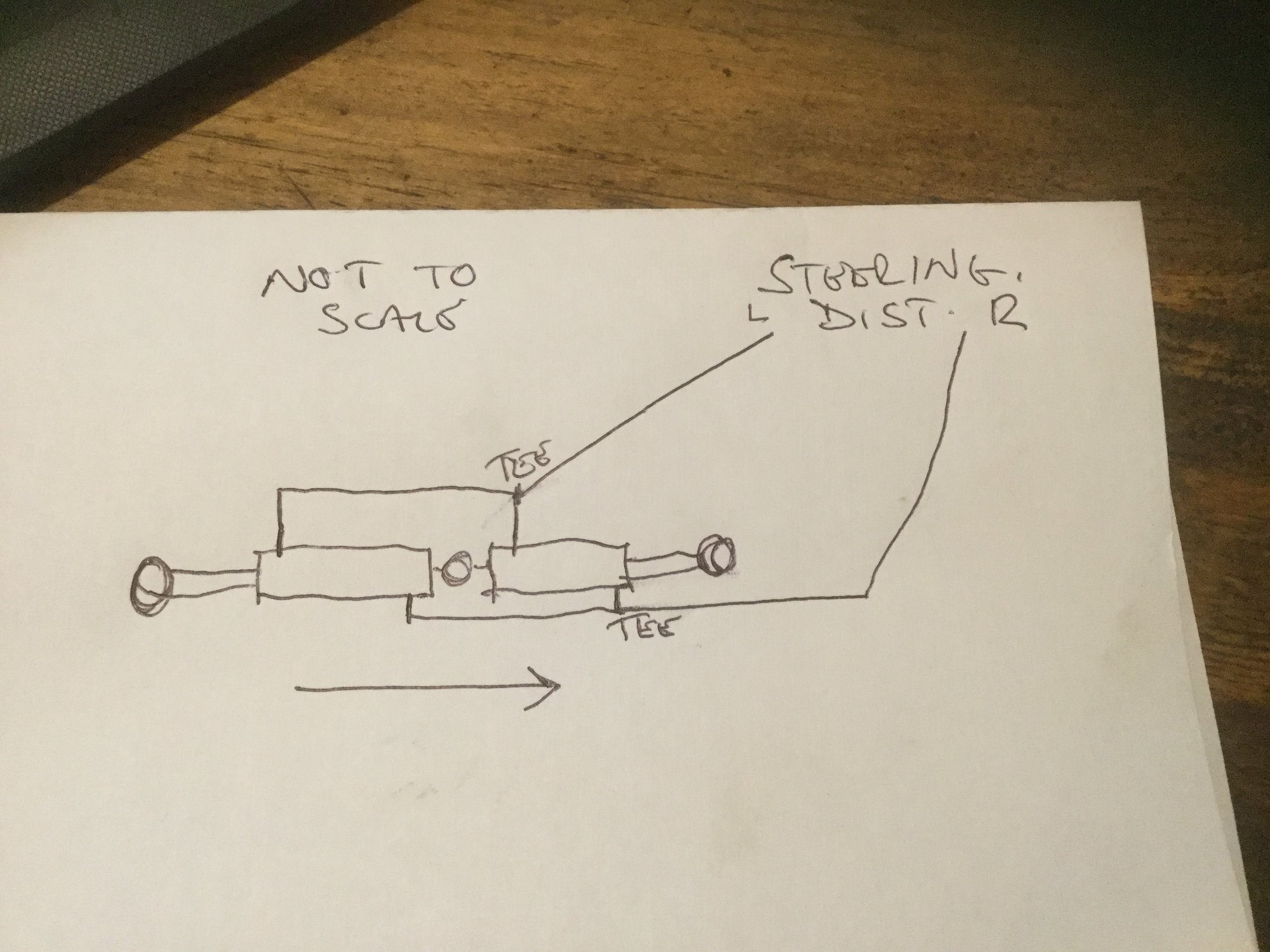

@nickk, is this single or double acting cylinder!
If a double acting see below -
if you can leave the pipes on and swap the ram around do that!
For tom and zzr, if the LH pipe pushes ram To the left, then if you swap ram around, leaving pipes on the same fitting, It will then be that the previously LH pipe will now push to the right.
only one ram , covered in an earlier post.

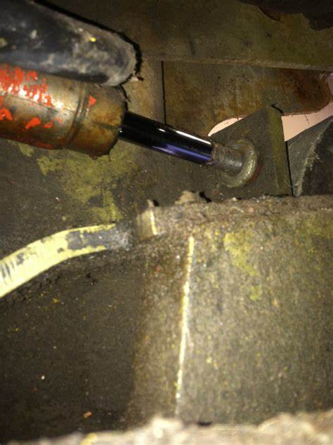

if that was the case there would e a shaft running into it , like on avling barfords , but from the pic , just two hoses .It's not one of those assist rams is it ? The sort that use a conventional steering box/links and the ram attached senses movement and assists.

Check out Clark c500 from the 80's the piston is anchored and the cylinder and valve moves. Crazy but trueIn the 18 years of working on fork lifts, I've done.
I've never seen the cylinder part of a steering ram connected to the stub axle, the cylinder is always the fixed end.
ie: to the axle casting.
Double acting cylinders are the normal type used.
I had one on machine that sensed the push/pull from one end. It went squiffy and when the engine was revved it would turn left on its own.
