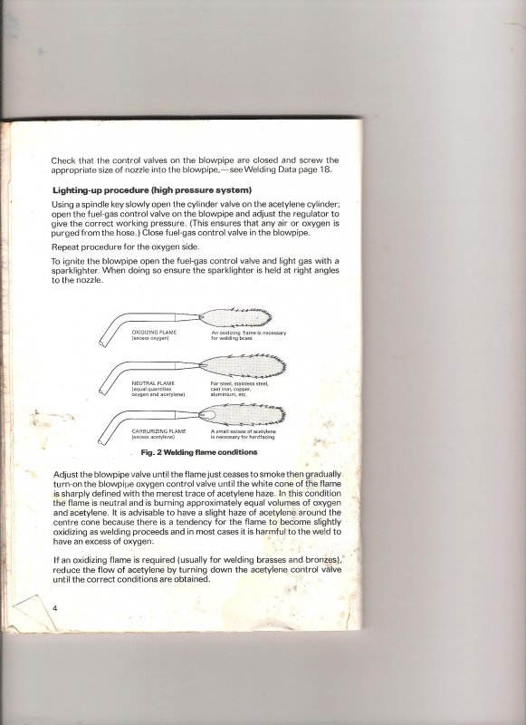

Hi, I've been having a go at welding with my O/A kit and I've been getting some great welds where the fit up is spot on and I haven't needed filler rod but when I started adding filler the puddle fizzes with Sparks and the finished weld looks oxidised. The rods I was sold by my local welding shop are Geka Eligas 1 AWS A5.2 (SFA 5.2) R 45. I was wondering if these were the right rods or not as I only get this problem when I add filler rod. Any help would be greatly appreciated. Thanks.
