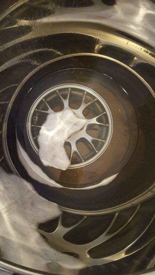

How much HF acid you will add in a 50l meth chloride tank?i got a stainless steel tank with plain methylene but doesnt seem to work on vauxhall alloys....the primer its untouchableI don't know about HDPE, we use stainless. No water on top as that will draw out the methanol and HF acid into that layer. Be very careful where you put the tank as the fumes corrode everything metal in the area. You will need a mask suitable for acid vapours and the calcium jelly before you start. It's quite hard finding PPE such as aprons and gloves that don't get eaten by HF acid in a short while.

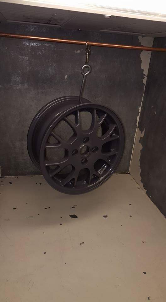

Also most importantly what are you doing with the items after dipping, alloy is porous and soak's up the acid. If you don't degas them in a oven and instead just wet paint it tends peal off later on, best not to leave them in overnight or you end up with some heavy pitting.
Hi there,i hace a oven for 4 wheels to fit in,a stainless steel drum for stripping a cabinet for sandblast ,compressor and a powder coating unit but no place where to put all this...im lookig for someone to join me and make some money together...Atlas-T will strip the paint off and chase it down the road.
