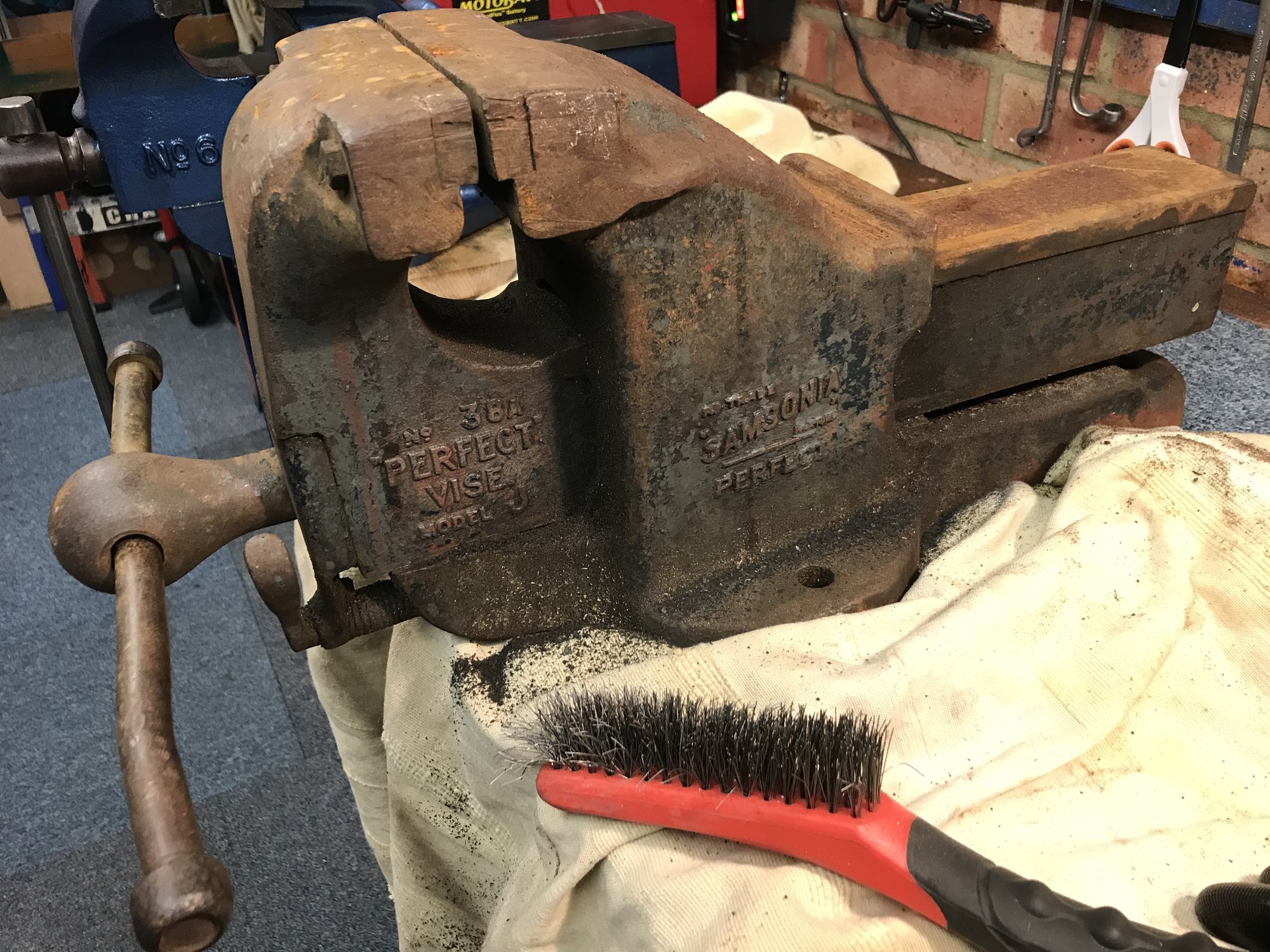

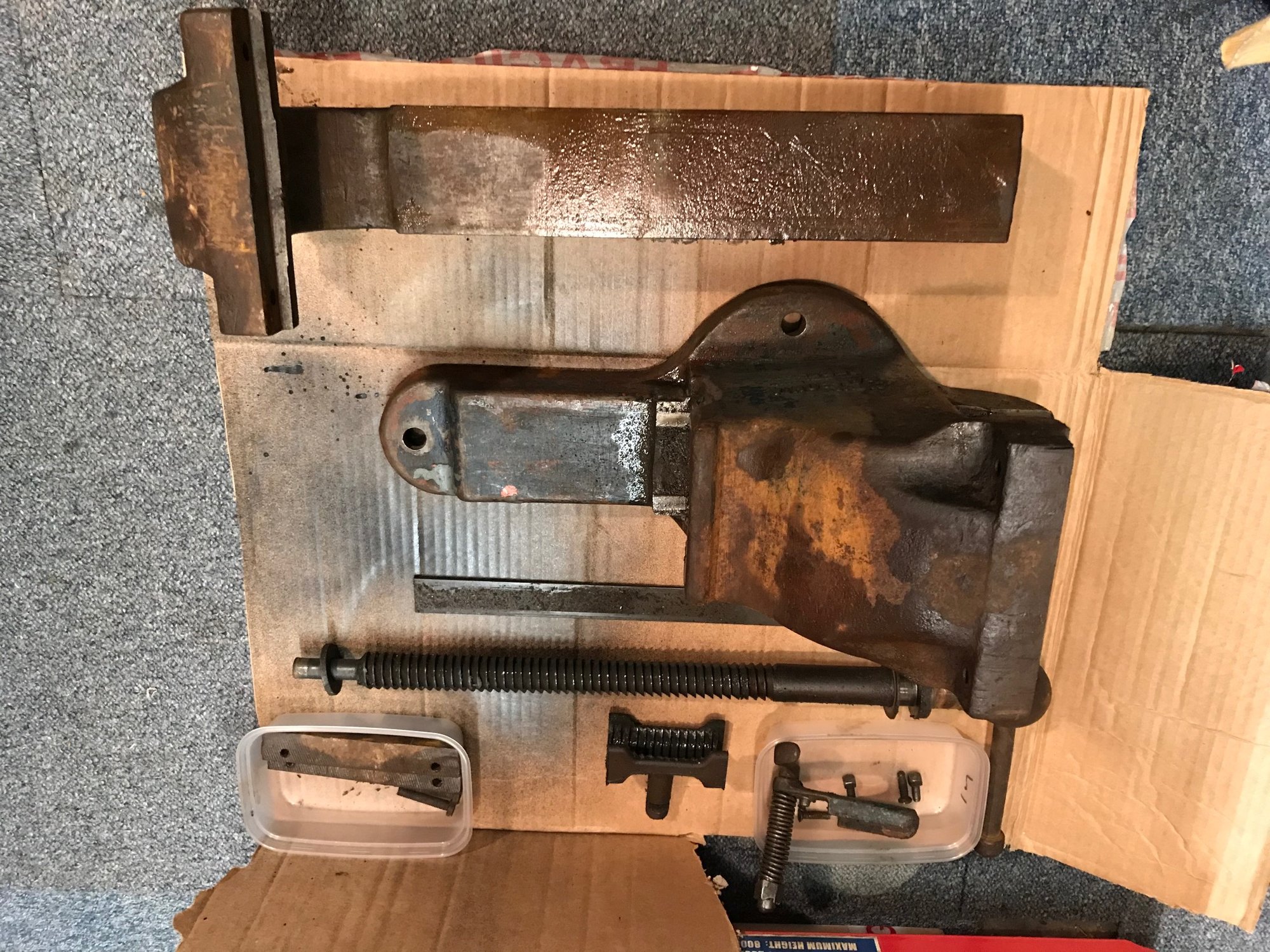

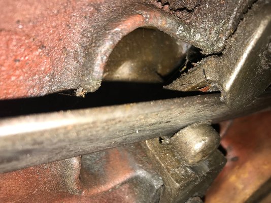

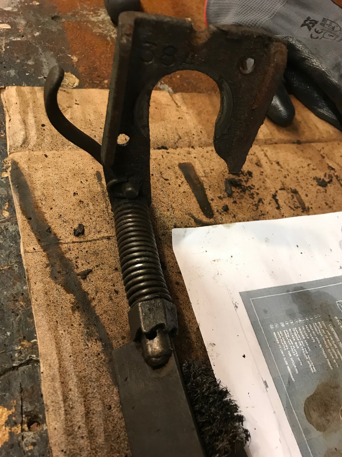

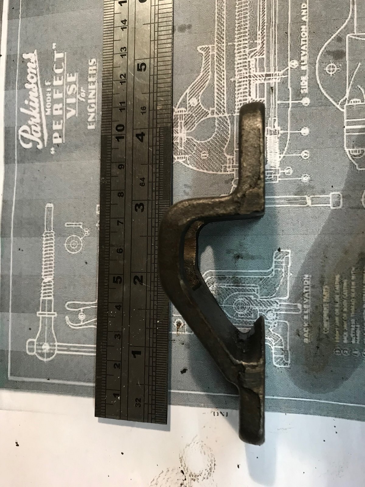

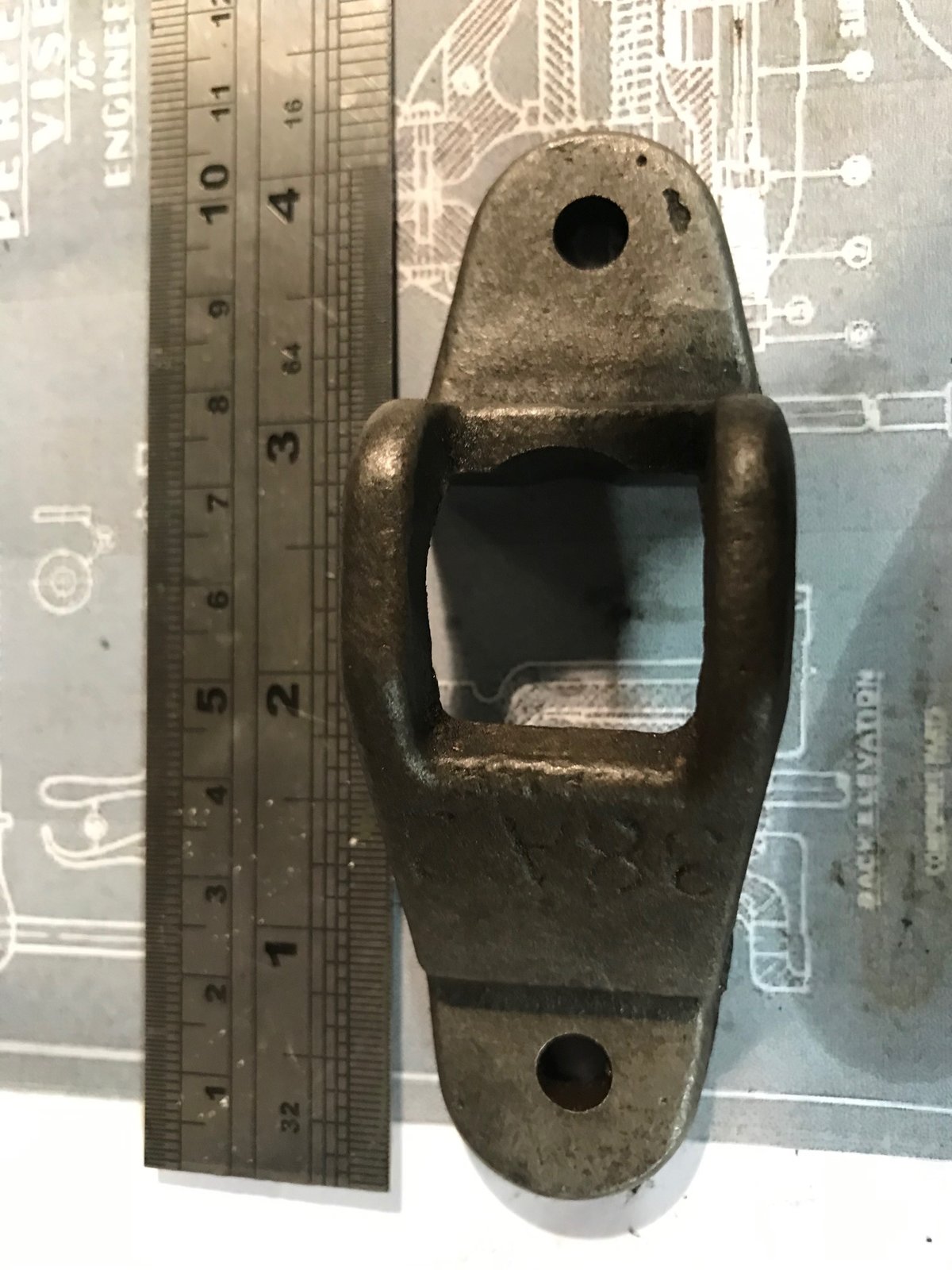

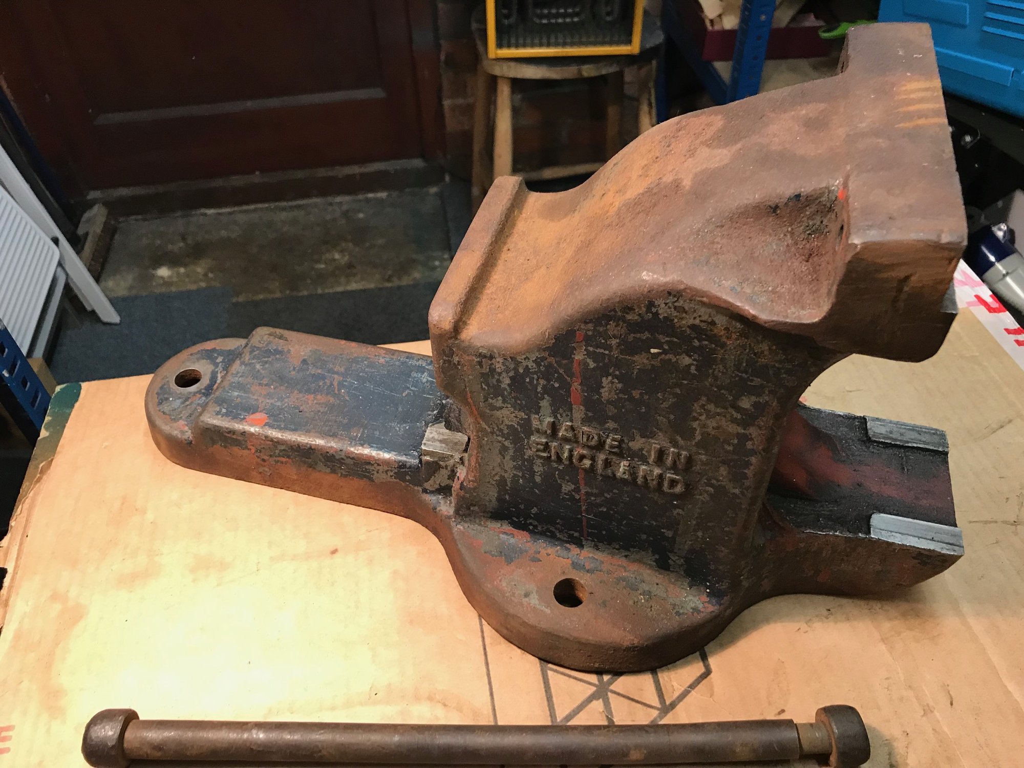

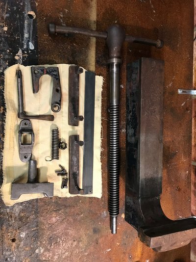

I collected this Parkinsons Perfect 38A vice today, going to strip & clean it up proper, although surprisingly the quick release and screw action is smooth as is..
Some questions please.
I think they did swivel base as an extra looking at the old brochure, is it likely any of those are still kicking around?
Fully closed there there are a fair few gaps, any tips on getting new hardened vice jaws for one of these?

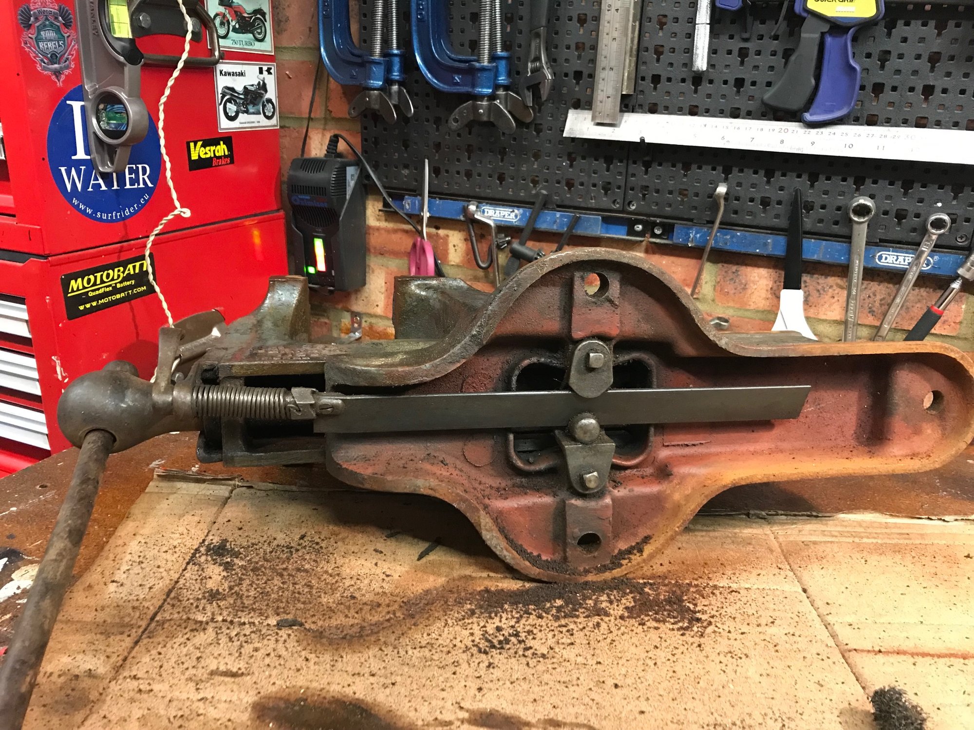

The bar is bent, i've freed off the ends to turn, not sure whether to just cut it off and replace with new bar and just weld on some ends or do something to salvage, the ends at least..
