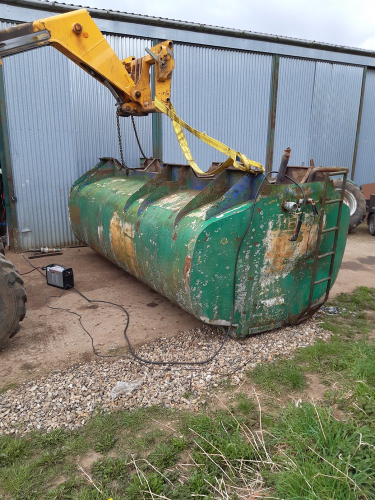

Coogar was Air products, Argoshield was B,O,CI TIG-welded one of the fuel tanks from my TVR, but it had been empty for two years
Pumped Coogar (predecessor to Argoshield I think) through it before lighting up the plasma torch to cut the top out, but there was nothing in there.

I've a couple of holes to repair in this one. I need a large piece of paperWhen I was 16 the petrol tank on my Honda ss50 started leaking from around the tap. So I took it to the local blacksmith in the village he tipped out the remaining petrol rolled up a sheet of paper pushed it into the filler and lit it. It burned down and the vapour ignited with a whoosh. He said it cannot explode now and brazed the leak. I've never been brave enough to do it myself.
toilet paper?I've a couple of holes to repair in this one. I need a large piece of paper View attachment 283624
