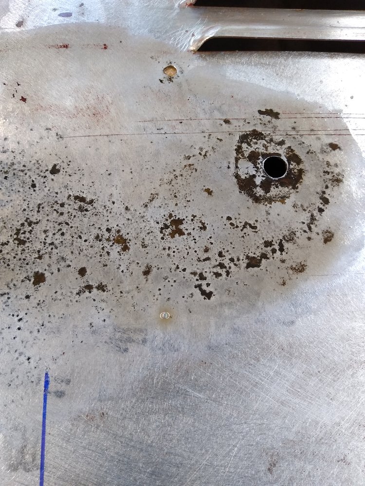

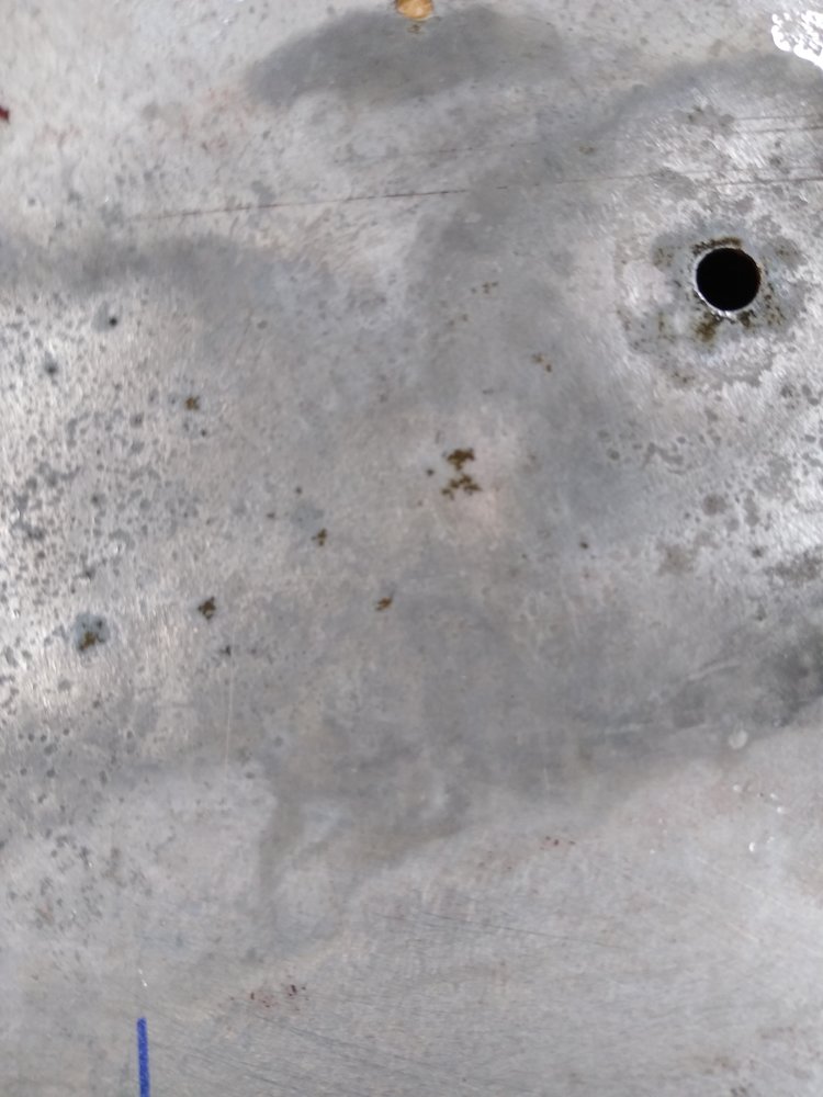

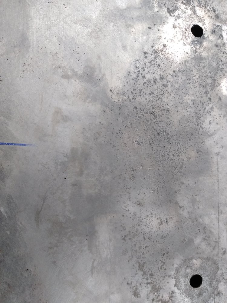

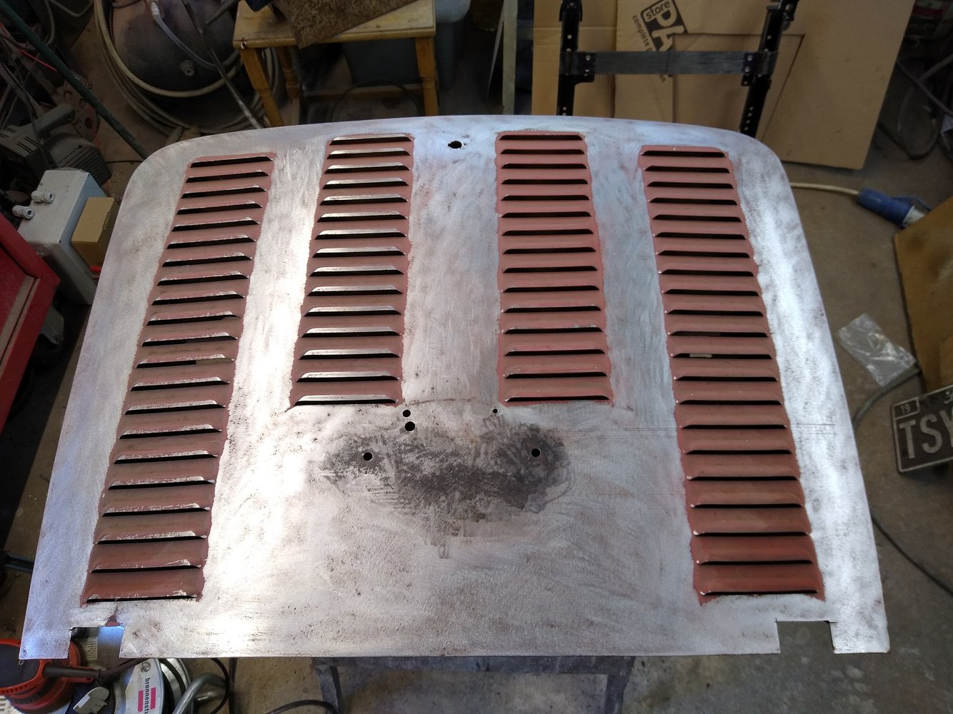

Clean it with panel wipe then sand all the steel you can get to with 120 or 180 grit, then apply epoxy primer.
Splendid advice and the most accurate in my view. If you were paranoid, then maybe an alkaline wash followed by clean water, allow to dry and then panel wipe. What epoxy did you buy? An automotive grade like Lechler 29107 is the recommended type for that purpose.
