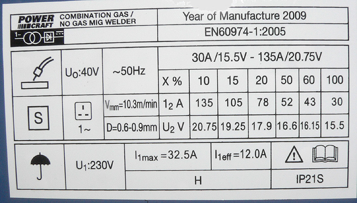

Er sorry, but isn't it non-live when used with gasless wire only? Swapping the connectors over inside the box for use with gas/normal wire then makes the torch live?
"Live" does not in this case refer to + or - voltage but to if the wire / tourch has that voltage all the time or just when the trigger is pressed / wire is coming out the tip.
