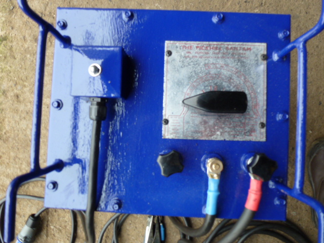

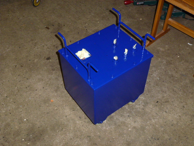

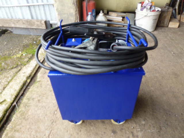

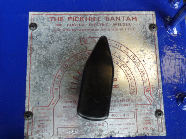

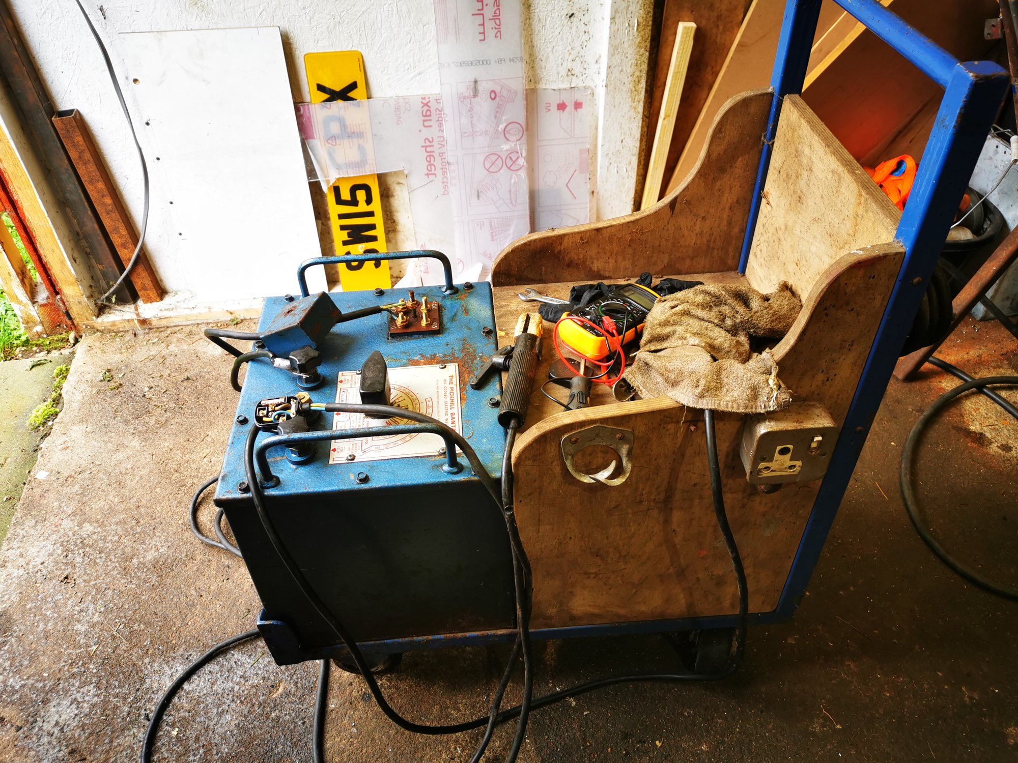

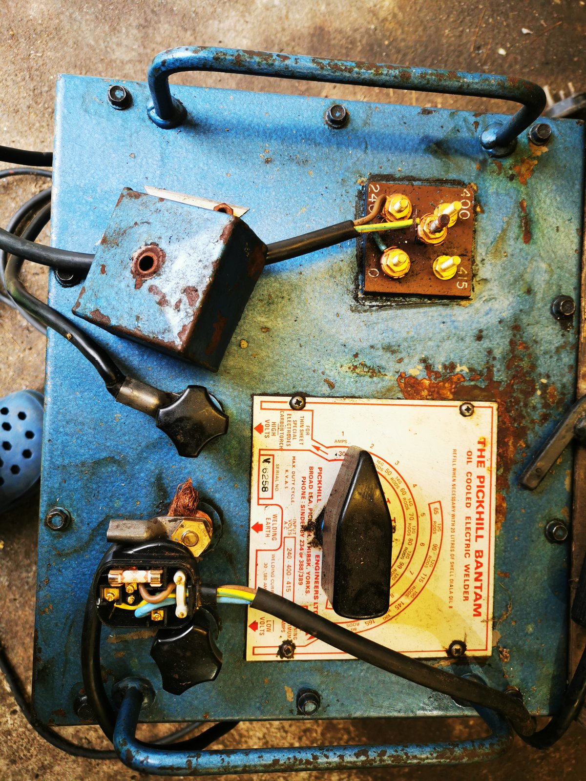

Thought I should update this.
It was painted in 'Record' blue. The colour choice definitely wasn't just to annoy MattF, it just happened to be the only shade of blue I had enough of!
View attachment 143915 View attachment 143916 View attachment 143917 View attachment 143918 View attachment 143919

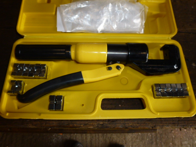

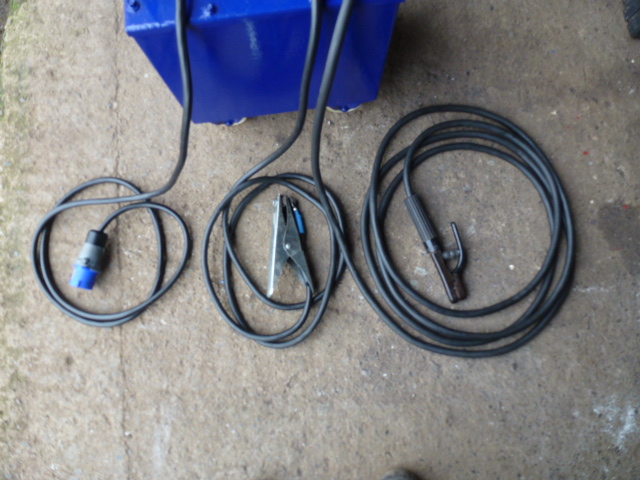

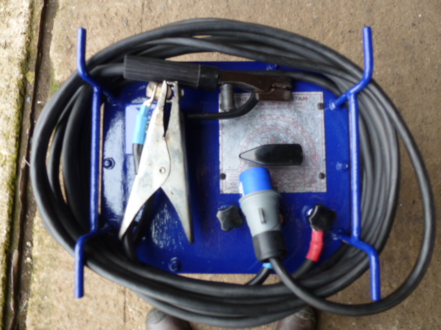

I used my ebay hydraulic crimper to fit new ends on the longer leads I made up.
Thanks to the board members for giving me the heads up on this, a very useful tool indeed!

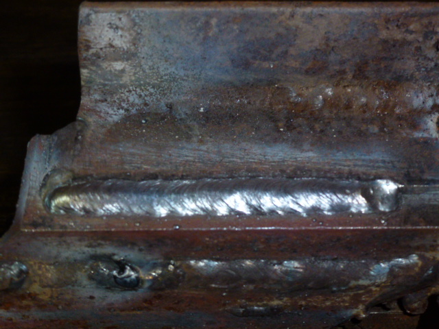

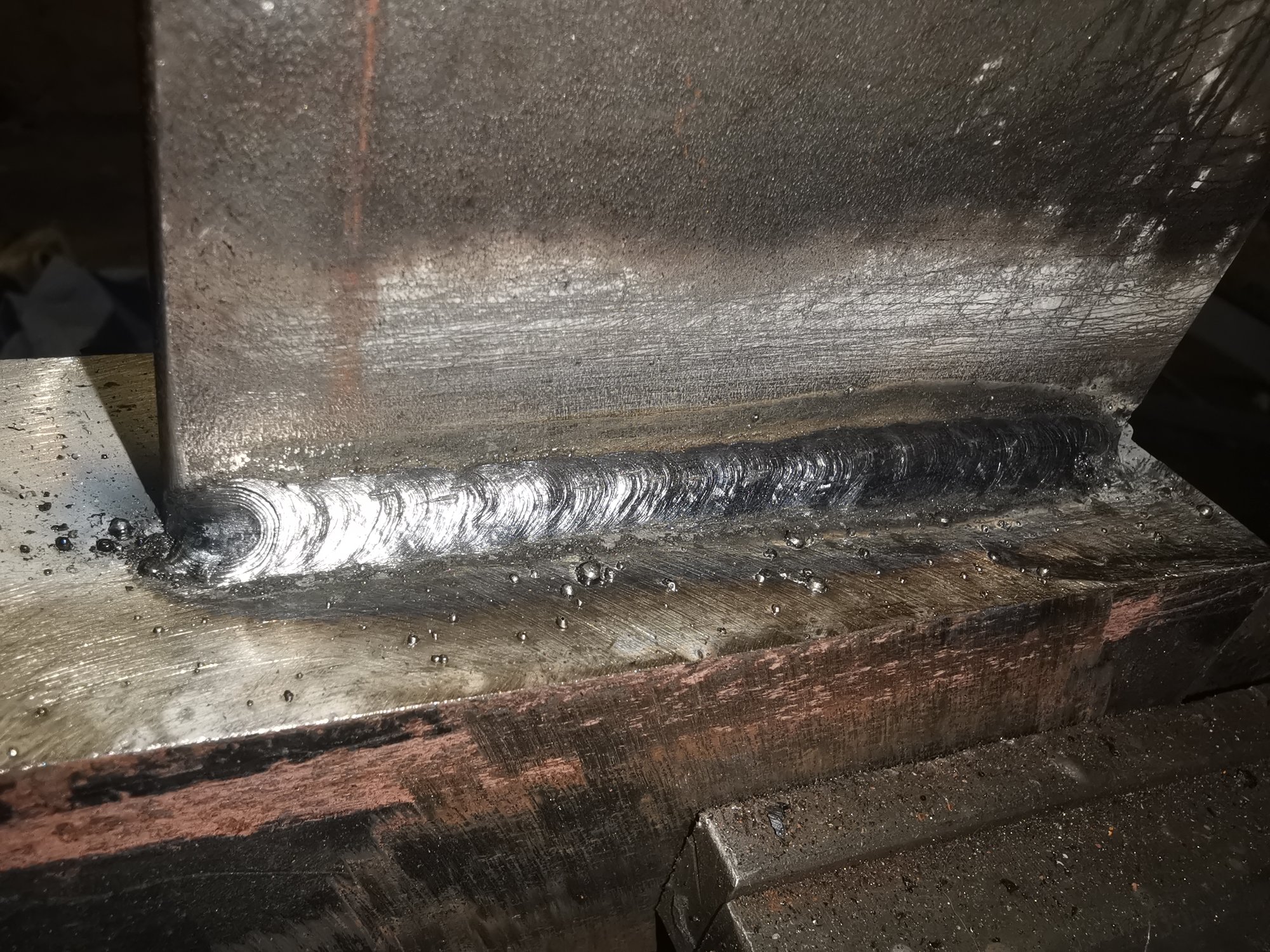

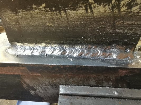

Despite my best efforts it produces lovely welds!
Unfortunately the welder has to go so I put it on Gumtree last night.

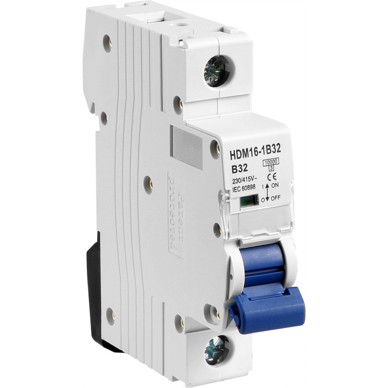

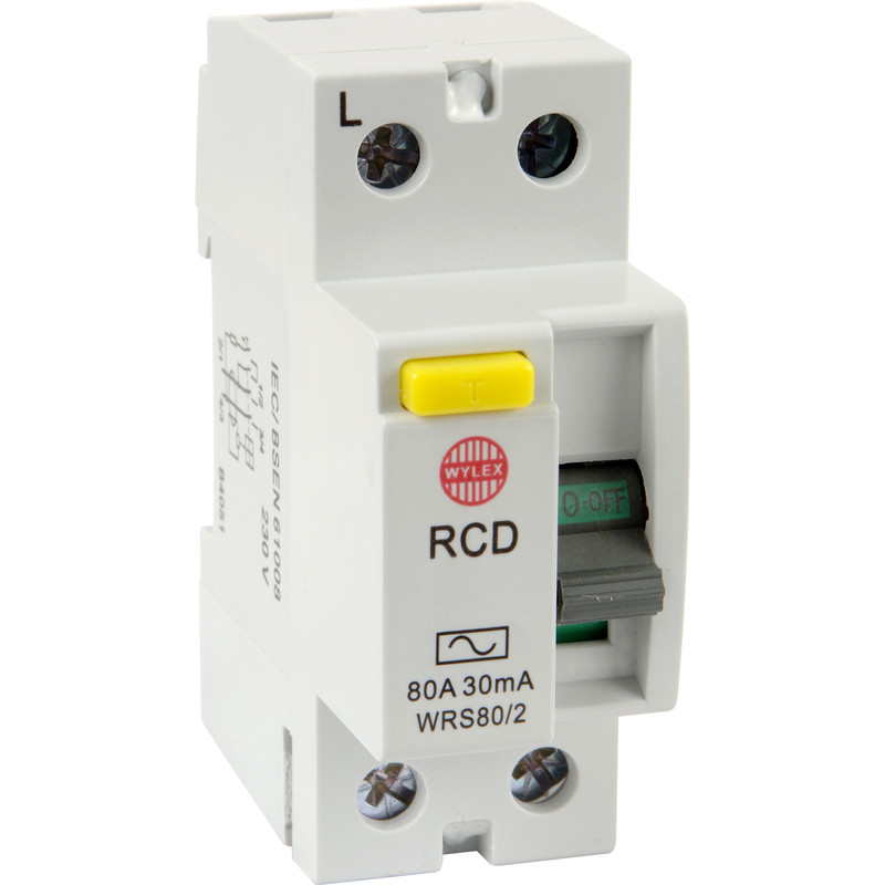

Trips the breakerin the house, I have my shed wire directly into house socket. Works my other welder flawlessly.when you say tripping the power do you mean a miniature circuit breaker or the rcd earth trip switch
We need to know if it is an MCB or RCD to get an idea of what might be happening.Trips the breakerin the house, I have my shed wire directly into house socket. Works my other welder flawlessly.
Thanks for reply
Sean
if its the breaker what size is it my 180 amp takes out the 32 amp b type break the second i turn it on. realy should be a c type but im 2 lazy to change it

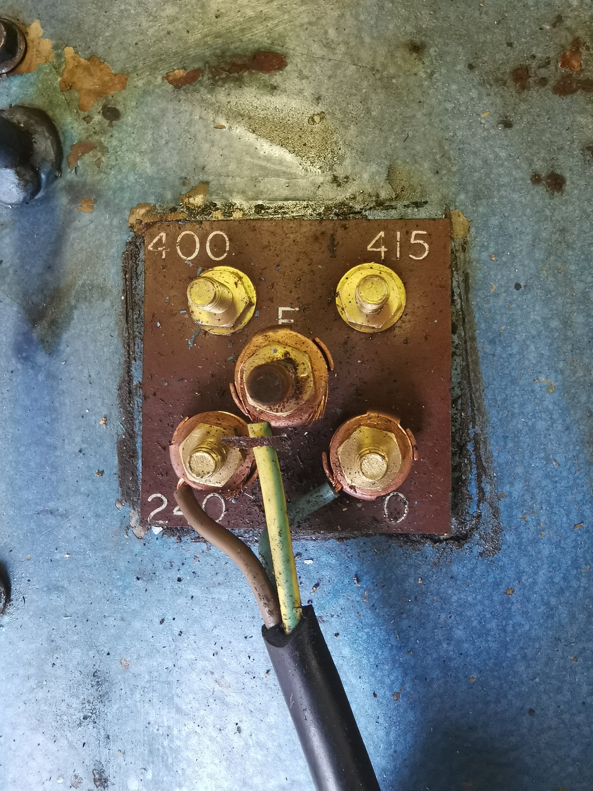

There must be an open circuit somewhere. It could be in the incoming supply wiring or it could be the transformer itself has burnt out or a broken connection on the output side.
Only way to find out would be with a meter and if you are not confident with electricity then the best way would be with the welder switched off and use an ohm meter to check for continuity.
