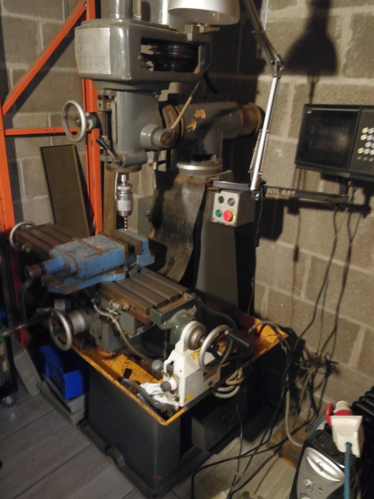

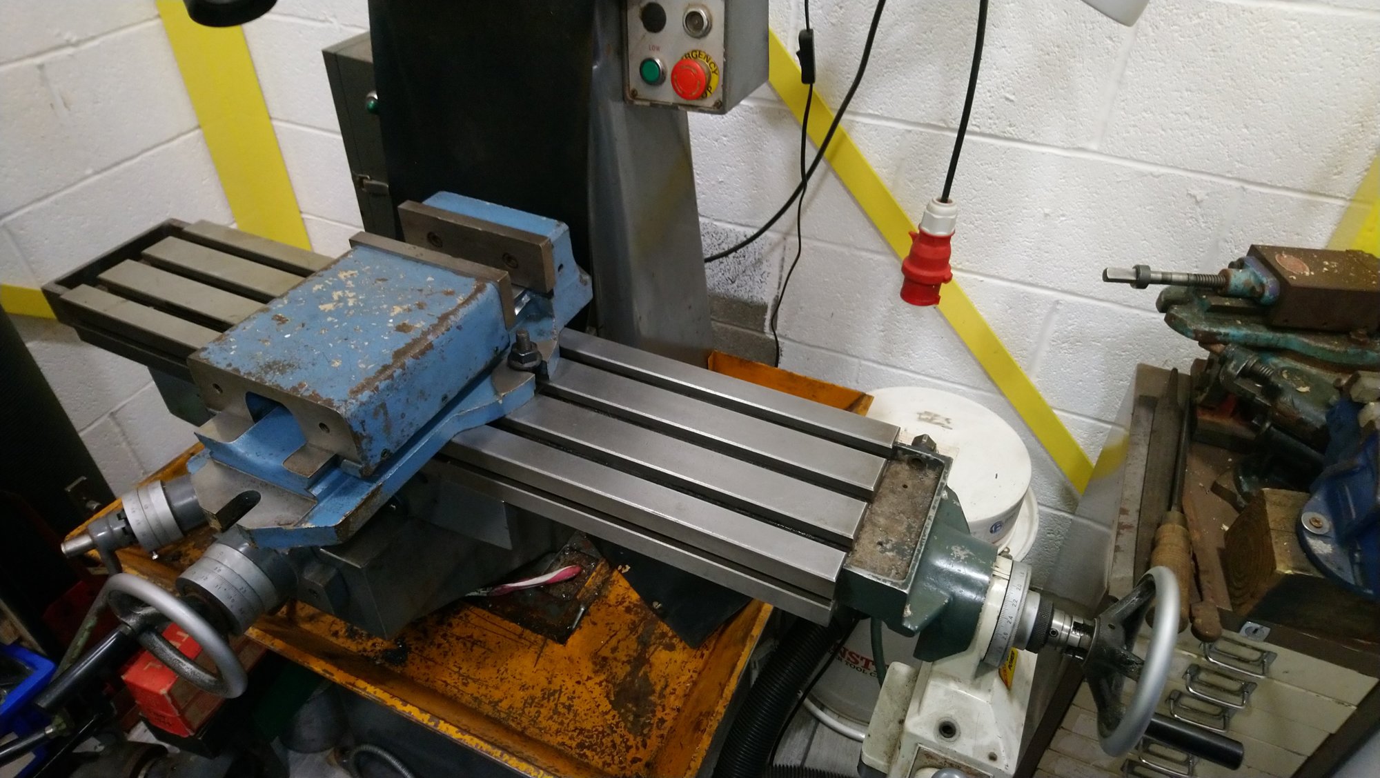

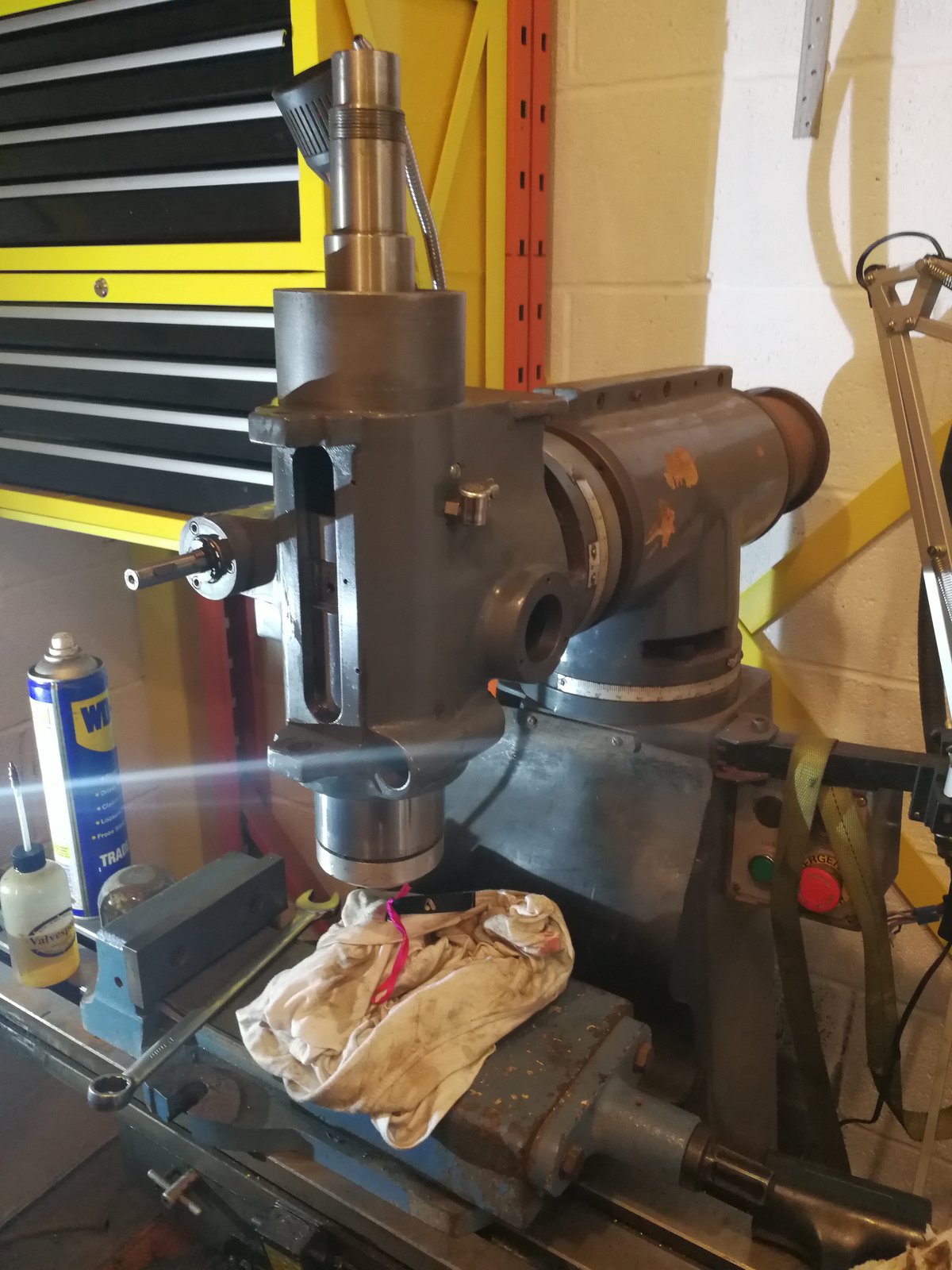

Bought this just over a year ago, eBay purchase from a local electronics firm. Visually it was in pretty good condition but is about 22yrs old.
It came with a 2 axis DRO but only had a scale on the y axis and power feed on the x axis.
It has seen some use since it came into my possession but has always suffered with chatter. Had a pretty good idea it was down to the gibs needed adjusting and there was also some lateral play in the quill.
Other projects kept getting in the way including extending the garage to make room for it and my M300.

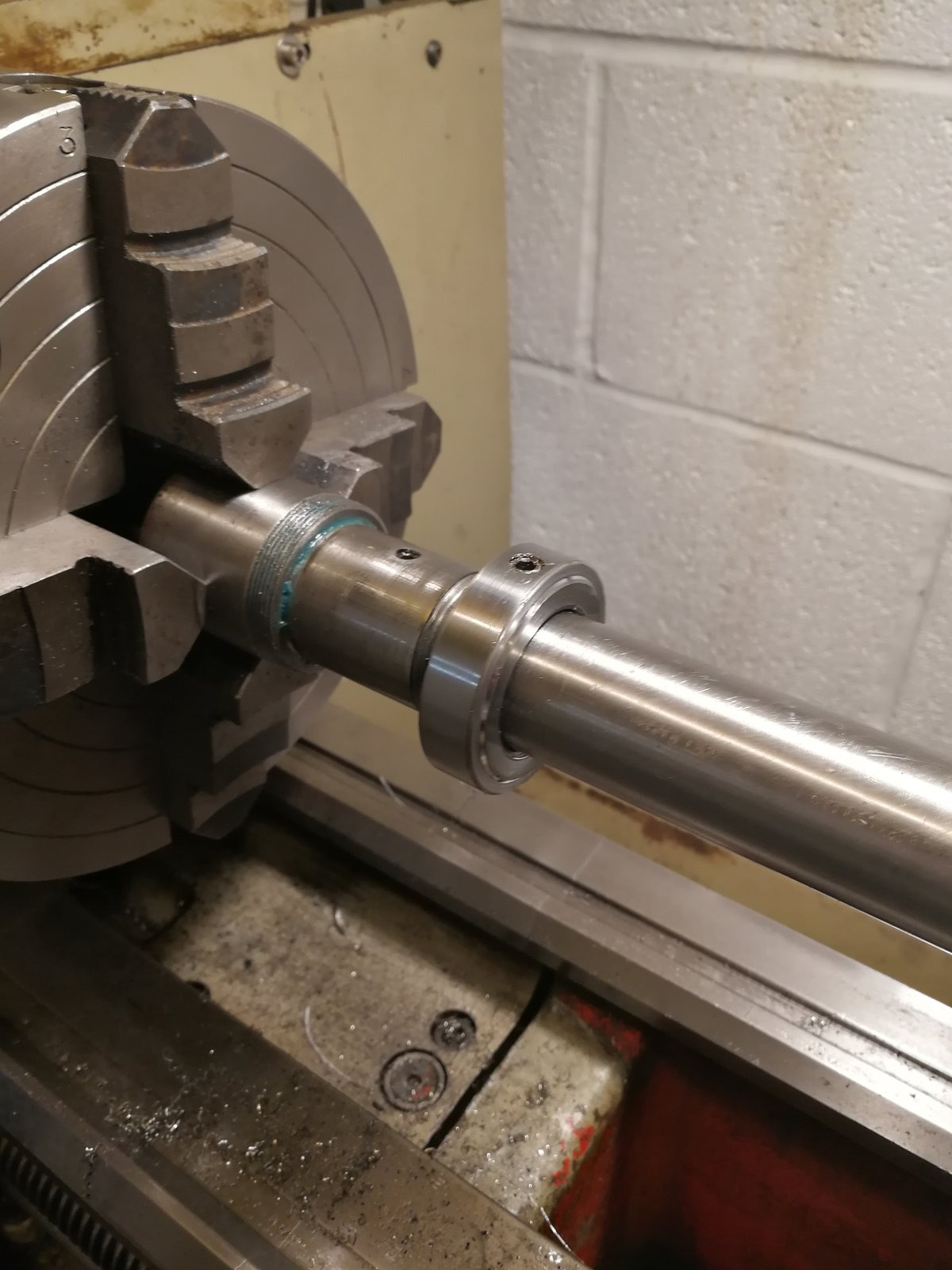

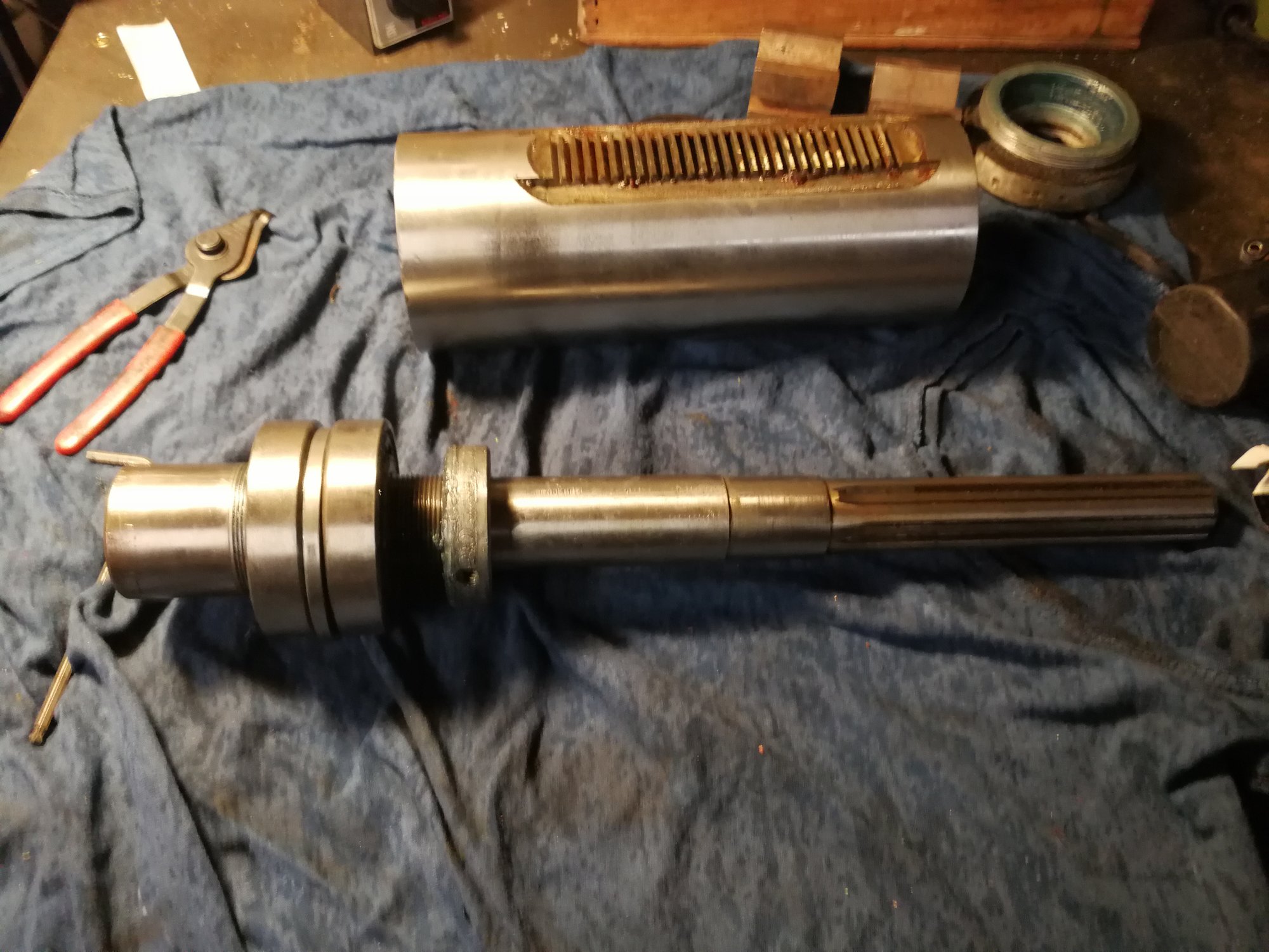

So it's now time to sort it out. The play in the quill has been bugging me so made a start on it last night. Dug out a DTI and did some measurements on the quill. With an ER32 collect holder in the spindle I was getting about 10 thou of lateral movement when measured against the collect holder. If I did the same measurement against the quill I had no detectable play which pointed to a possible issue with the bearings and or spindle.

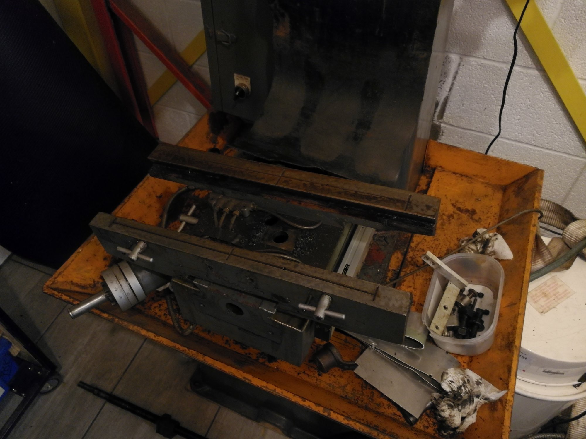

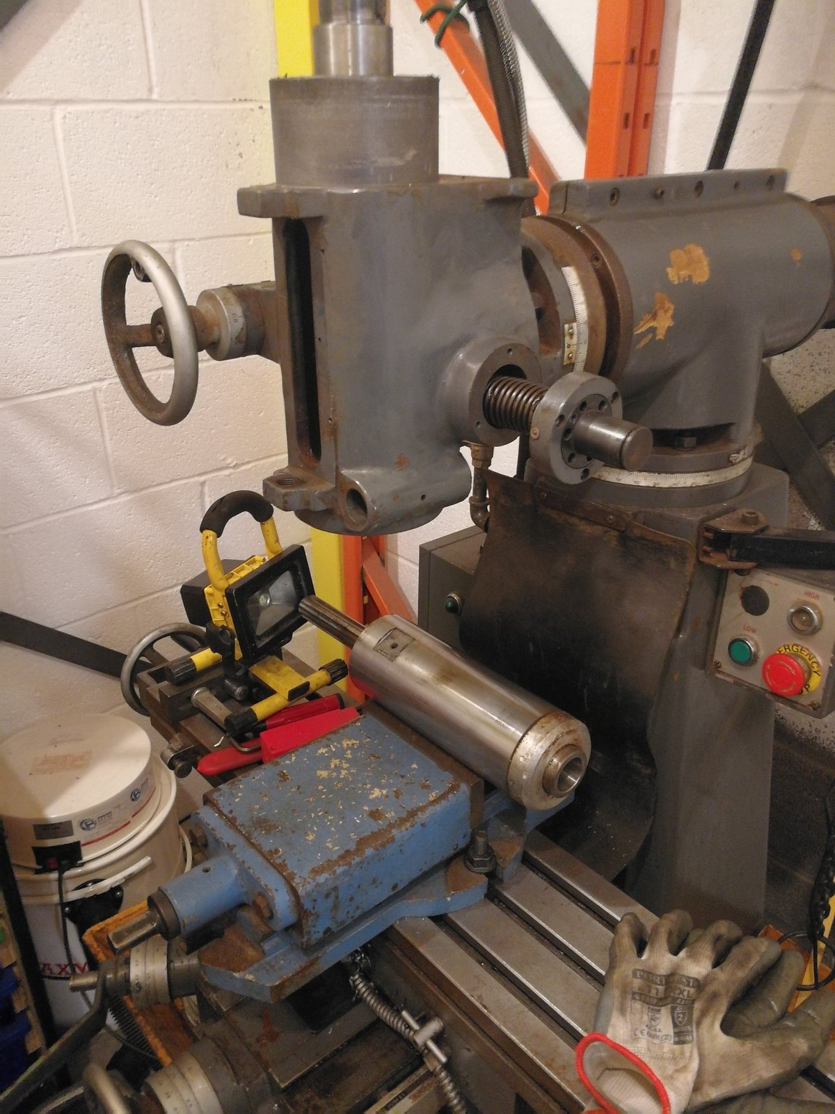

Stripped the quill out last night which turned out to be a fairly straightforward task

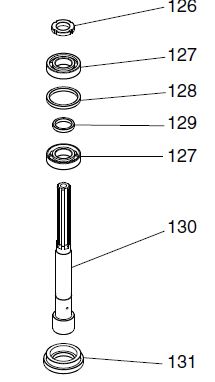

Tonight the quill got stripped, little apprehensive as the only manual I could find was for the modern version badge as Grizzly in the USA and there are some minor differences.

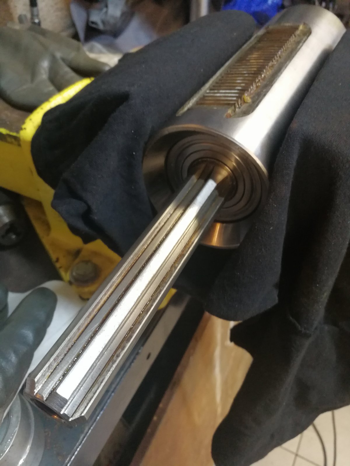

Nose on the quill is threaded where as the Grizzly diagrams do not show this but once the nose is off the spindle drifts out fairly easily

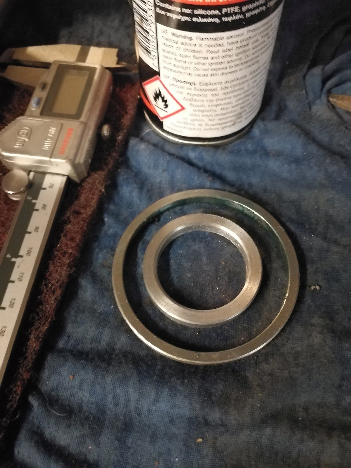

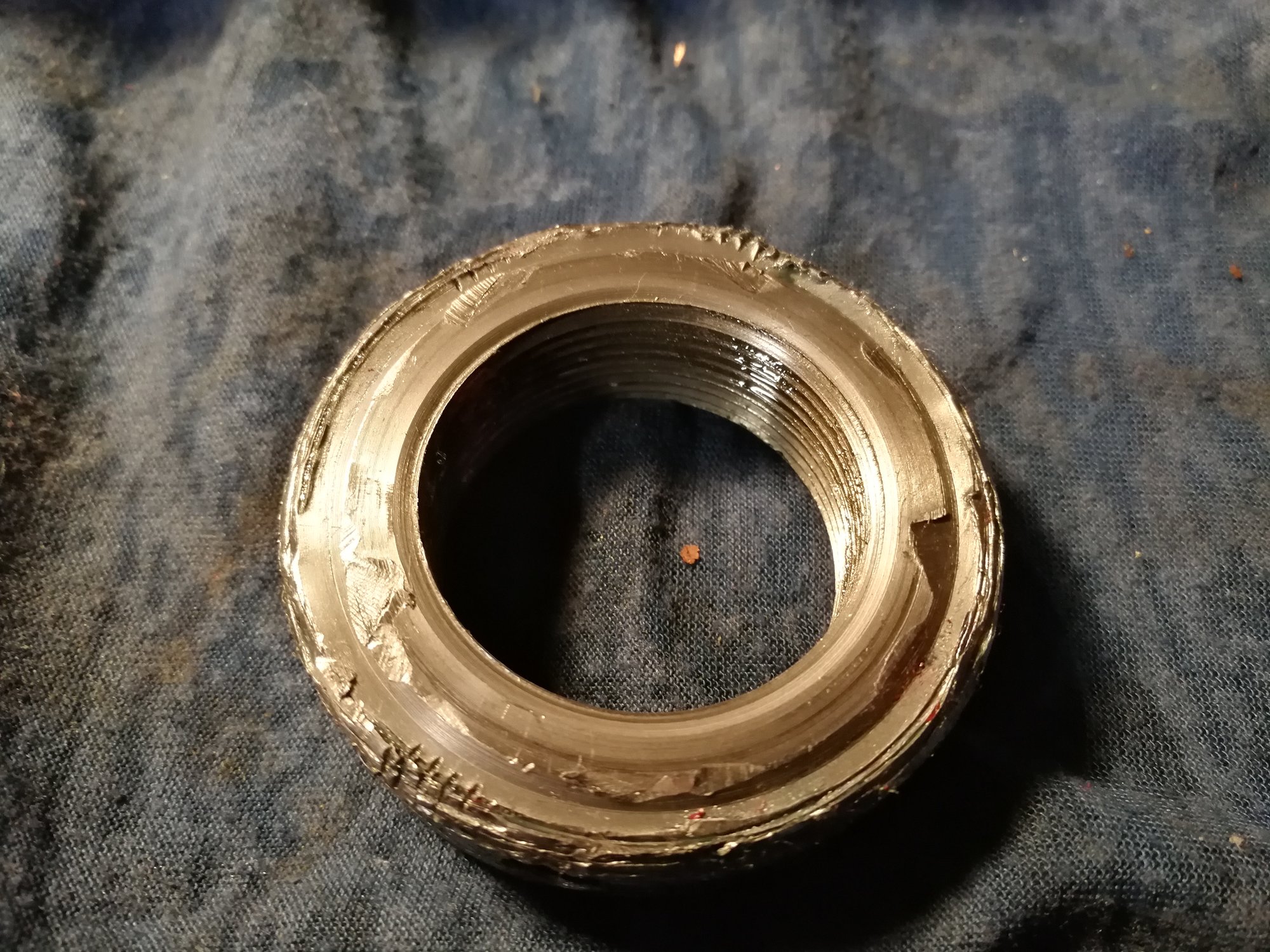

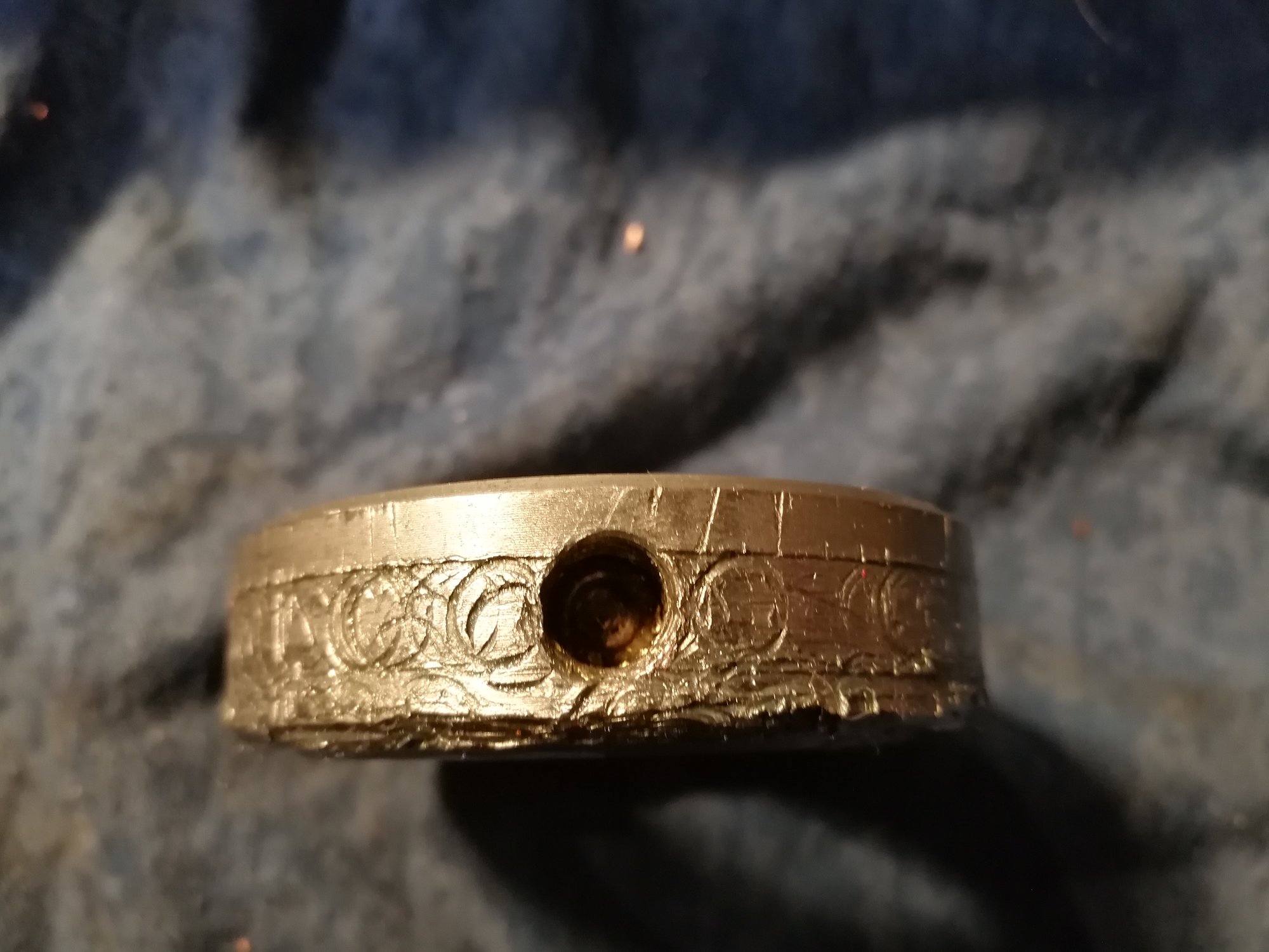

Once the shaft was out the source of the play looks like the bearings needed adjusting but someone has definitely been in there before me, photo was taken after I started undoing the locking ring
