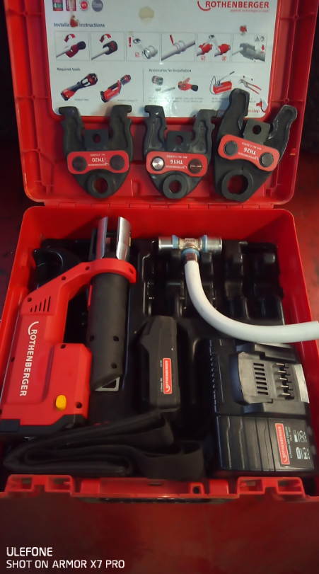

I wouldn't call it flimsy, I piped an 11 bedroom care home with one, only switching to the full size for the 42mm gas pipe
I don't like the Milwaukee, only reason to buy that is if you have a load of batteries
It needs a bit of planning to crimp everything, but no more than screwed steel, work from a fitting so you don't need to put an elbow on last
