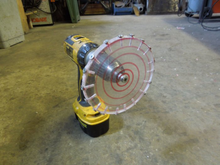

I have spent a hideous amount of hours over the years chipping dross off the back of plasma cuts, a deadly job on larger pieces of work.
Then on here I saw a mention of a drill powered device for shipping paint and underseal off. looks like a potential dross remover. But I was too tight to spend twenty quid finding out.
but today I was at a loose end.
![Dross Basher 002.jpg Dross Basher 002.jpg](https://www.mig-welding.co.uk/forum/data/attachments/30/30021-f7ec847983bf4dfd21fbbd1656833e74.jpg)
Cut a 150mm diameter disc out of perspex, drilled it out for a bolt through the middle and put small woodscrews around the edge. Looks cool.

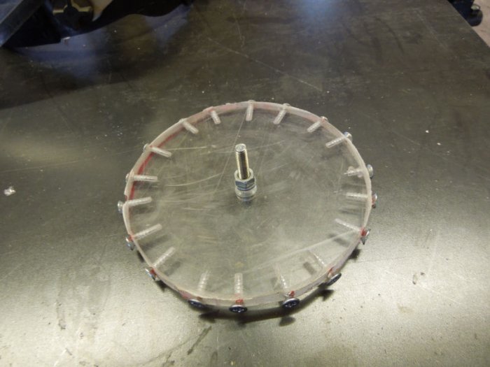

The first one shattered after a few minutes, my fault as I was working towards an edge not swiping away from it.
I made MkII
![Dross Basher 004.jpg Dross Basher 004.jpg](https://www.mig-welding.co.uk/forum/data/attachments/30/30022-09e794f431397413e9e775b5b68dd4e3.jpg)
Success, just dont snag any edges. A bit noisy but pretty effective.
Also quite good on rust.
When it dies I will stump up for the commercial version.
or can somebody supply me with a disc of aluminium 150mm x10?
That would work a treat with self tappers.
