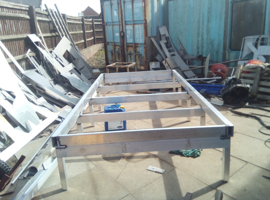

This is as far as I got today.
How fast this will progress I am not sure, it will depend on my other work.
