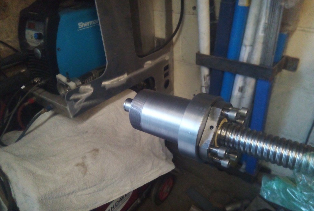

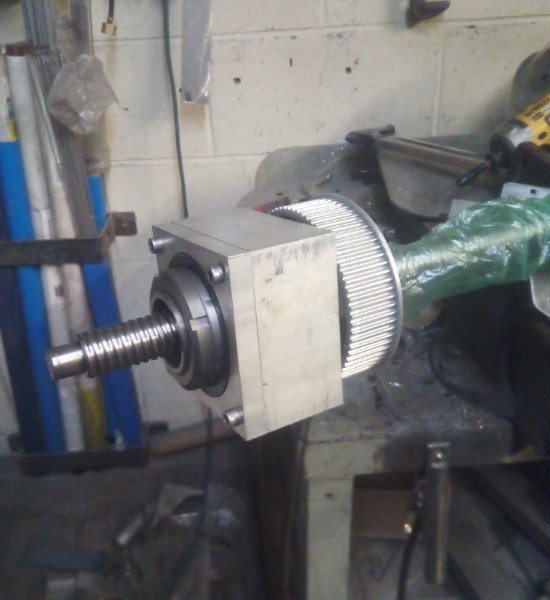

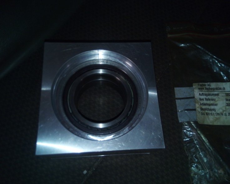

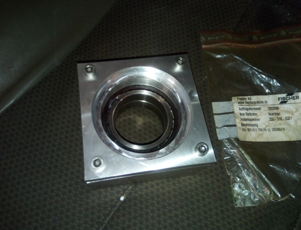

The ballscrew arrived yesterday, still waiting on seals and locking nut. I could have made a locking nut easily enough but they are so cheap it isn't worth me doing it especially as I am already paying postage on the seals.

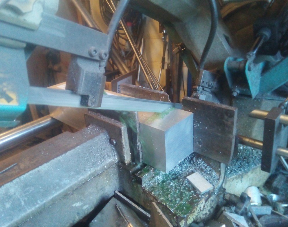

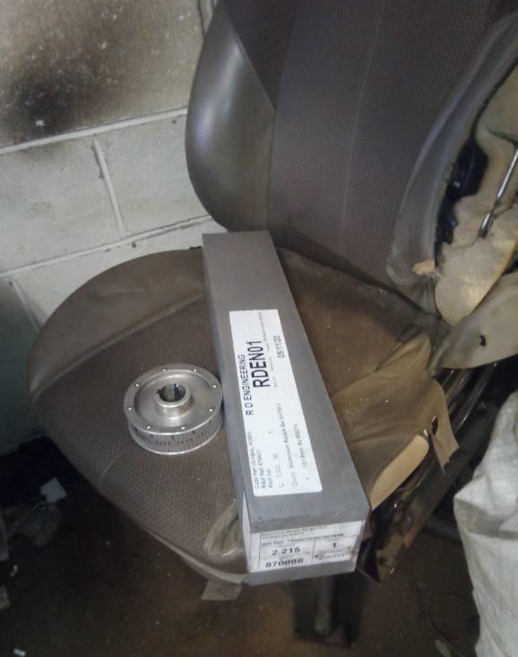

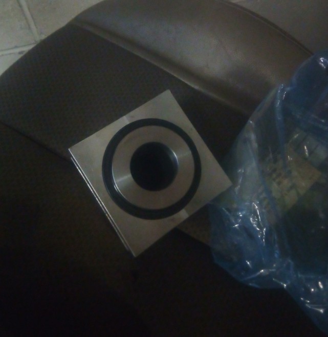

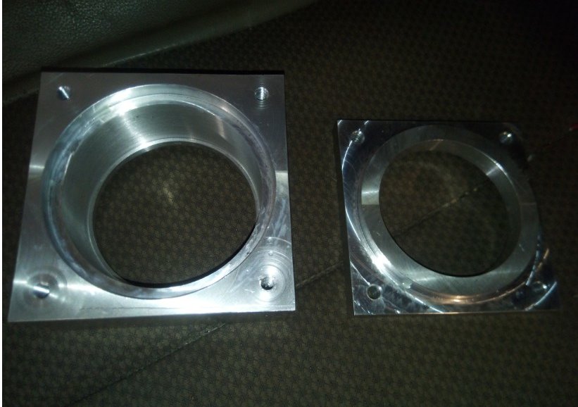

I ordered a 500mm long length of 4" square Aluminium instead of the flat bar. It should be here today but not sure if I will get a chance to make a start on it.

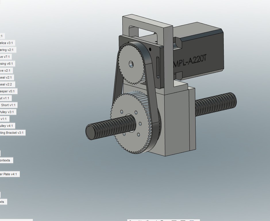

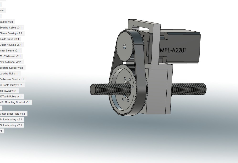

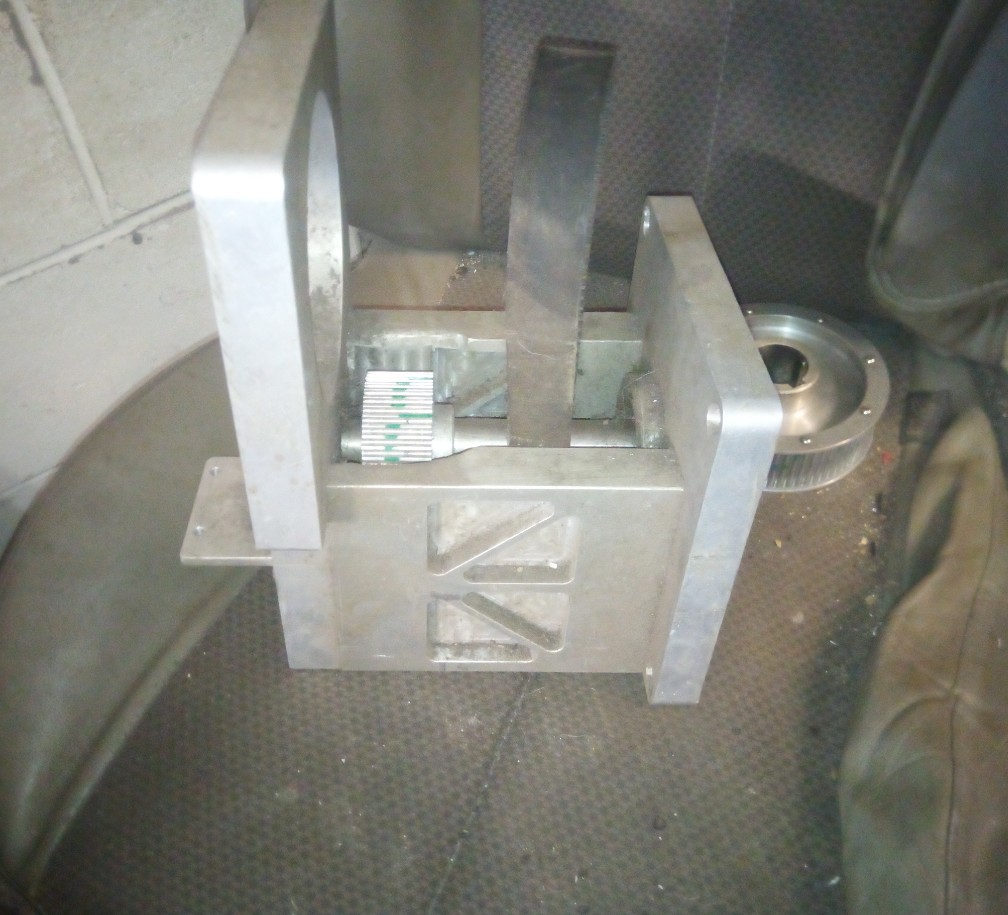

Have the design more or less finalised, it should make for a nice compact unit.

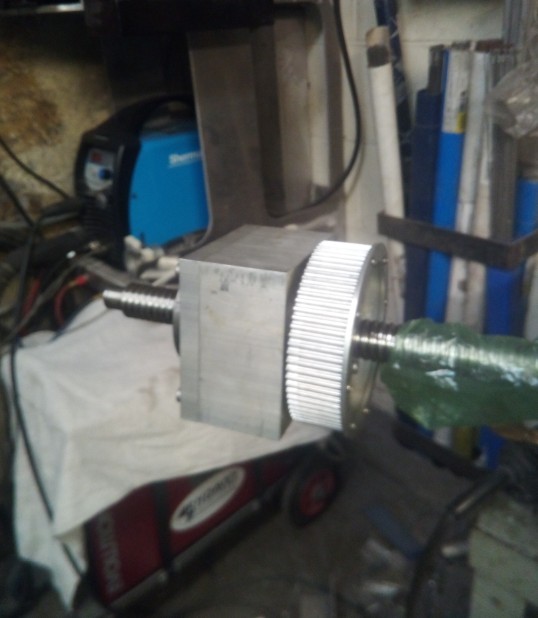

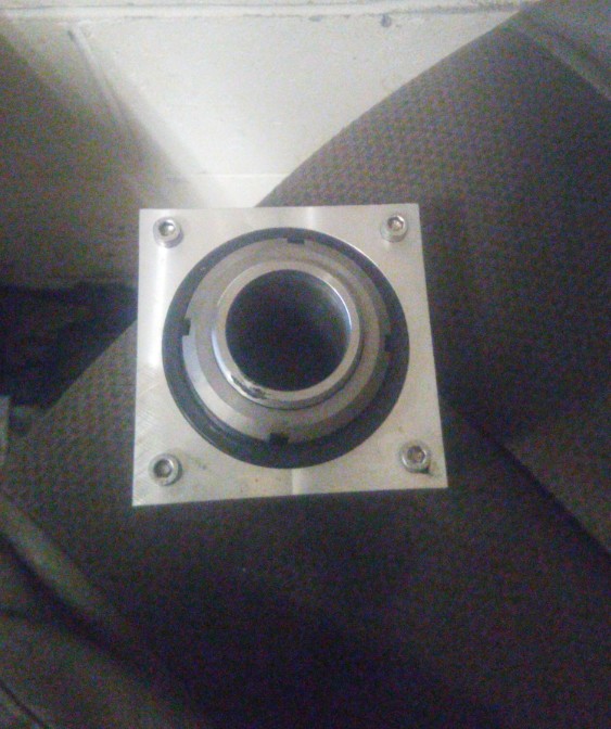

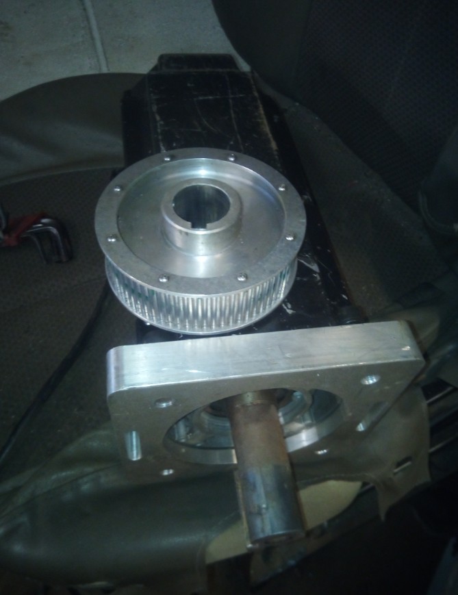

Yes that was my worry about having the screw rotating. It is 25mm dia and about 1800mm long and will be doing 4000rpm at rapids so I thought the screw under tension and the nut rotating would be better, hopefully it willThat looks good and i like your solution.
At work we finished a machine with a 1500mm long ballscrew (the very very expensive type) and during fast moves we get some vibrations with harmonics, had to lower the Kp value in the driver and the acceleration timing as well, but the motor turns the ballcrew not the nut. Even though everything is perfectly aligned and the ballscrew has preloaded + matched bearings it keeps making some nasty noise.
good morning @Hood, why not a rack for that axis. Both my X and Y axis are rack, the only thing that I may have done different (but I already had the parts) would have gone to a helical rack. Both quieter and stronger, down side cost![]()

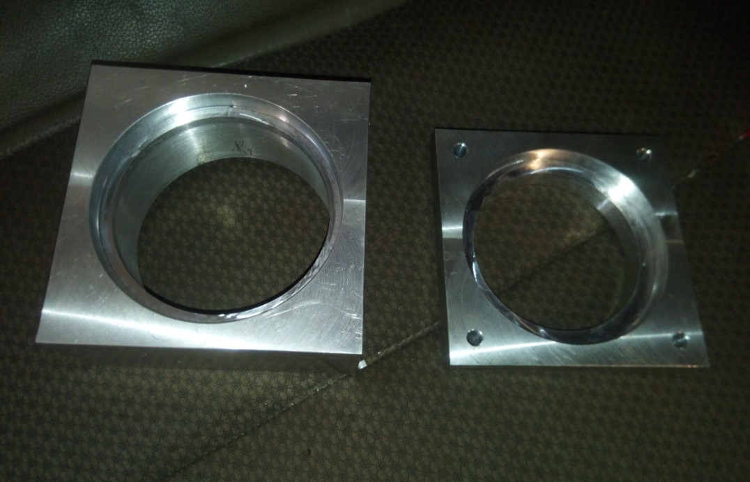

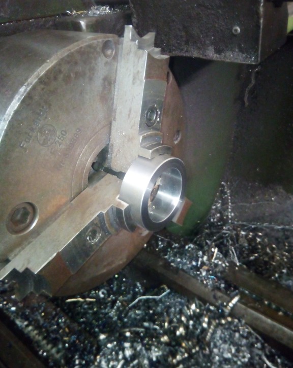

Then got the spacer made up.
I think I did, I have made lots of soft jaws up for different chucks but can't be 100% sure if I made these particular ones or not.Did you make those chuck jaws yourself?
