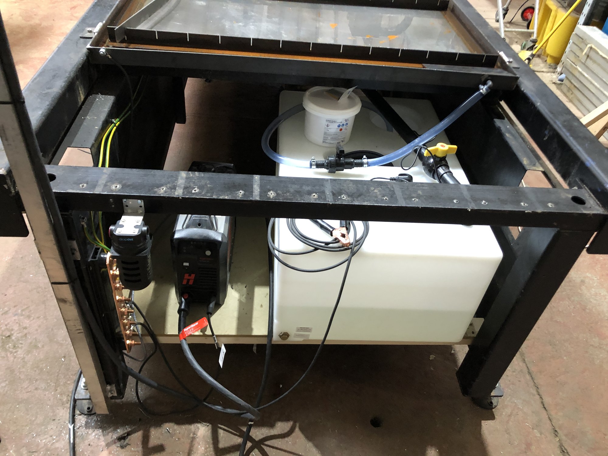

Aye, saw the stuff on R-Tech and thought not bad at £20 then saw it only treated 20l, if I build my new table it will be over 200lUsing the Swift cut additives. Arm and a leg to buy. Still rusts.
Adjustable water height? Just fill it up to 10mm below the top of the slats
Parts the come off the table don’t rust if you’ve used a rust inhibitor.I've been looking at doing this to mine. Still not really decided. I saw a guy on YouTube who has the water in a reservoir which he pressurises to fill the table, then it will gravity drain back in.
all i can find out is that it's harder on consumables and it makes stuff rust
I'm kind of leaning towards a down draft. Dunno yet though
I have had downdraught on mine since I built it 3 or so years ago and it works well so not really sure which way to go. I was thinking water though as the tray on this build (if I do it) will be Aluminium so reckoned water would likely be best.I've been looking at doing this to mine. Still not really decided. I saw a guy on YouTube who has the water in a reservoir which he pressurises to fill the table, then it will gravity drain back in.
Cheers. Not sure which way to go. I assume the cooling is the main advantage?Parts the come off the table don’t rust if you’ve used a rust inhibitor.
I've been looking at doing this to mine. Still not really decided. I saw a guy on YouTube who has the water in a reservoir which he pressurises to fill the table, then it will gravity drain back in.....
Mine tend not to rust anywayParts the come off the table don’t rust if you’ve used a rust inhibitor.
Saw mention of Borax and Sodium Nitrite.I’ve gone with Borax powder, get it above ph9 to stop rush and festering.
You using air or do you have a pump?
I had thought of that but wasn't sure how it would react to the arc, good to know it is ok.I use synthetic soluble oil (white water)
When i clean the tank all the drop through bits are still nice and clean
Are you using the xtreme tray or did you build your own?I use synthetic soluble oil (white water)
