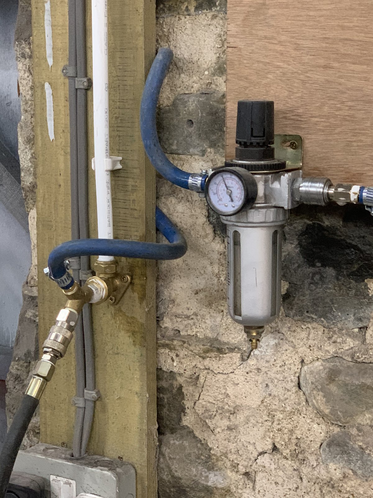

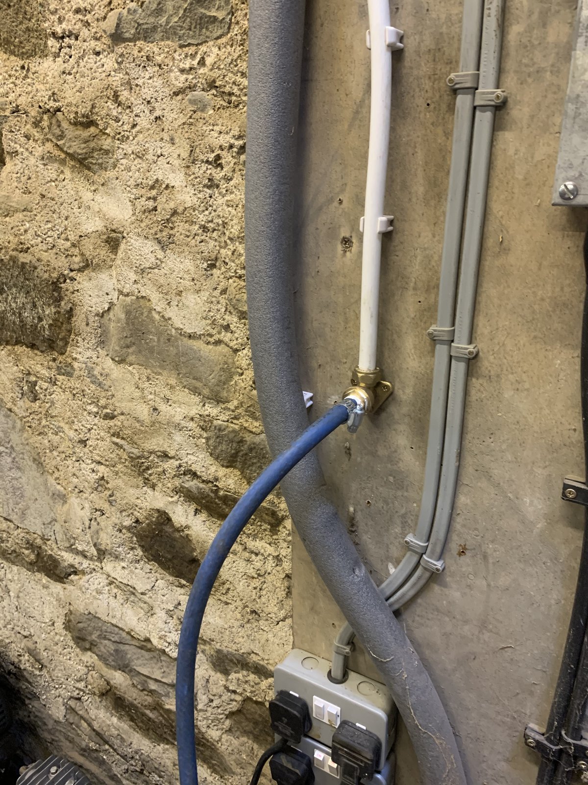

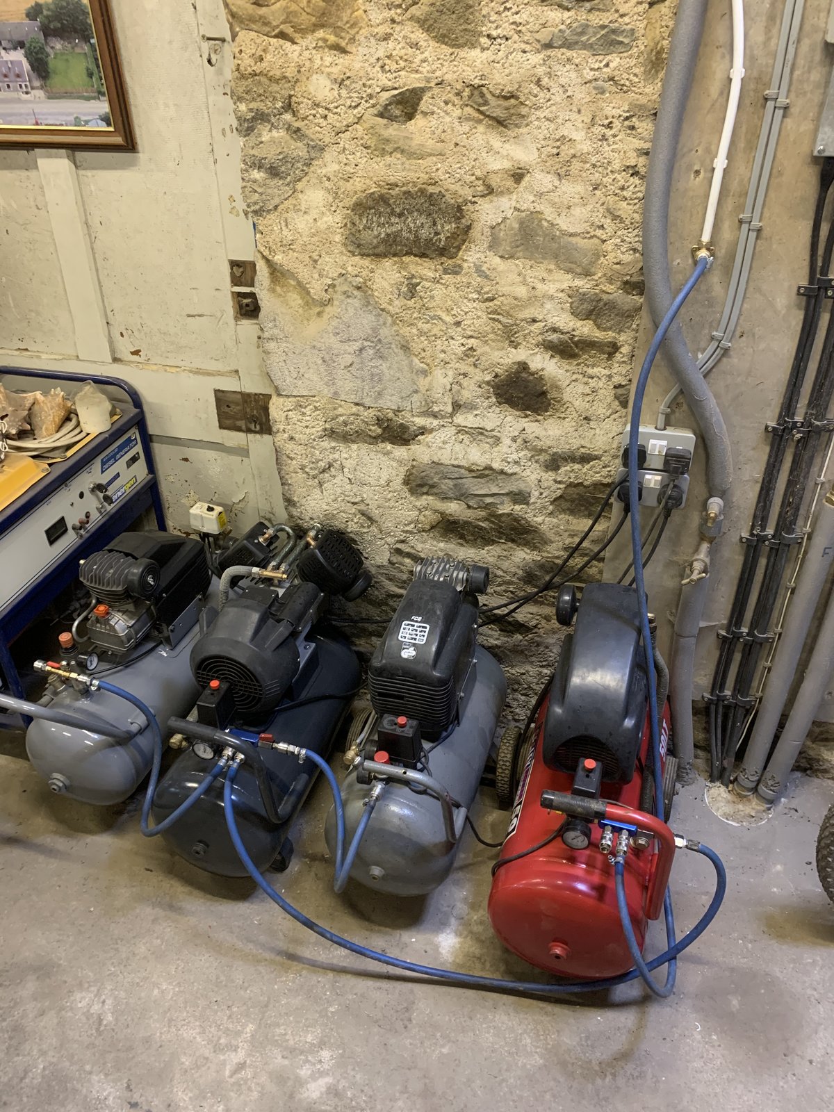

Ive been using the white HEP pipe for 4 years now at 150psi no issues at all , only precaution I have taken is to cover all runs in flexible 20mm black trunking protects it from sunlight and any hot sparks knocks etc. I think the fittings are where the most risk of failure is. If its marked max 10 bar i bet it tested to 1.5x at least
