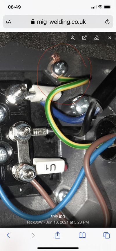

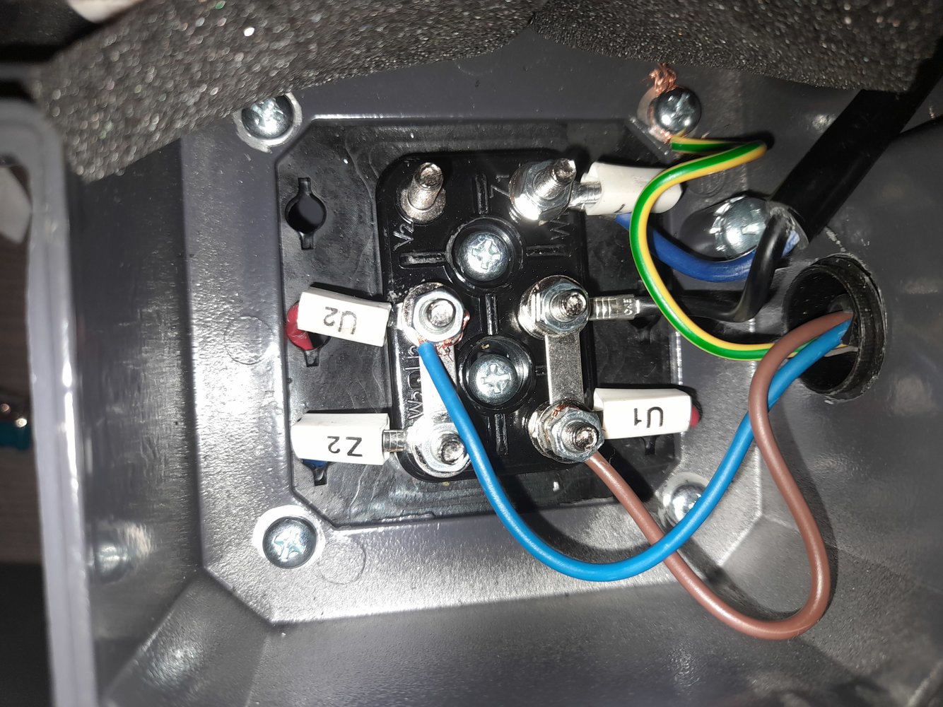

And twist it clockwise. The screw pulls it in rather than spits it out then.If you've not got a suitable crimp then expose enough of the wire to twist a proper loop around the screw.
I agree with the earth, but the brown is correct according to the wiring diagram…No, the earth should be connected to the larger screw next to where it is.
The brown should be connected to Z1.
The way it is connected in this picture it will spin, but may not perform correctly and may lead to early failure of the motor or start capacitor.
I think it wouldn’t work if you connected it to z1 as you’d be bypassing some windings…
