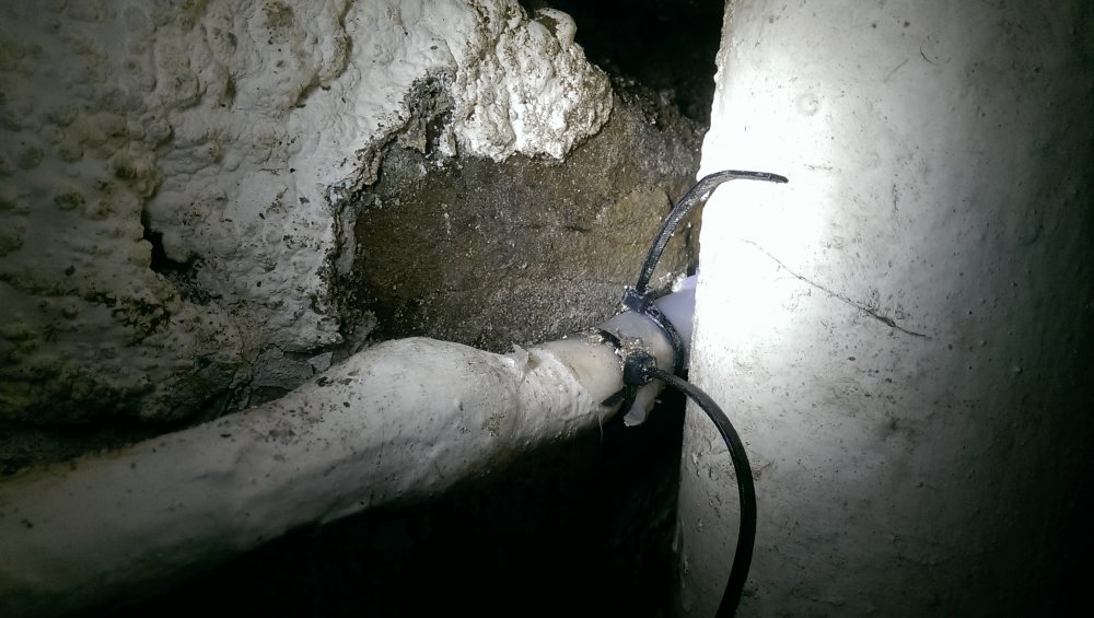

I will pop in tomorrow to two plumber suppliers and see what they have in stock.
Long term it has to be remove the pipe and replace it.
the wiring is of a similar quality. But lovely house, loads of space and in a nice spot and soo cheap.
. You may be able to bodge it with lead free but it is as runny as tap water, we had to use lead lock's to connect onto lead they are like a large compression fitting with a grab ring and an O ring inside.
