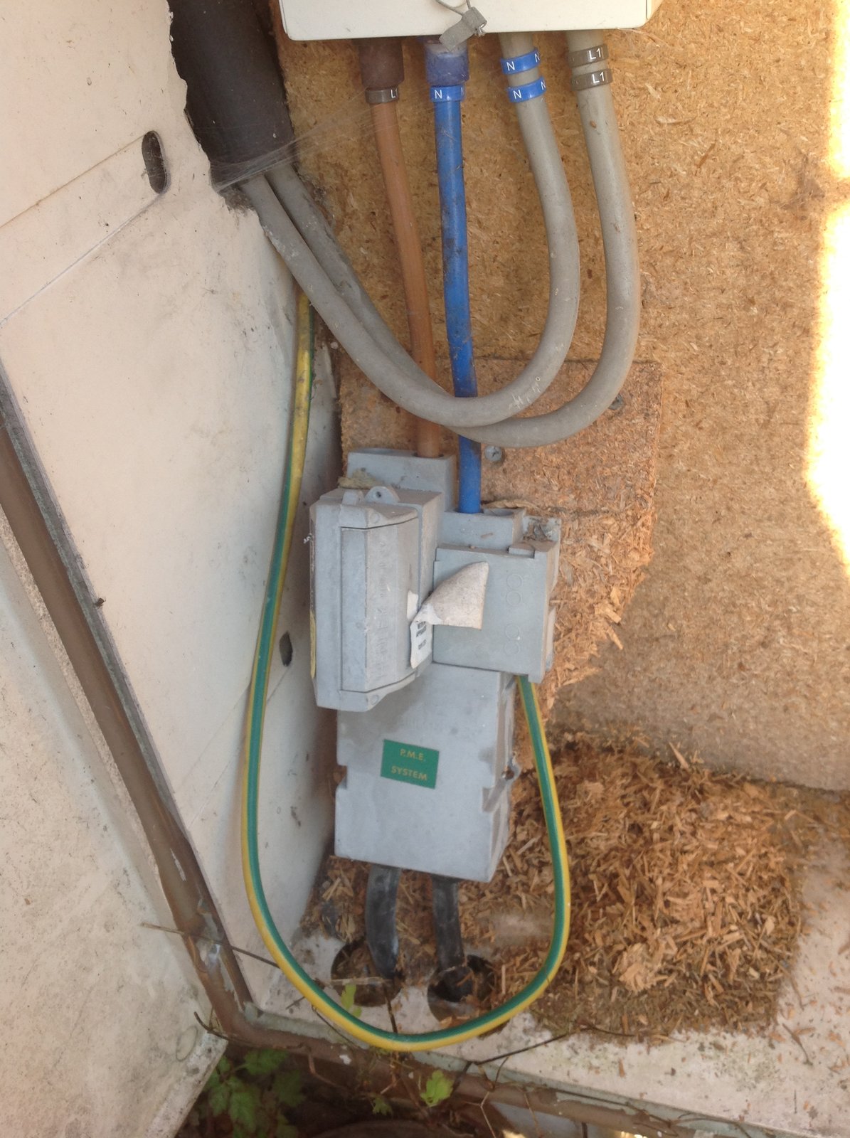

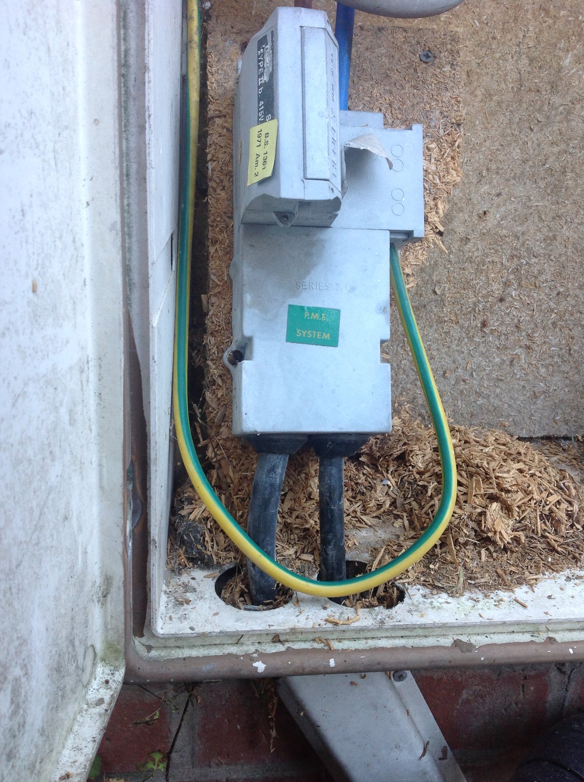

I would be very surprised if this is a separate L & N, would probably be a Feed-in and Loop out to the next customer.
Has something been moved? I cant see how that head was ever fitted to the original backboard.
@WorkshopChris the crumbly chip boardbacking board is like that because I used to leave the door open to read the meter ,
Gonna up grade with a bit of OSB![]()
Don't panic !Not removing the back board just the small angled piece that the fuse block is connected too !
I can second that advise that head unit should not be moved or subjected to any movement.Be careful otherside of that fuse will 1000a +
If this is DNO equipment and not part of a privet landlords distribution network, the upstream disconnection current could be huge.
I have seen a poorly terminated split concentric cable clear its own fault and that was on a 100a supply the thing just kept arcing until it burnt its self clear.
