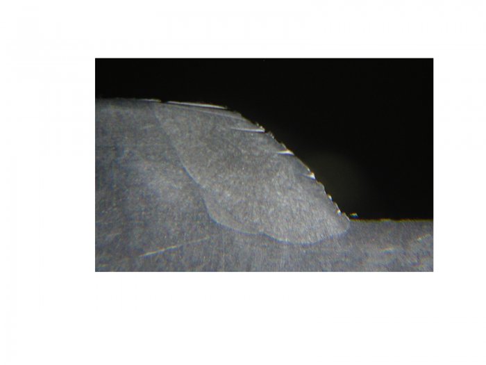

I had a similar problem.........
Is your fit up good ? Grind both plates to remove the scale and make sure there's no gap at the corner of the join (the pieces we use were guillotined and uneven - this can act as a slag trap)
Have you done a Macro etch to see if you're penetrating into the plate ?
The weld profile looks a bit convex - might be moving too slowly or juice not high enough ? Mine got better with a flatter profile.
I'd be tempted to up the amps and try and move a bit faster. Or try a 3.2mm rod which obviously allows more current and keep the speed of travel up. Have you tried a run electrode negative to get more heat into the joint ?
Good luck- practice and time will sort it out !

I'm glad you mentioned welding electrode negative, because I have asked my tutor about that. The theory says that more heat goes into the job on electrode neg than electrode pos, yet most DC welding seems to be done electrode pos (DCRP) even when the rod will weld on either DC pos or neg. I can perhaps understand using DCRP for sheet metal but I don't understand why DCEN isn't the preferred choice where good penetration is essential. Maybe I'll swap the connections and see give it a go and perhaps do a simple trial to see how penetration changes with polarity in practice.
Thanks also for your words of encouragement. I intend to report back with results.

DC+ gives the best pen because the energy is directed through the arc
heat going into the job is NOT what you want
Thing is if lecturer and rest of the class can weld using the same parameters it has to be technique,,,,why is lecturer not telling you whats wrong?,surely thats what you are paying him for......make him demonstrate![]()
Have you tried the xmas tree method start in the join angled upward and go up about three to five mm up gently and then gently down to the left about half what you went up, or so it goes on top of your last across run (once you get it going)then across to the left slightly quicker and then back up into the centre of the join same as before. now where youve gone side to side thats ok but use the xmas tree with a few more amps ( it does not need to be pretty at first) you may have a bit of bulk in the middle and undercut on the sides this means your heat is good enough to too high. Don't go more than say 5mm either side of centre and count to yourself as you go up say 1 hold there 2,3 then down to the left is 1 then hold it 2,3across to the left is 1 thenhold it 2,3 and so on keep stick centred and angle it slightly to make the left and right movements keep angled upward with a 2-3mm arc, then after cleaning it, with the same angles change the heat setting to suit (usually down 5 or so amps) and do your side to side over the top from between your undercut and the job on the right to the same spot on the left and so on count also one side hold it 1,2,3. move 1 hold it other side 1,2,3. and so on
if you are going to fast to count then you are usually going too hot. not always but usually. it is alot like cooking, control your heat and get the timing
right but with the added variable of hand speed. a concept easier for us blokes to pick up. by the way your macro is great, to get a better look at what is going on in there fine sand paper it a bit more and leave it a bit longer before washing it off. best of luck with it. oh it is much easier to do over head from veiwing position that is above the stick than under it but it is always easier with practice
Thanks, yes I tried the xmas tree method and again found that I wasn't getting perfect root penetration. When we're back - in 2 days - I'm going to try a 3.2mm electrode on higher current for the root, and then, if this solves the root penetration problem, 2.5mm for the cap. Anyway, I hope to get some macro etch photos on the results and report back.
I really do value everybody's kind help.
Martin
I tried a larger electrode (3.2mm) and lots of juice but the root penetration was no better; I think the electrode diameter was too large to get into the corner. So I returned to the 2.5mm electrode at 80-85 Amps (high end of the range) and a slope angle of 90 degrees and, instead of laying the bead vertically up in a straight bead, I put in a very small 45 degree weave as I went up, just enough to catch each edge of the joint. That helped pull the profile of the weld to a flat/concave profile with no tendency of the weld pool to fall down under gravity..
