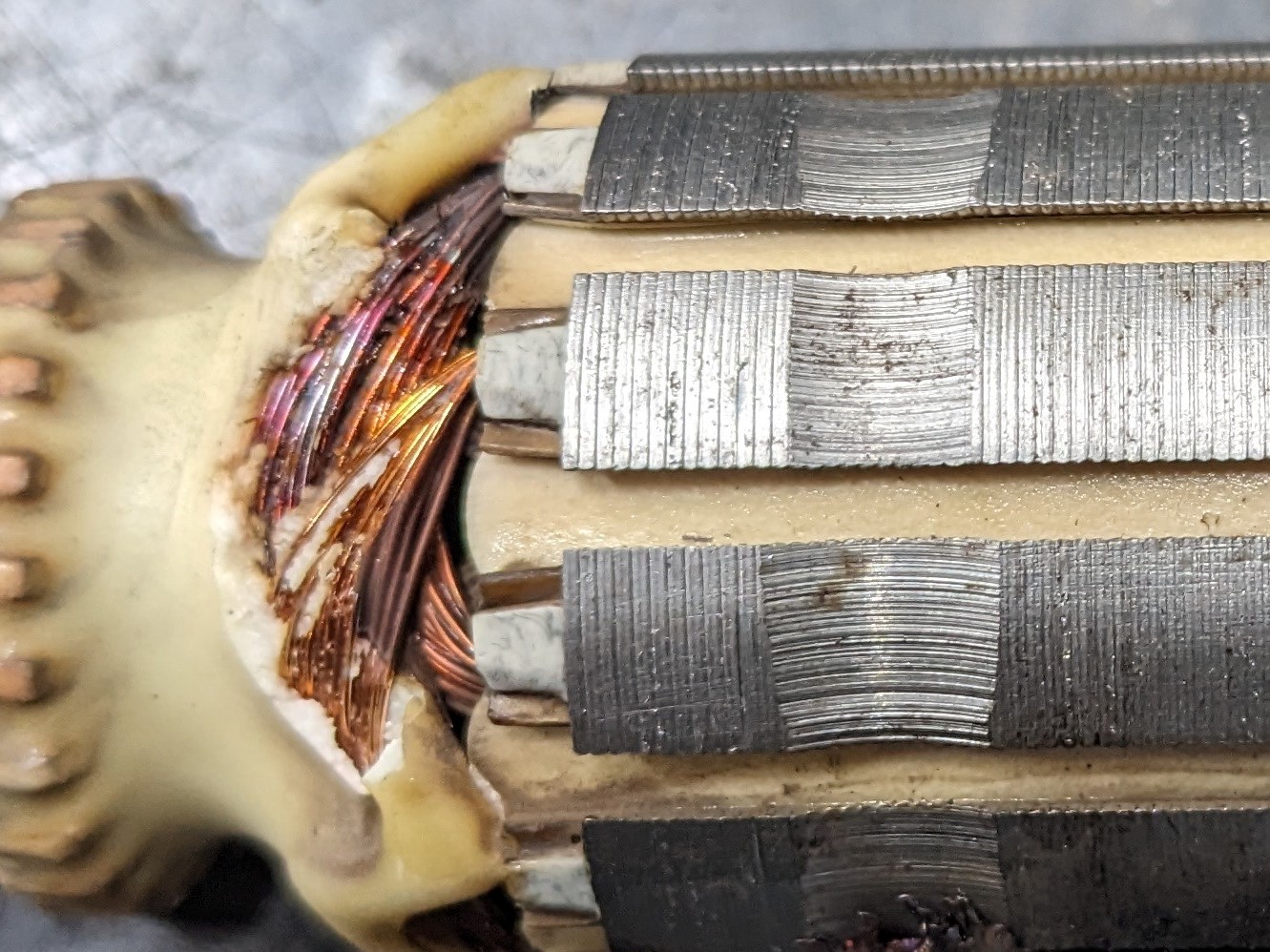

I bought a reasonable makita years back, worked nice but soon let smoke out , discusted at wasting my monies I bought cheapest on sale at ?B Q , @ £12. still using to this day , never cleaned , never will be , just renew with next cheapo , they are nt worth wasting time on .My small Makita angle grinder suddenly slowed down, got warm and emitted a few wisps of smoke before I turned it off.
I've checked the brushes and the visible part of the armature which are fine. I've blown it out with compressed air. It turns easily and smoothly by hand.
I spoke to it nicely and started it but more smoke.
Are there any useful diagnostics I can do with a basic multi meter? If I do find something is it likely to be repairable? Last time I checked replacing stator or armature was not economically viable for this small single speed model.

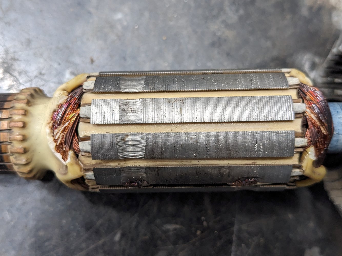

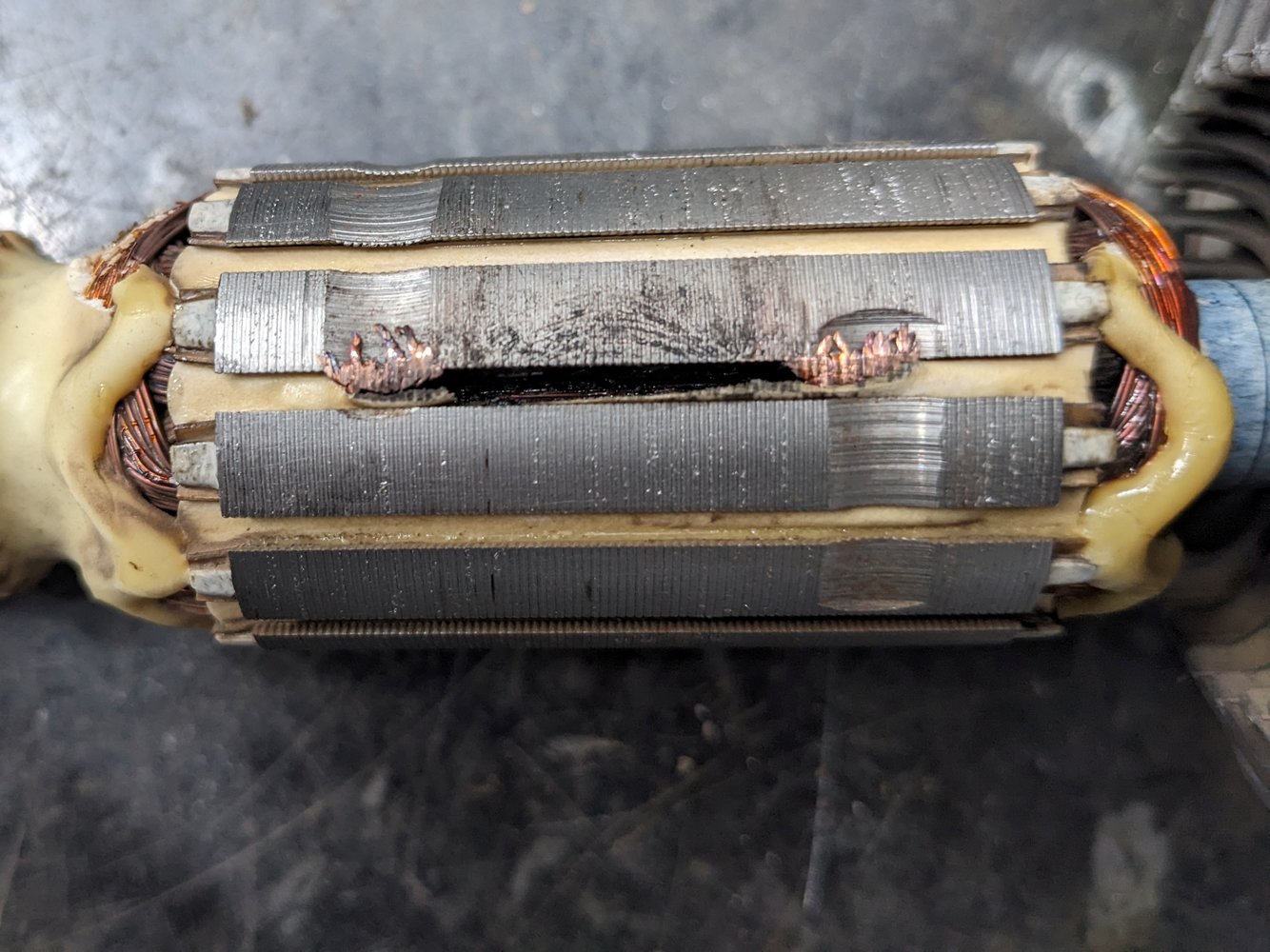

thats fubar , needs replace or rewind.Starting with the little one:
Rotor:

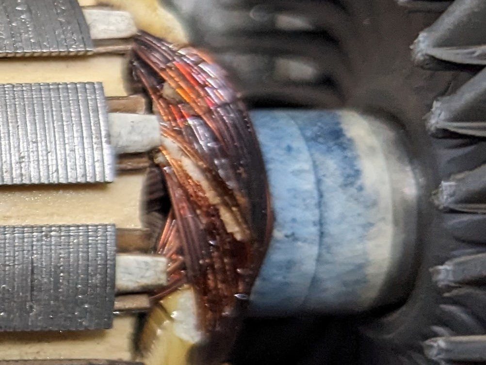

Zooming in on the suspicious lack of insulation at each end:
View attachment 478513View attachment 478514
So, oh Forum Experts - is this my problem and if so what can I do about it?

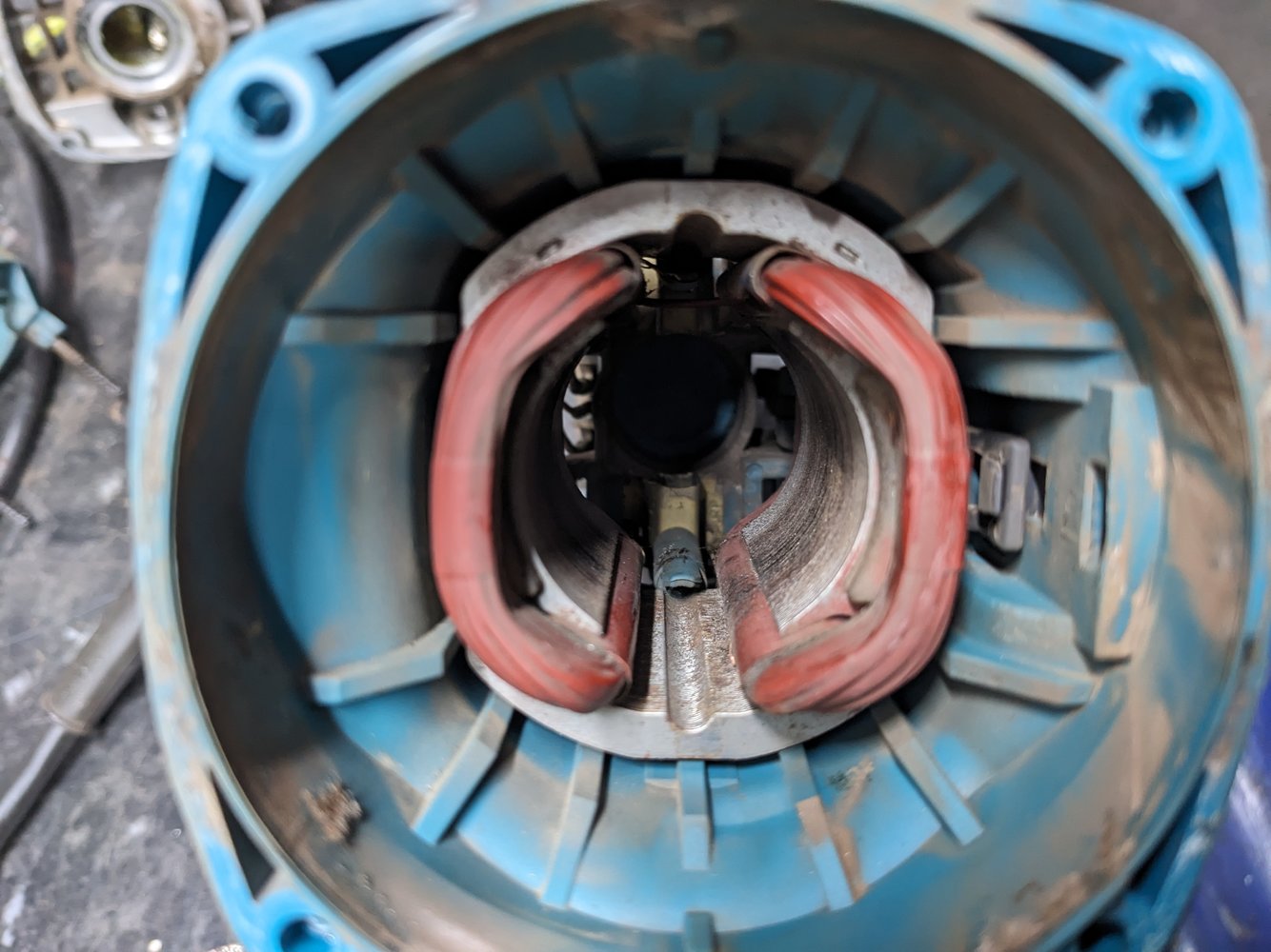

Next; is this a problem?
I don't see any witness marks on the stator, nor any issues with the wiring:
Yup, everyone agrees, which is why I've bought a replacement.thats fubar , needs replace or rewind.
