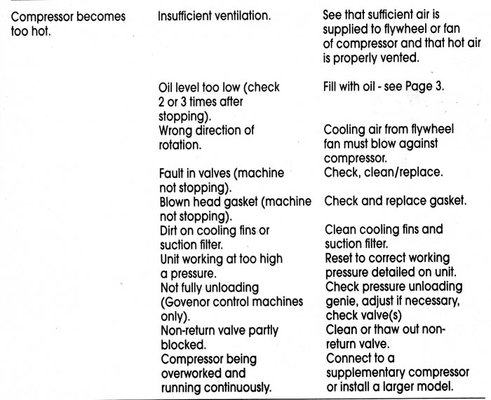

Probably best if i start right from the start with this. I have a Fiac 2.5HP 100L compressor which i brought 2nd hand, its in great shape and was told by the previous owner he overhauled the motor not long prior to me buying it.
Anyway all was well for a few months bearing in mind i dont use it everyday, once a week sometimes more, then one day i noticed it had been running a while and when i opened the garage door air was ******* out of somewhere and it wasnt holding much presure. I was told it could be the reed valves so stripped the motor down to the point where i could get the cylinder off the piston. Everything looked ok, gaskets like new and reed valves seemed to do what there meant to so ****** off that i hadnt found anything wrong put it all back together, fired it up and it worked a treat.
Went on for another few months and it may just be in my head but im sure its now taking longer to build presure but worse of all its burning oil. At first it didnt seem like much, id open the garage door and there would be a whiff of burning oil and a tiny bit of smoke, today i went in to drain it after spraying for a few hours and there was that much smoke i had to let it clear before i could get in.
I now dont wanna use it through risk of burning my garage and house down so it needs sorting, can anyone point me in the right direction as to what maybe wrong.
