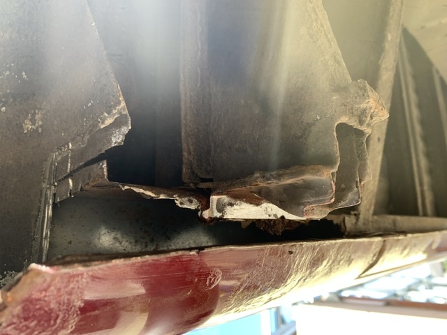

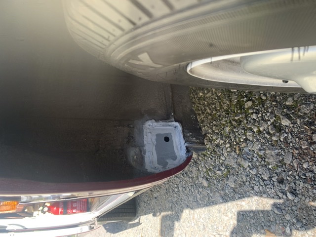

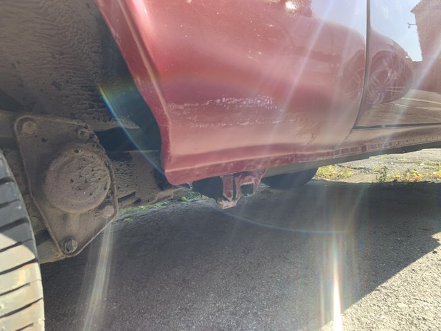

I would get stuck back into the Mini but the impending MOT on my Brazilian Bay T2 caused me to go searching for rot and I found plenty! So, amongst purchasing my new (to me) Caddy van I had to weld this and more!
