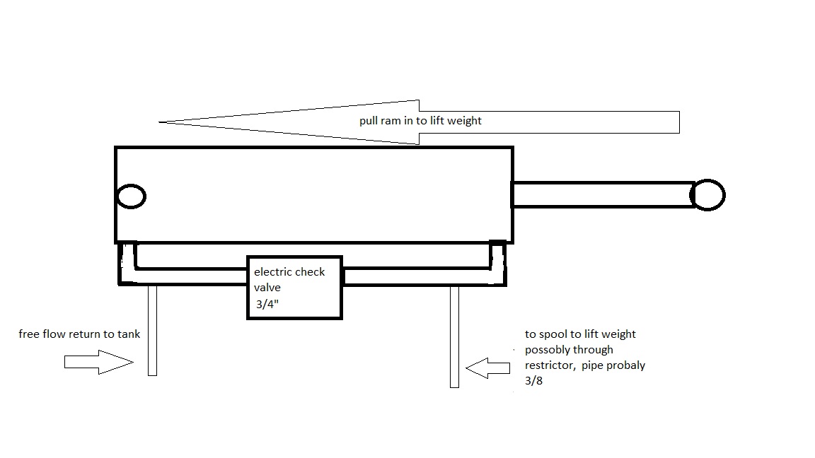

The only drawback with this idea is you can't control the force of the hit, so if on soft ground it will be difficult to control the post depth, if your just aiming for another inch or so.
You can adjust the height of the disconnect cam and therefore alter the height of the fall and therefore the force at which it hits.
