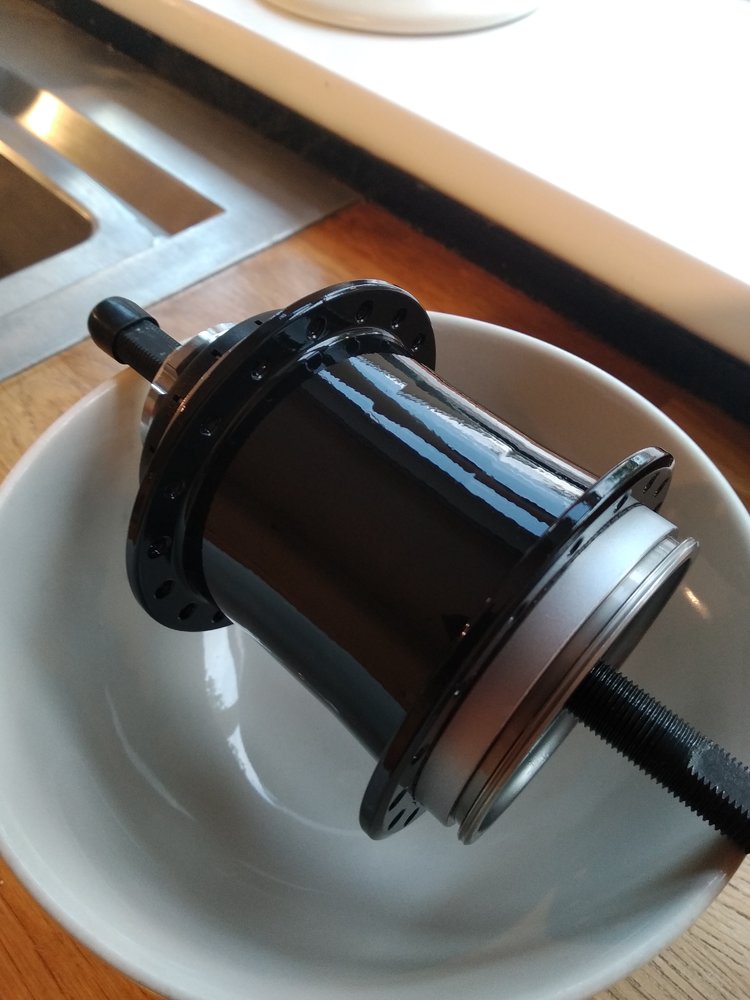

When are we going to see this lanciaIs it really aluminium?
I took the advice of a metal coating company we use for work refarding prep of some aluminium components from my Lancia - they support the rear spoiler and after 20 plus years of exposure were corroding and causing the paint to fall off. Blasted, treated and anodised (to some spec that was different to what my research had lead me to ask for) and then painted as normal by the bloke painting the car - still looking good a few years later.
