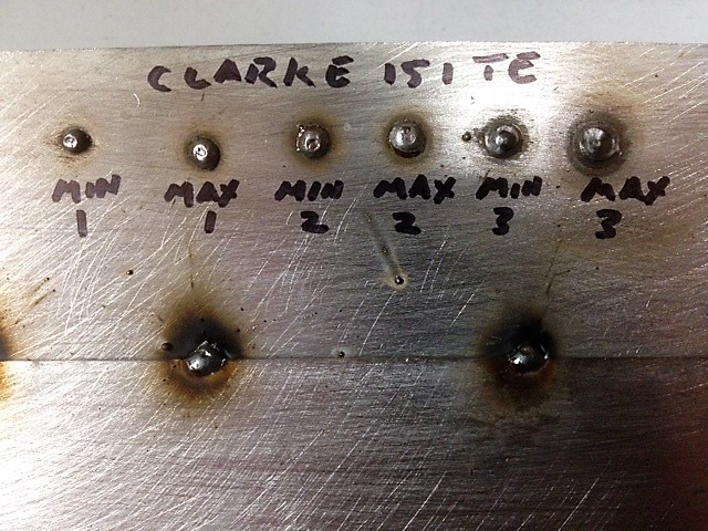

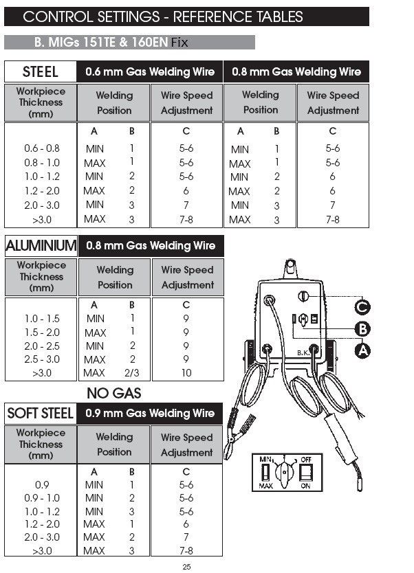

Having just picked up a second hand Clarke 150EN to learn to weld with I come across this forum and the links for the PDF's etc. I also noticed that the power settings in some manuals are wrong so I thought I would test my machine.
I do wonder though - is the voltage test alone show the real order of power as if so my setup looks rather odd.
Anyhow these we're my readings (done on a digital meter than I trust)
1 MIN - 20.0v
2 MIN - 22.6v
3 MIN - 25.8v
1 MAX - 24v
2 MAX - 27.8v
3 MAX 32.8v
It could be that different models are connected to the switches slightly differently.
With that many wires and switches, it could even be that individual m/cs of the same models are sometimes wired differently by bored or inattentive factory operatives. I'm sure they don't check this sort of thing before the m/c leaves the factory, only that it welds something when you pull the trigger.
Although I have given the figures for mine above, some of the variables, like wire speed, are very much basic settings, and often need modifying to suit the job in hand.

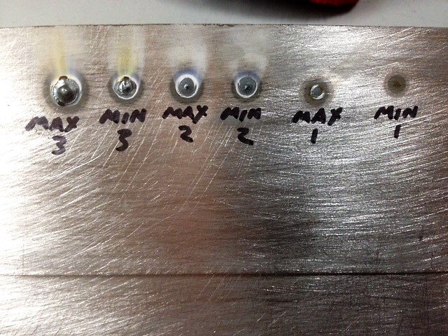

When I started out using some of the Clarke manual settings for my model, I found I was blasting through metal instead of welding. I have also found that almost any setting is more powerful when using gasless, so have made myself a separate set of figures for this, purely through observation.
Truth is, I think we need to get to know our own individual machine, and base settings on that for the best job.
