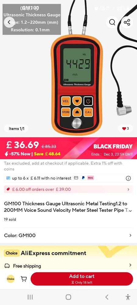

I'm not sure about that. I know paint thickness measuring tools are available, but cheap tools to measure thickness of a tank?Could you use an ultrasound thickness measurer maybe...think they can be had pretty cheap these days.
Even if it's not 100% accurate it might allow you to compare the good half with the bad to get a rough idea of how much thickness has left the building so to speak.

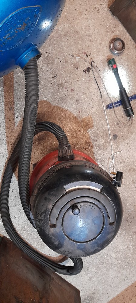

Is that a Henry vacuum? If so they're not made for wet vacuuming. The air you suck in is blown through the motor windings to cool it. Suck in some water and your motor could release the magic smoke!

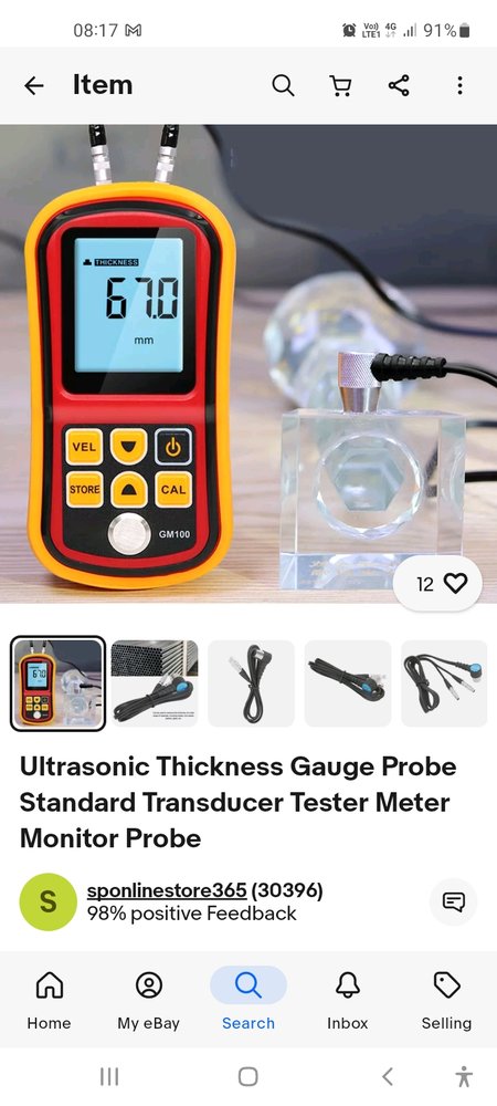

There are cheap UT machines out there, just had a look on ebay, £22 from China!! for a one off these might do the job, certainly need some material of a known thickness as a check to make sure its throwing the numbers back at you that are correct, or as near as its going to be, the issues you have are, the paint needs removed and to hit the thinnest part of a pit with a measuring probe is not the easiest thing to do, it would just be luck, the flaw detection UT machines are in different league and allows the user to scan a surface pin pointing pitting.I'm not sure about that. I know paint thickness measuring tools are available, but cheap tools to measure thickness of a tank?
Read the adverts carefully. £22 for the probe, about £60ish for the tester.There are cheap UT machines out there, just had a look on ebay, £22 from China!! for a one off these might do the job, certainly need some material of a known thickness as a check to make sure its throwing the numbers back at you that are correct, or as near as its going to be, the issues you have are, the paint needs removed and to hit the thinnest part of a pit with a measuring probe is not the easiest thing to do, it would just be luck, the flaw detection UT machines are in different league and allows the user to scan a surface pin pointing pitting.
It's Henry's bigger brother, Edward. Paid £3.00 for it about 8 years ago and still putting up with abuse.Is that a Henry vacuum? If so they're not made for wet vacuuming. The air you suck in is blown through the motor windings to cool it. Suck in some water and your motor could release the magic smoke!

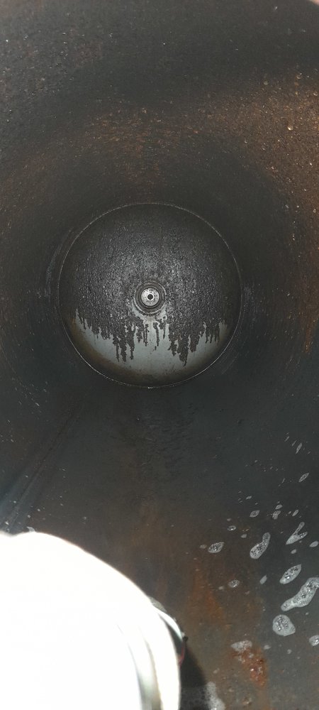

There's always the option of just using the good half by only half filling itThe tank with the rust to the top doesn't look good.

A failed tank can just be devastating to the surrounding area. Most who post about catastrophic failures have got away with their mishap. Some have been reported where the user was not so lucky.
Catastrophic failures are not common - only occur once (per tank). That once is more than enough - for every user that has experienced one - to be much more vigilant going forward.
They can be “buy cheap, buy only once”. Industrial receivers are regularly tested for good reason. Insurance being the over-arching reason for safety.
