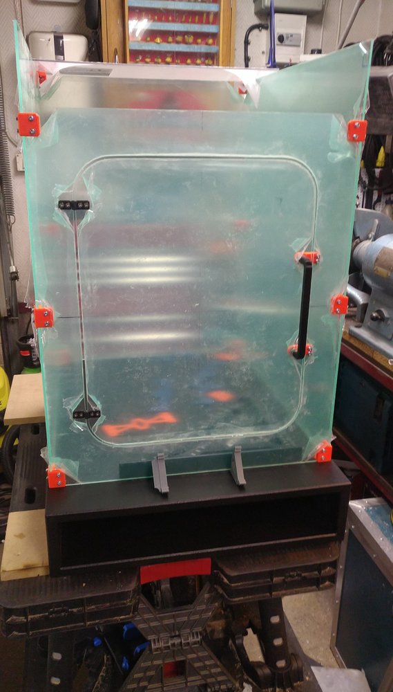

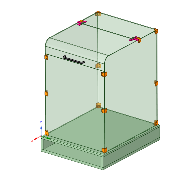

There are many reasons to have a printer in an enclosure. Sound, equalized temperature, cooling rate. Not necessary nor wanted for all occasions though.
One reason for me is to be able to run it overnight without risc of the cats getting to it
Been fabricating parts a while, printing, cutting MDF and cutting acrylic.
This is my intent and followed by the progress.
Will have a box under for storage of tools and spares.

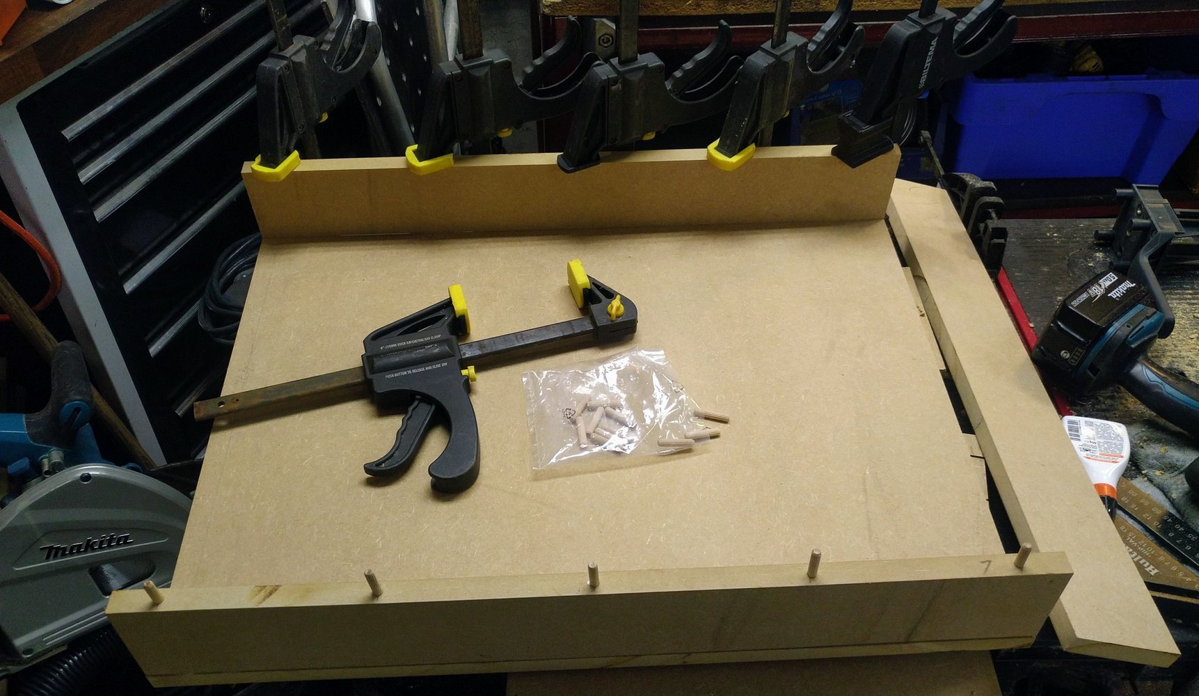

Made of MDF and just joined with pegs and glue.

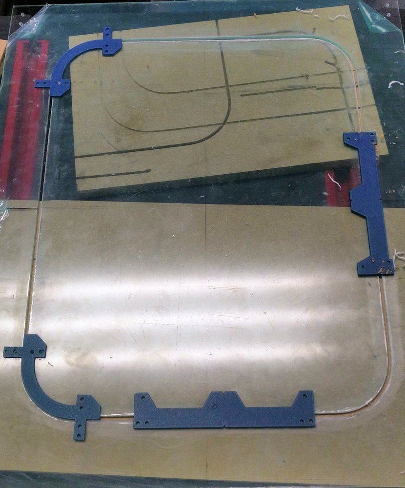

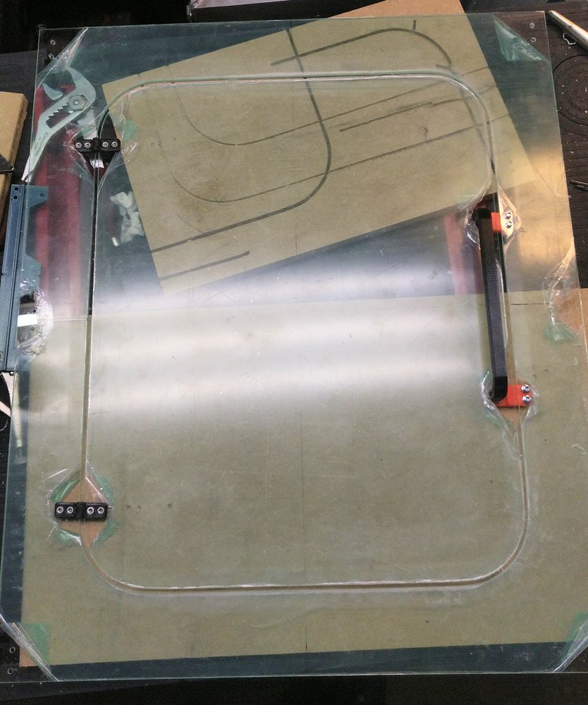

Routed out the door shape and about to drill all holes for hinges and handles.

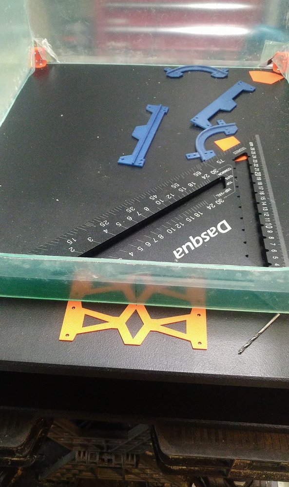

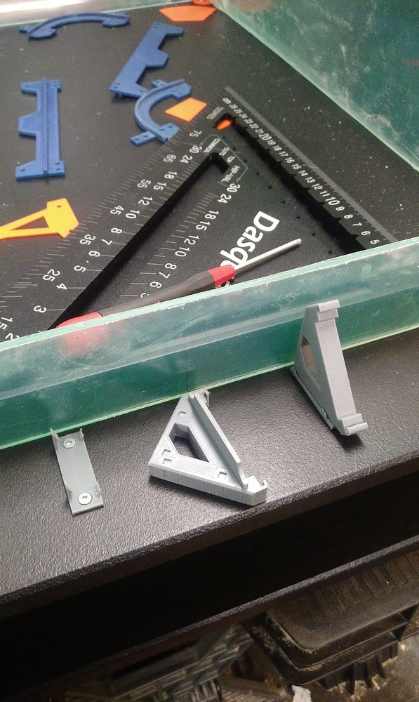

Printed drill guides that will both align gaps and make the holes come in place without lots of measuring. Measure none, drill once

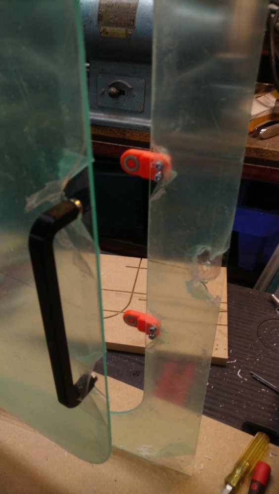

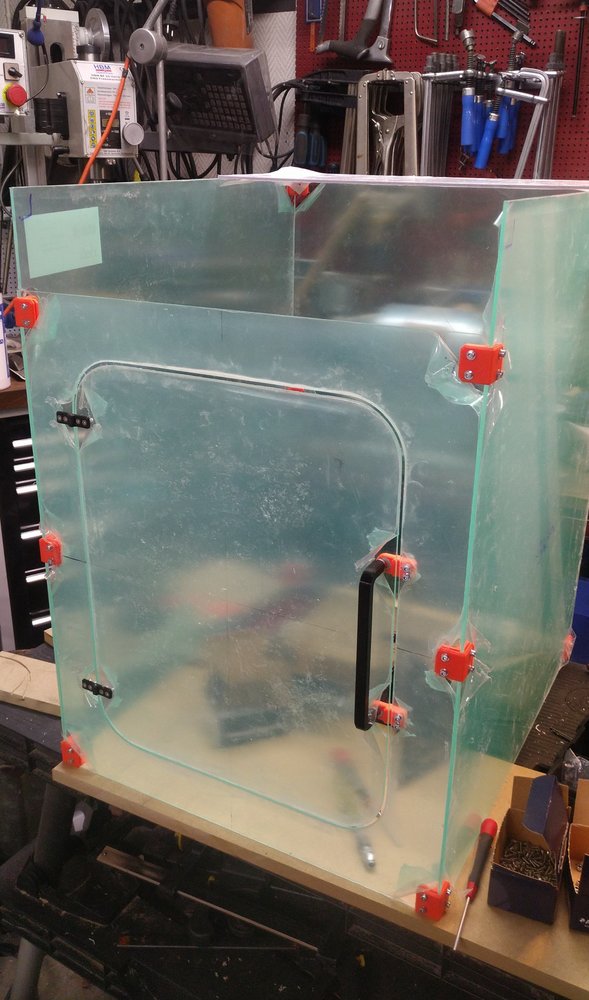

Hinges, handle and magnetic latches in place

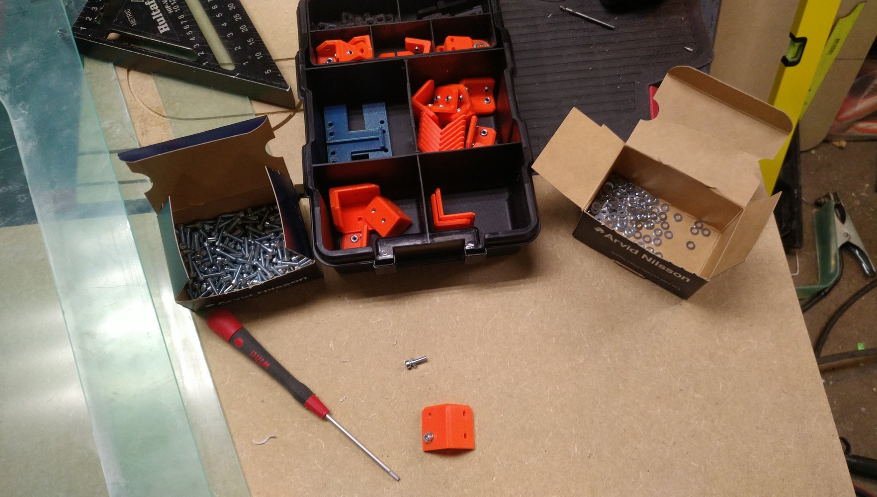

Putting all sheets together using printed parts
And this were it is right now. Struggling with the bent top lid but gonna give it another go tomorrow.
